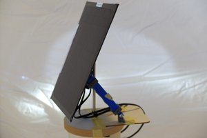

Crypto Panel
Crypto-news and cryptocurrencies configurable eInk panel without compiling or install nothing! Only your browser and an USB cable.
This cryptocurrency panel shows day and week prices and news that you are able to configure. It could be installed with a easy web installer without compiling or installing anything in your PC. You only need the eINK device and your browser (Chrome or Edge) for install and configured it. Please follow the instructions section below.
preview
Features
  • Panel installation and configuration via an easy Web installer
  • Configuration via command line (CLI) with the console of the web installer
  • Support hundreds of coins from Coingecko API
  • Random cryptocurrencies news from Cointelegrah and others news portals
  • The coin news are follow via QR code
  • Base currency USD/EUR configurable
  • Firmware update via automatic OTA updates
  • Deep sleep configurable (default: 10min).
  • Panel temperature ambient configurable (for improve colors)
  • Included optional basic 3D-Print frame
Firmware install
You able to install this firmware on only one click, without compiling nothing only using this Web installer
Full instructions here
Donations
Credits
  • 1 × eInk panel epd4.7 from LilyGO https://fr.aliexpress.com/item/1005002006058892.html
  • 1 × Battery Lipo 3.7v or 18650. Please review your model
  • 1 × USB type C
View project log
  • 1
    Buy the eInk panel
    For now only the LilyGO T5-4.7 E-Paper Ink screen is supported.
    Some stores that sell it:
  • 2
    Install
    Please enter with your browser, Chrome or Edge, to this web installer and press on the INSTALL STABLE VERSION button and follow the instructions for install the firmware. When the installation is finished enter to "LOGS AND CONSOLE" section in the web installer window, and configure your device.
    Troubleshooting:
    If this button isn't showed make sure you have the right drivers installed. The drivers for common chips used in ESP devices:
    • CP2102 drivers: Windows & Mac
    • CH342, CH343, CH9102 drivers: WindowsMac (download via blue button with
       icon)
    • CH340, CH341 drivers: WindowsMac (download via blue button with
       icon)
    • In Linux you don't need anything, it will be works with doing nothing.
    Alternative, you can upload the firmware via PlatformIO with a simple command from the project sources. More details here
  • 3
    Configure
    In the console (LOGS AND CONSOLE), please type the enter key, to enter to the console, and then type "help" to show the detailed help:
    Adding Currencies
    You are able to add three currencies, like this:
    You can find more coins or name ids, in the API provider: https://docs.coingecko.com/reference/introduction
    Base currency and others
    Please set your base currency, only supports EUR/USD, and add important settings, like setSleep for choose how many minutes refresh the information. The recommended time is 30min or more. With 1h the panel reaches more than two months without need change the battery. Also set the temperature of your house or place on the panel. This setting is important because determine the colors in the panel.
    Time zone
    With the command setTZone without parameters, it should show the current time zone. You can pass your time zone identifier, from this list. Choose the second parameter in this list and pass it
    WiFi
    For finist the configuration, your crypto panel needs at least the WiFi credentials and three currencies. For configure your WiFi credentials, you should use the command nmcli that is a complete network manager. You are able to show the full commands using "nmcli help":
    For set your WiFi credentials, you should use the sub-command connect, like this:
    nmcli connect MySSIDorWiFiNetworkName password "Your password into quotes"
    notice, that you should enter the SSID without quotes, and the password with quotes.
    After that, your panel will download the cryptocurrencies data and news data, and show these data, then it go to suspend to save the battery life.
    For reconfigure the panel, you only need press the right button in the top of the panel. The panel will be in setup mode again for configure other parameters or modify the current ones.
View all 4 instructions
Joško wrote 12/12/2023 at 20:45 point
Hi, very glad about your effort. More crypto rows on display would be excellent. After OTA update there appears the message "Bad response from Crypto API"
Hpsaturn wrote 01/02/2024 at 12:15 point
Thanks for your comment. Please add this feature request in the GitHub repository of the project. I want to add more random windows or main screens to this development, maybe also a weather page. Well, step to step.
[deleted]
[this comment has been deleted]
Hpsaturn wrote 01/26/2022 at 12:51 point
Thanks for your comment. I'm working in a better version, with zero-config, without compiling anything, only connect your USB cable, install via web, configure and no more. The current version is for testing but it is working.
