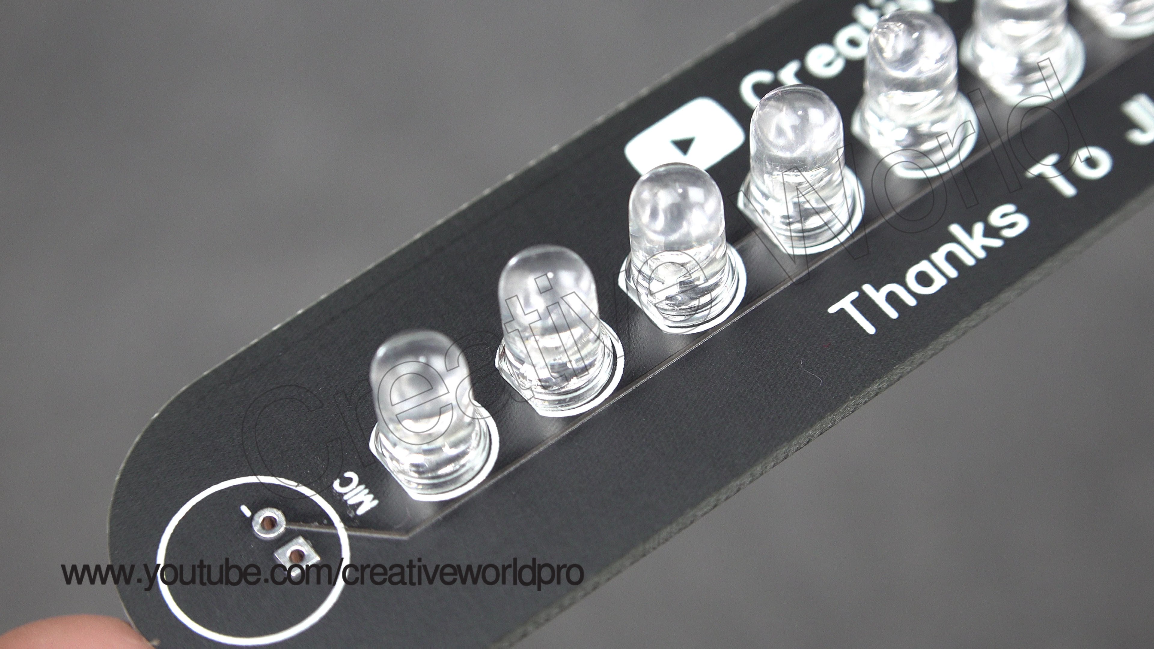

Music Activated Circuit Design
The schematic of music activated light circuit along with the PCB layout can be seen above. Power supply don’t included with the circuit. You can use any 12v battery for this project. To feel the best effect you can decorate all led in a rhythm. You also can use different color LEDs for different effect on this project

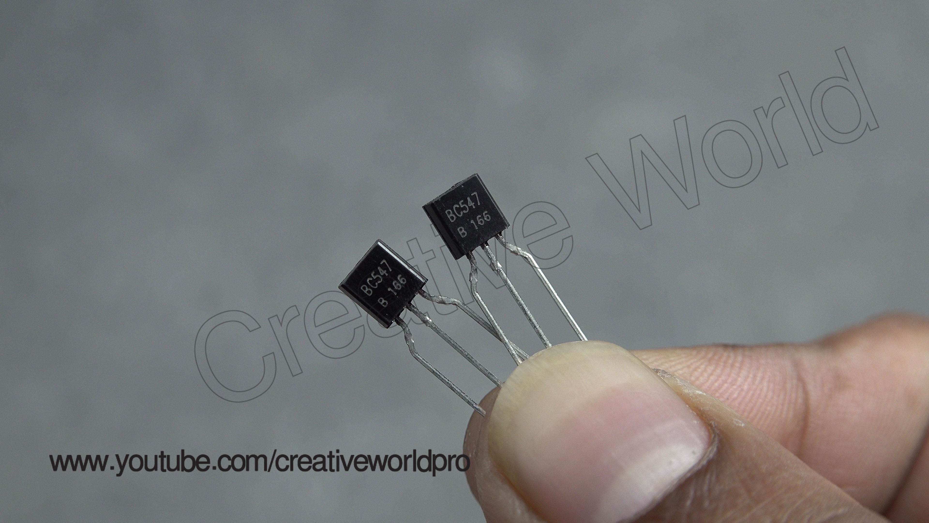

Transistor Pinout
BC 547 - It is an NPN transistor. As usual the transistor BC 547 also contain 3 leg & this 3 leg’s also have 3 different names. If we count it’s leg from left side, then 1no “Collector”. 2no “Base ” & 3no “Emitter”

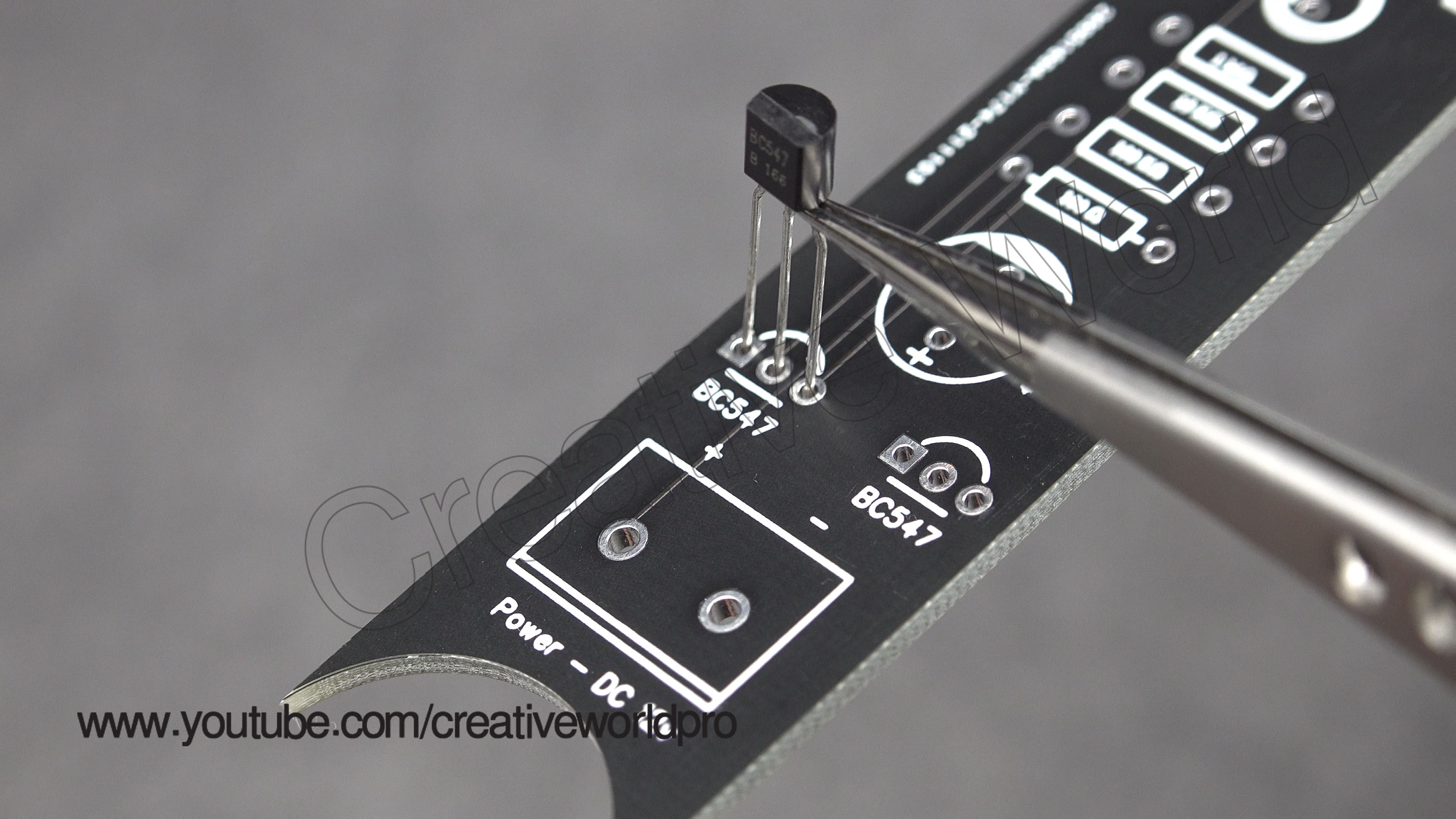

Connect Transistor With PCB
To make this circuit, 1st we connect transistor with the circuit. We connect both transistor emitter and connect one transistor base with another transistor collector leg.

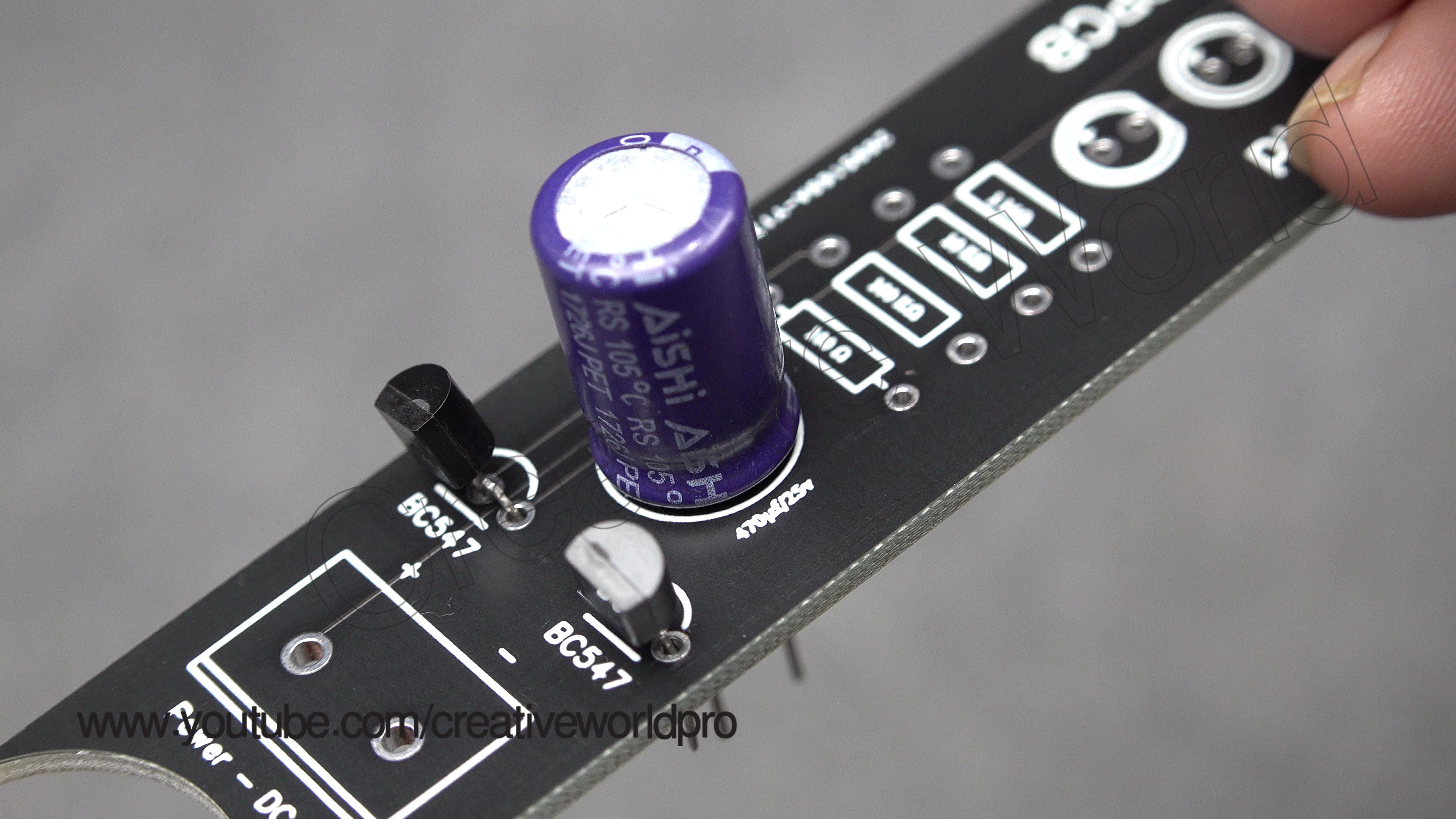

Connect Capacitor With Circuit
Now we connect 470µf/ 25v capacitor with the circuit. We connect capacitor negative leg with right side transistor base leg and this time we don’t connect capacitor positive leg with another component.

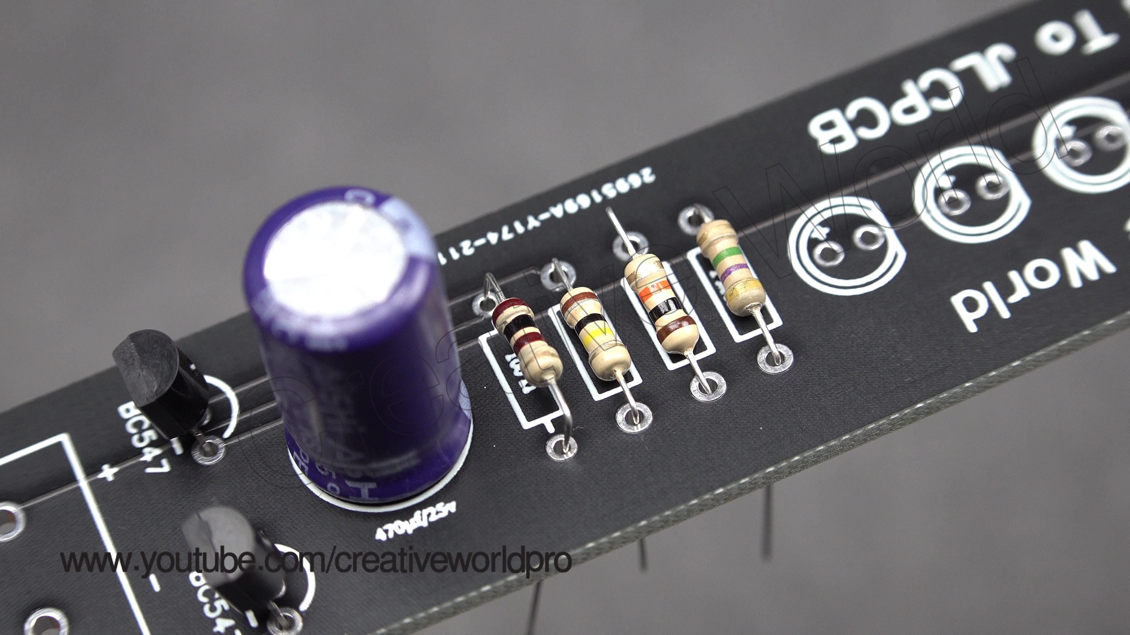

Connect Resistor With Circuit
1st we connect 100 KΩ resistor with right side transistor collector leg and it’s other terminal with 10 KΩ resistor. Then connect 10 KΩ resistor other terminal with the capacitor positive leg.
Then we connect 1 MΩ resistor with the circuit. We connect this resistor with right side transistor base leg and it’s other terminal with 100 Ω resistor.
Connect LED Lights

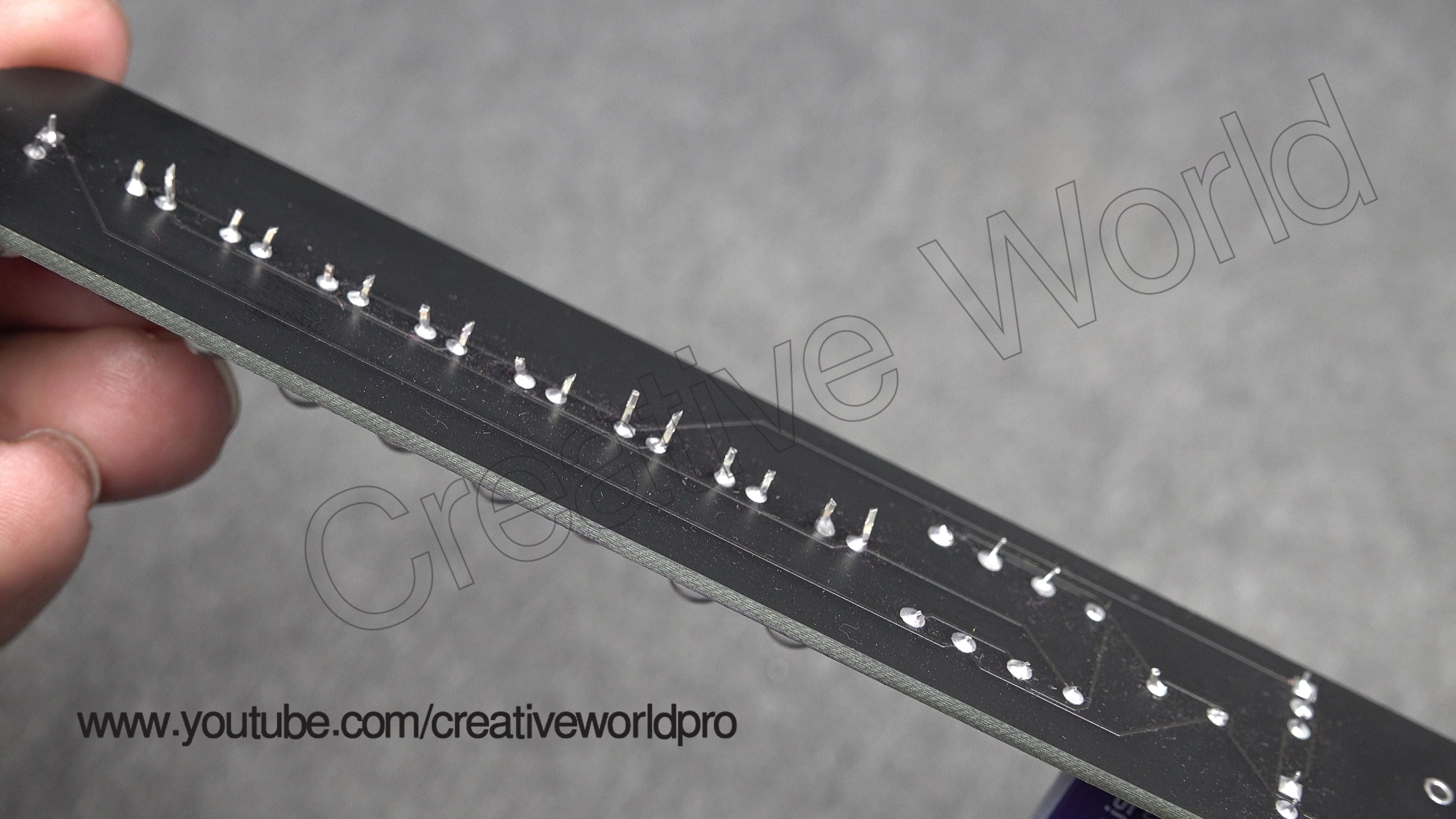

To get awesome effect, we use 8 piece 5mm LED light. We divide in two side and make a series connection between two side LED light. Then connect both LED negative leg with left side transistor collector leg.

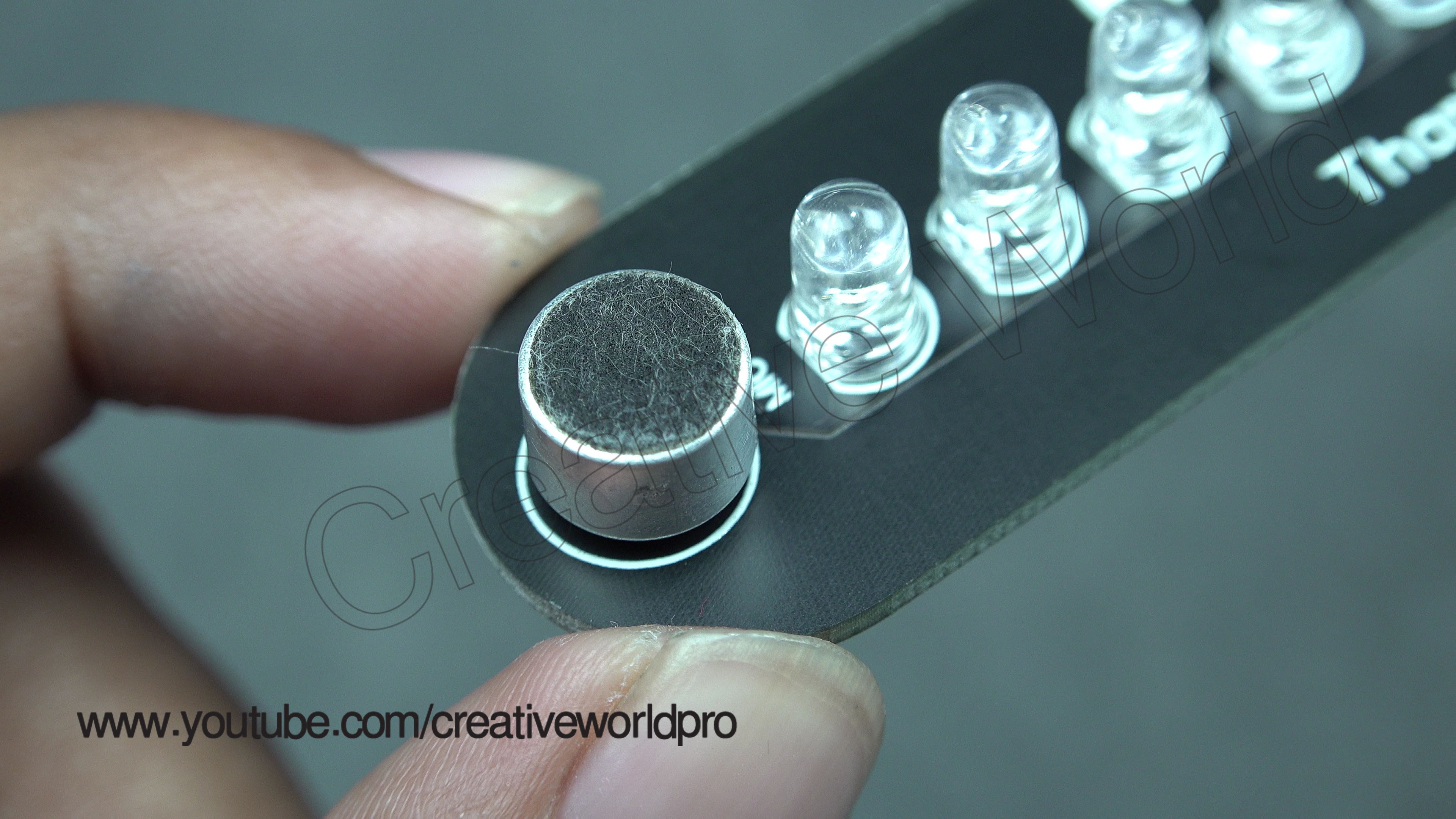

 Connect MIC With Circuit
Since it’s a music activated light, for that we need a MIC to make this project circuit. We connect MIC positive leg with the capacitor positive leg and connect MIC negative leg with both transistor emitter leg.

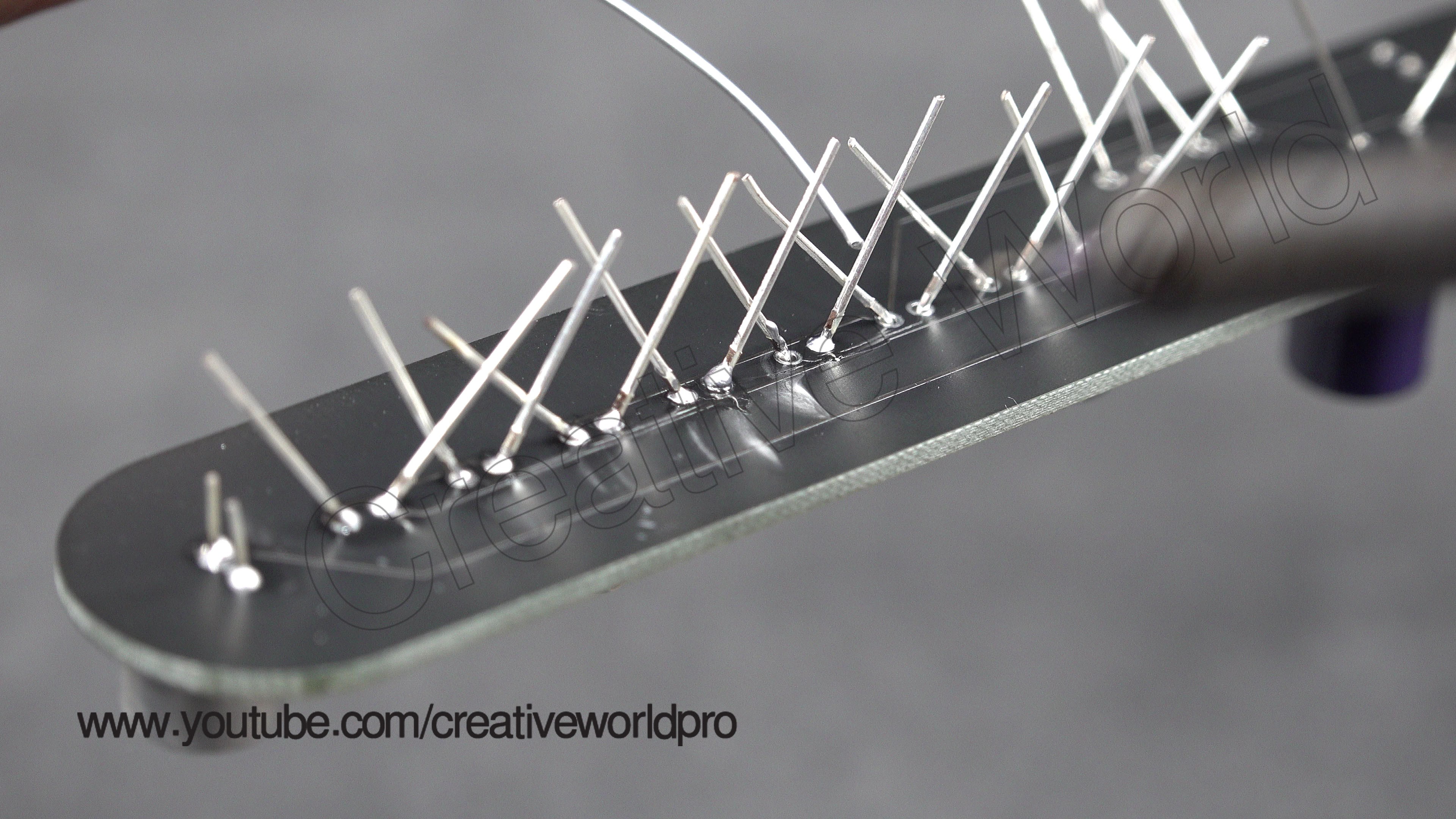

Soldering And Cleaning
Neat and perfect soldering is an important part for all kind of PCBs. Since soldering, you should remember that, there should not be any kind of short circuit connection. After soldering all leg, we cut-off the extra leg of all electronics component.
