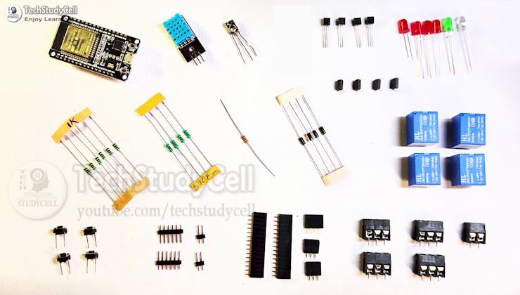

Required components for the ESP32 control 4 Relays PCB
- ESP32 DEVKIT V1
- Relays 5v (SPDT) (4 no)
- BC547 Transistors (4 no)
- PC817 Optocuplors (4 no)
- 510-ohm 0.25-watt Resistor (4 no) (R1 - R4)
- 1k 0.25-watt Resistors (6 no) (R5 - R10)
- 10k 0.25-watt Resistor (1 no) (R11)
- LED 5-mm (6 no)1N4007 Diodes (4 no) (D1 - D4)
- Push Buttons (4 no)
- Terminal Connectors
- Jumpper (2 no)

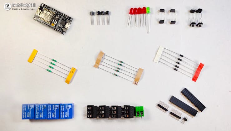

Required components for the NodeMCU control 4 Relays PCB
- NodeMCU ESP8266
- 1k 0.25-watt Resistors (5 no) (R5 - R9)
- LED 5-mm (5 no)
- 1N4007 Diodes (5 no) (D1 - D5)
- Jumpper (2 no)

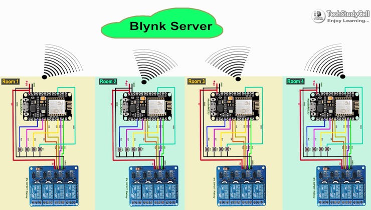

Multiple ESP32 NodeMCU ESP8266 Network
Now if you have multiple rooms, then you can use either ESP32 or NodeMCU for each room and then repeat the same circuit for each room.
If you use ESP32 then you can use either a 4-channel or 8-channel relay module, but for the NodeMCU you have to use the 4-channel relay module.
There is no limitation on the number of ESP32 or NodeMCUs that can be connected. All microcontrollers will connect to the Blynk server using the same Authenticate Token.
So we can control each NodeMCU or ESP32 independently from the Blynk IoT App.

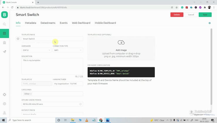

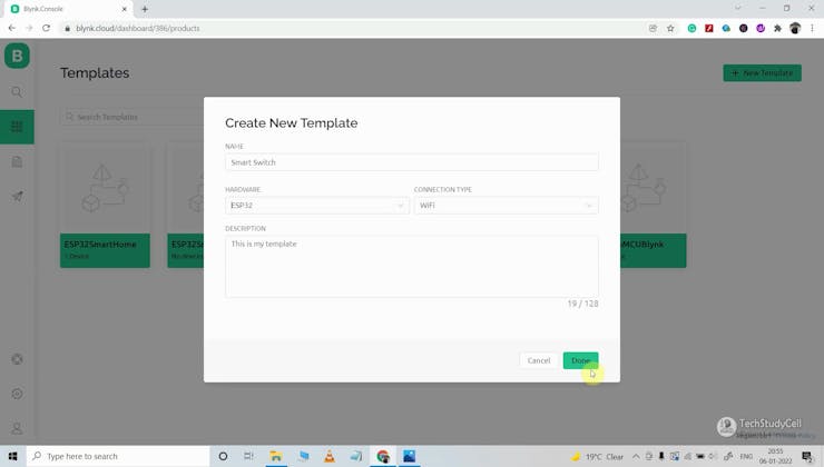

Create New Template for ESP32 in Blynk Cloud
For this smart house project, I have used the Blynk IoT Cloud Free plan. Click on the following link to create a Blynk Cloud account.
https://blynk.cloud/dashboard/register
Steps to Create New Template in Blynk IoT
- Click on New Template.
- Enter a template name, select the hardware as ESP8266, and the connection type will be WiFi.
- Then click on DONE.
You will get the BLYNK_TEMPLATE_ID and BLYNK_DEVICE_NAME after creating the temple.
**Although, I have selected ESP32 for creating the Template but you can also use this Template for ESP8266, as I will use Virtual Pins for the Datastreams.

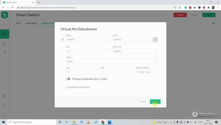

Create Datastreams in Blynk Cloud
After that, you have to create Datastreams. Here I will control 8 relays, so I have created 8 Datastreams to control 8 relays.
You have to create the Datastreams according to the number of relays you want to control.
Steps to Create Datastreams:
- Go to the Datastreams tab.
- Click on New Datastream and select Virtual Pin.
- Enter a name, select the virtual pin V1, and the datatype will be Integer. MIN value is "0" & MAX value is "1".
- Then click on Create.
- For the Feedback create the last Datastram with virtual pin V5, and datatype will be String.
- In a similar way, create the next datastreams with virtual pin V2, V3, V4, V5, V6, V7, and V8.

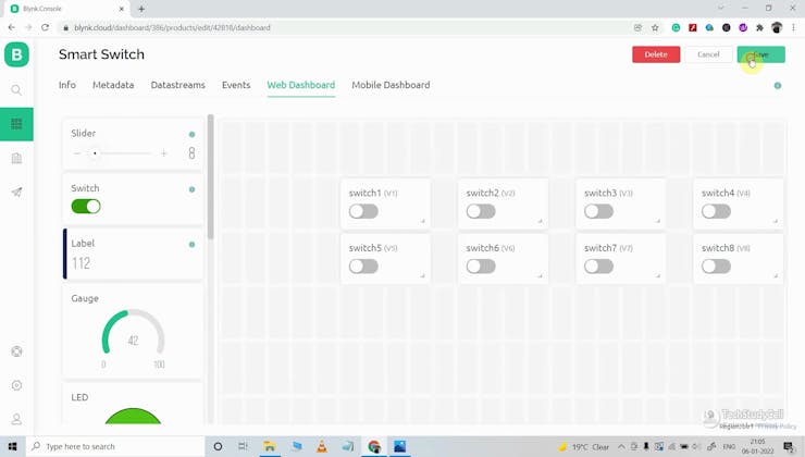

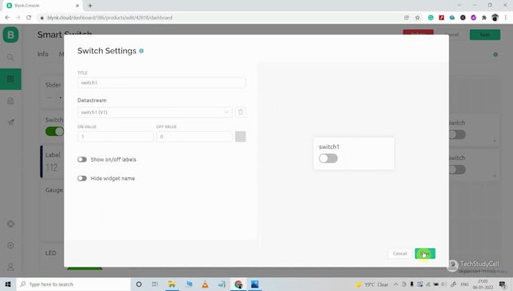

Set Up Blynk Cloud Web Dashboard
Steps to configure the Web Dashboard to control 8 relays from Blynk Cloud Dashboard
- Go to the Web dashboard tab.
- Drag and drop Switch widgets according to the number of relays.
- Go to the settings of each widget, and select a Datastream.
- Click on Save.
Then again click on "Save" to save the Template.

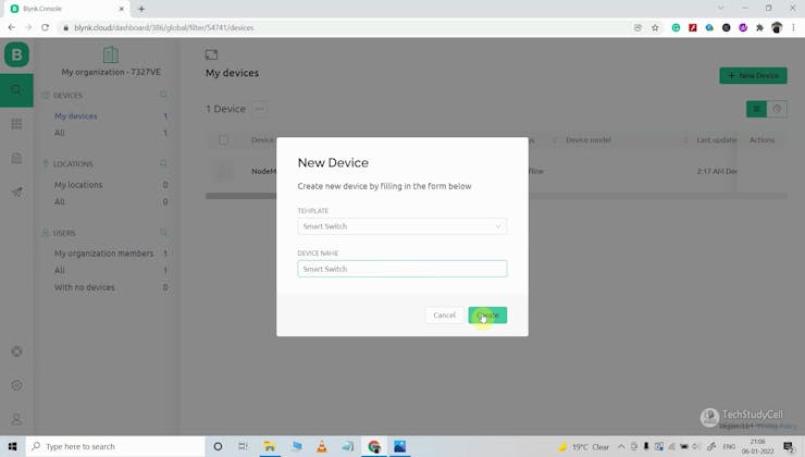

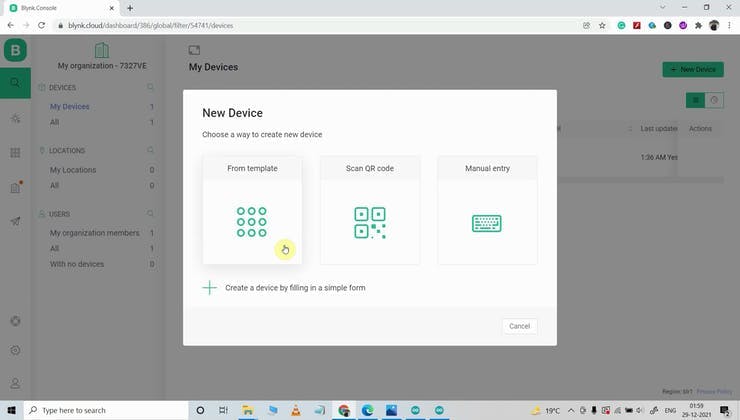

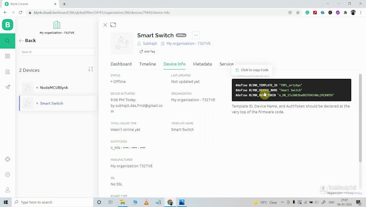

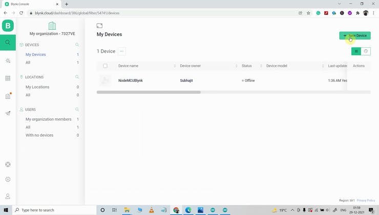

Add Device Using Template in Blynk IoT
Steps to add a device in Blynk IoT cloud:
- First, go to Device, then click on "New Device".
- Click on "From template".
- Select the Template, and give the device name.
- Click on Create.
Then in the device info tab, you will get the Blynk Auth Token, Template ID, and Device Name. All these details will be required in the code.

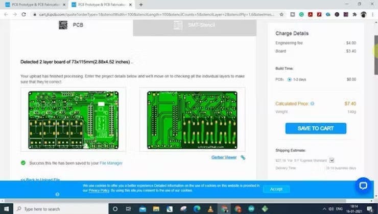

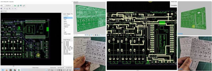

PCBs Used for This IoT Project
To make the circuit compact and give a professional look, I have designed PCBs for the ESP32 and NodeMCU control relays circuit.
You can download the PCB Gerber file of this Lora project from the following link:
GitHub link to Download PCB Gerber File

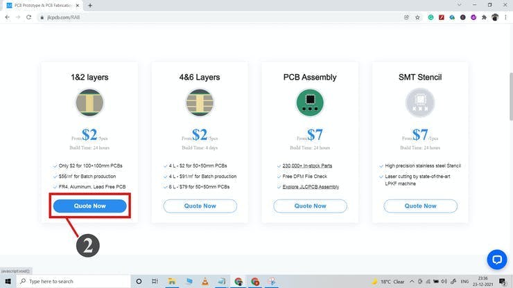

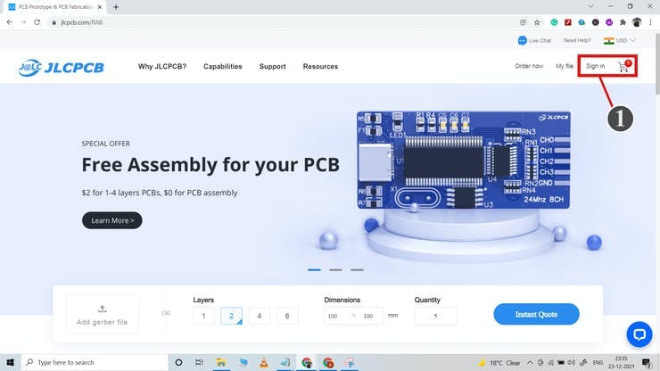

Order the PCB from JLCPCB
After downloading the Garber file you can easily order the PCB.
1. Visit https://jlcpcb.comand Sign in / Sign up.
2. Click on the QUOTE NOW button.
3. Click on the "Add your Gerber file" button. Then browse and select the Gerber file you have downloaded.
Uploading the Gerber File and Set the Parameters
4. Set the required parameter like Quantity, PCB masking colour, etc.
5. After selecting all the Parameters for PCB click on SAVE TO CART button.

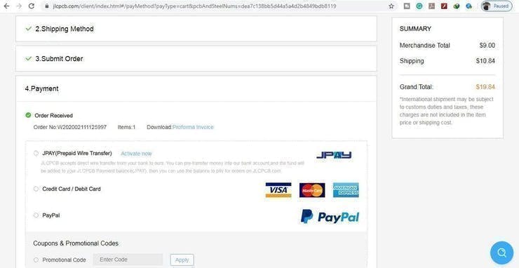

Select Shipping Address and Payment Mode
6. Type the Shipping Address.
7. Select the Shipping Method suitable for you.
8. Submit the order and proceed with the payment.
You can also track your order from the JLCPCB
My PCBs took 2 days to get manufactured and arrived within a week using the DHL delivery option.
PCBs were well packed and the quality was really good at this affordable price.

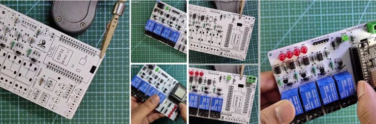

Solder All the Components on PCB
After that, I have soldered all the components as per the circuit diagram.
Then connect the ESP32 or NodeMCU with the PCB.

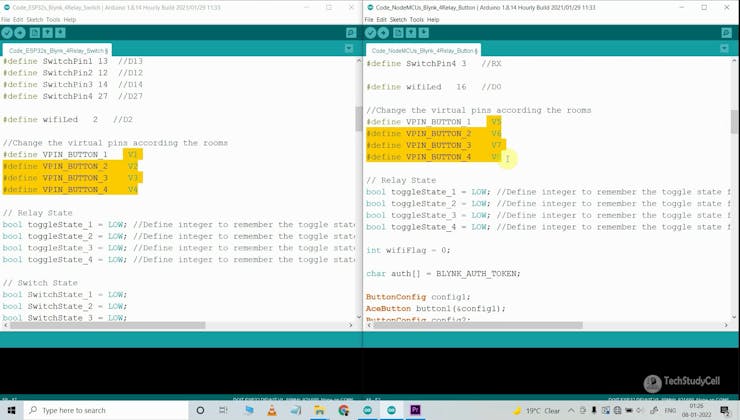

In the code, enter the Blynk Auth Token, Template ID, and Device Name
#define BLYNK_TEMPLATE_ID "" #define BLYNK_DEVICE_NAME "" #define BLYNK_AUTH_TOKEN ""
Then enter the WiFi Name and Password.
char ssid[] = "";
char pass[] = "";
For each NodeMCU or ESP32, you have to change the virtual pins in the code. For the ESP32, virtual pins will be V1, V2, V3, V4. And for the NodeMCU, virtual pins will be V5, V6, V7, V8.
To program NodeMCU select the “NodeMCU 1.0 ESP-12E” board and proper PORT. Then click on the upload button.
To program ESP32, select the “DOIT ESP32 DEVKIT V1” board and proper PORT. Then click on the upload button.
And while programming, please don't connect both microcontrollers with the laptop at the same time.

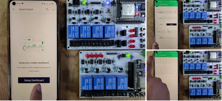

Set Up Blynk IoT App Mobile Dashboard
Install the Blynk IoT app from Google Play Store or App Store. Then log in and Tap on Developer Mode. Select the template that you have already made Then go to the Widget box (on the right) to add widgets.
Steps to set up Blynk IoT app Mobile Dashboard
- Add 8 Button widgets from Widget Box.
- Go to Button widget settings.
- Enter the name, select Datastream, Mode will be SWITCH.
- After configuring all the widgets tap on exit.
If the NodeMCU or ESP32 is connected with WiFi the BLUE LED (Built-in) will turn ON.

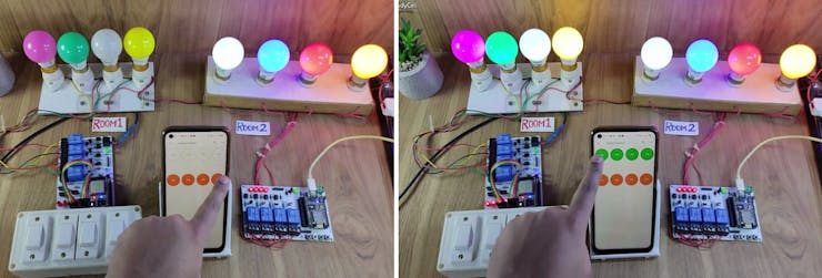

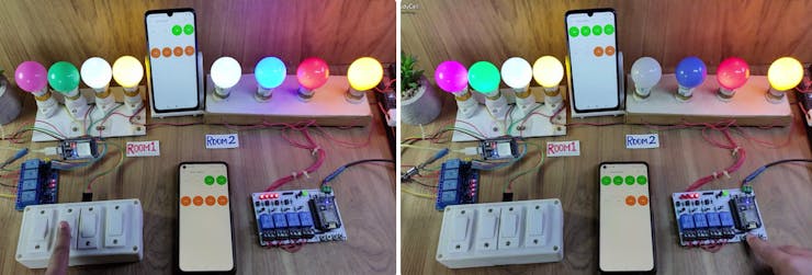

Control the Appliances With Blynk IoT
If the NodeMCU or ESP32 is connected with WiFi, then you can control the home appliances from Blynk IoT App.
You also use multiple smartphones to control the appliances with Blynk IoT App. For that, you have to log in same Blynk account from all the smartphones. In this way, all smartphones will be sink to the Blynk server.
You can control, monitor the real-time status of the relays from anywhere in the world with the Blynk IoT App.
Controlling Relays Without WiFi
If the WiFi is not available, you can control the relays from the switches or pushbuttons.
The NodeMCU or ESP32 will check for the WiFi after every 2 seconds. When the WiFi is available, the ESP32 or NodeMCU will automatically connect with the WiFi.
