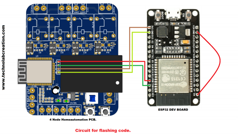

To flash the code into ESP32 chip, I will use ESP32 development board.
Make the connections according to below schematic.
Make the connections according to above schematic.
before you upload the code you need to enter the ssid and password of your router or hotspot.
And blynk authentication token that is sent by blynk on your registered email id.

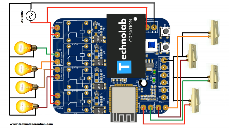

Connection of Switches & Bulbs.
Connect all the bulb and switches as Shown in the Schematics below.
Now your homeautomation system is ready to work.
