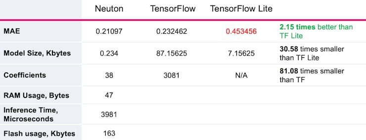

The trained model had the following characteristics:
The model turned out to be super compact, having only 38 coefficients and 0.234 KB in size!
Additionally, I created models with TF and TF Lite and measured metrics on the same dataset. The comparison speaks louder than words. Also, as I said above, TF models still cannot run operations on 8 bits, but it was interesting for me to use just such a primitive device.
