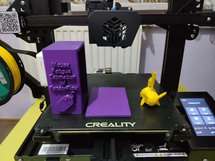

Step 1: Designing and printing a Pikachu-inspired case

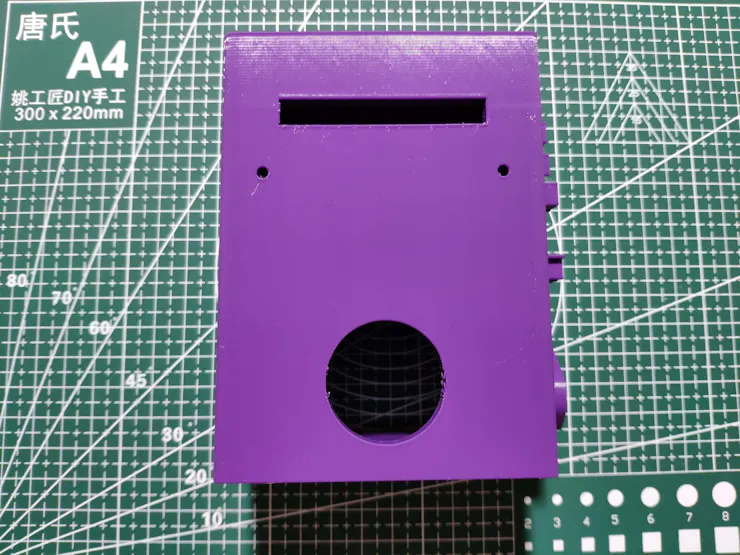

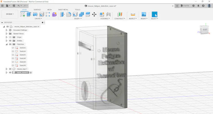

Since I wanted to collect forearm muscle soreness data and run the model while working or studying, I decided to design a Pikachu-inspired case to create a compact and sturdy device operating flawlessly on my desk. I thought adding Pikachu to my case would be funny due to Pikachu's notorious Thunder Shock attack stunning the opponent's muscles.
I designed the main case and its back cover in Autodesk Fusion 360. You can download their STL files below.
For the Pikachu affixed to the main case, I utilized this model from Thingiverse:

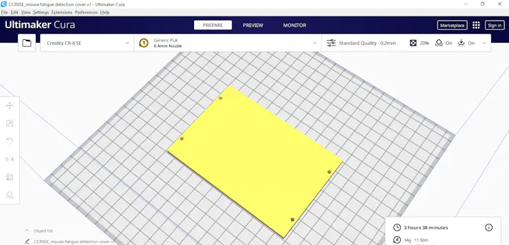

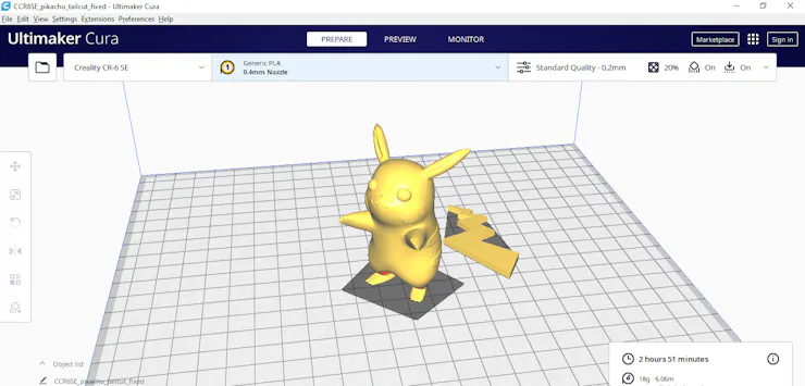

Then, I sliced 3D models (STL files) in Ultimaker Cura.
Since I wanted to create a solid structure for the case and apply a stylish theme to the device, I utilized these PLA filaments:
Finally, I printed all parts (models) with my Creality CR-6 SE 3D Printer. Although I am a novice in 3D printing and it is my first FDM 3D printer, I got incredible results effortlessly with the CR-6 SE :)

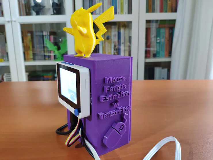

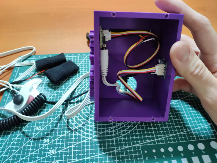

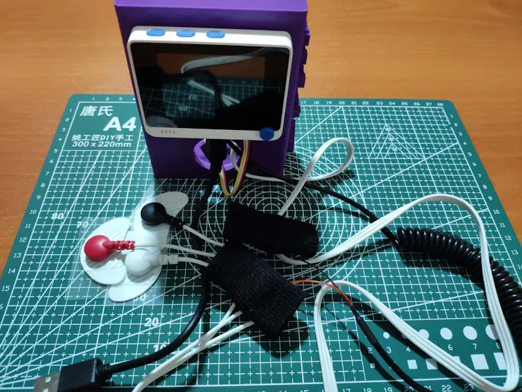

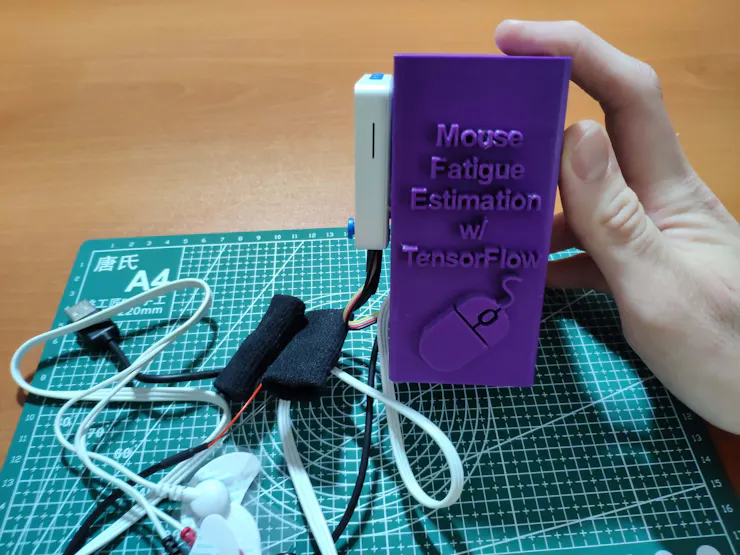

To collect and display forearm muscle soreness data, I connected the GSR sensor (Grove) and the EMG detector (Grove) to Wio Terminal. Since Wio Terminal has one Grove port supporting analog sensors, I connected the EMG (Electromyography) detector via a Grove male jumper conversion cable, as shown in the schematics below.
GSR (galvanic skin response) sensor needs to be calibrated by adjusting the integrated resistor until the sensor generates 512 as the output signal on the serial monitor before wearing it.
You can get more information regarding coding in Step 3.

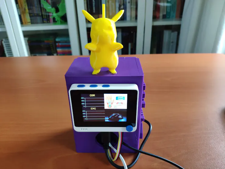

After printing all parts (models) and completing sensor connections successfully, I fastened all components to the main case and made connection points rigid by utilizing screws and a hot glue gun.
Finally, I attached the back cover to the main case via screws and affixed Pikachu to the top via the hot glue gun.

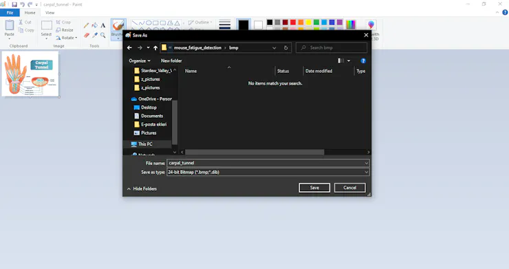

To display images on the TFT LCD screen integrated into Wio Terminal successfully, I needed to convert them to a compatible BMP file format and then load them from the SD card.

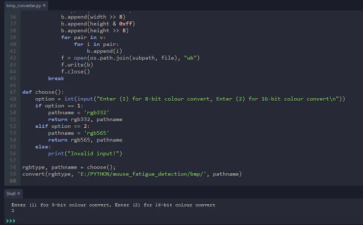

#️⃣ First, open Microsoft Paint to rescale images to the required sizes and save them as the 24-bit bitmap (.bmp) files in the bmp folder.
#️⃣ To convert the 24-bit bitmap (.bmp) files to Wio Terminal's required BMP file format, download the bmp_converter.py file and save it to the bmp folder.
#️⃣ Then, modify the folder location in the bmp_converter.py file and run it.
#️⃣ Enter 1 for 8-bit BMP file format conversion or 2 for 16-bit BMP file format conversion.
#️⃣ Finally, the bmp_converter.py file converts all the given 24-bit bitmap (.bmp) files and saves them to rgb332 (8-bit) or rgb565 (16-bit) folders in the bmp folder.

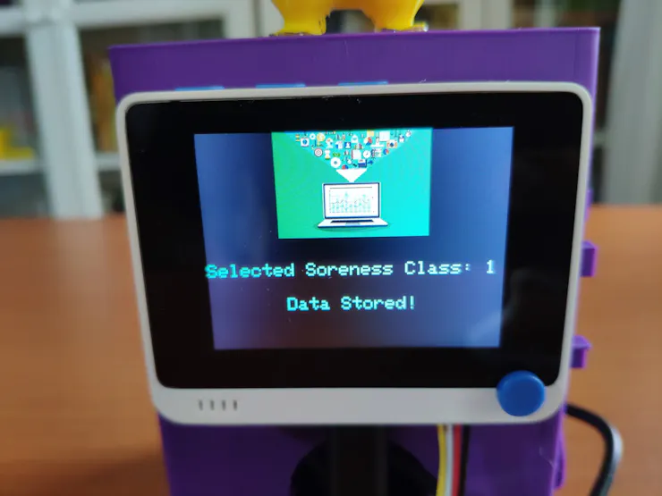

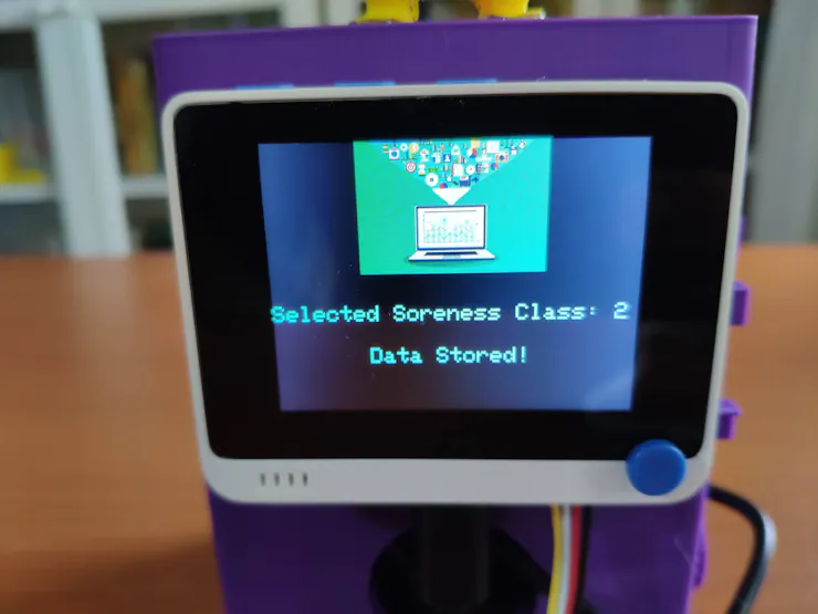

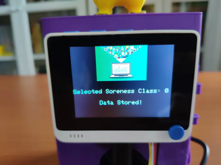

After uploading and running the code for collecting forearm muscle soreness data and saving information to a given CSV file on the SD card on Wio Terminal:

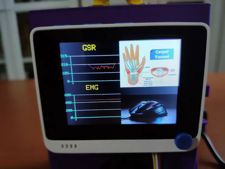

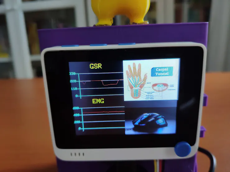

💪💻 The device displays real-time GSR and EMG measurements as line charts on the TFT screen.
💪💻 If Button A (configurable button) is pressed, the device appends a new row (data record) to the mouse_fatigue_data_set.csv file on the SD card by adding the Relaxed [0] muscle soreness class under the Soreness data field. Then, if the device saves the data record successfully to the given CSV file on the SD card, it shows:
💪💻 If Button B (configurable button) is pressed, the device appends a new row (data record) to the mouse_fatigue_data_set.csv file on the SD card by adding the Tense [1] muscle soreness class under the Soreness data field. Then, if the device saves the data record successfully to the given CSV file on the SD card, it shows:
💪💻 If Button C (configurable button) is pressed, the device appends a new row (data record) to the mouse_fatigue_data_set.csv file on the SD card by adding the Exhausted [2] muscle soreness class under the Soreness data field. Then, if the device saves the data record successfully to the given CSV file on the SD card, it shows:
💪💻 If Wio Terminal cannot open the given CSV file successfully, the device displays the error message on the TFT screen.
💪💻 Also, the device prints notifications and sensor measurements on the serial monitor for debugging.

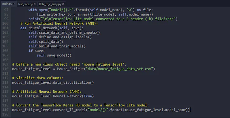

To execute all steps above and convert my model from a TensorFlow Keras H5 model to a C array (.h file) so as to run it successfully on Wio Terminal, I developed an application in Python. As shown below, the application consists of three code files and three folders:

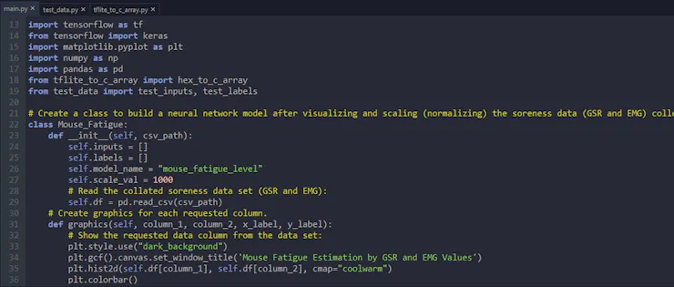

First of all, I created a class named Mouse_Fatigue in the main.py file to execute the following functions precisely.
⭐ Include the required modules.
import tensorflow as tffrom tensorflow import kerasimport matplotlib.pyplot as pltimport numpy as npimport pandas as pdfrom tflite_to_c_array import hex_to_c_arrayfrom test_data import test_inputs, test_labels
⭐ In the __init__ function, define the required variables to build the neural network model and read the forearm muscle soreness data set from the given CSV file.
def __init__(self, csv_path):        self.inputs = []        self.labels = []        self.model_name = "mouse_fatigue_level"        self.scale_val = 1000        # Read the collated soreness data set (GSR and EMG):        self.df = pd.read_csv(csv_path)

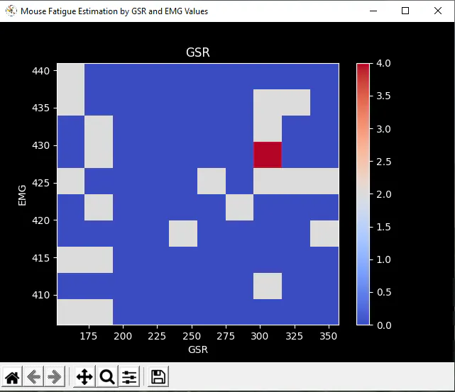

Step 4.1: Visualizing the forearm muscle soreness data set

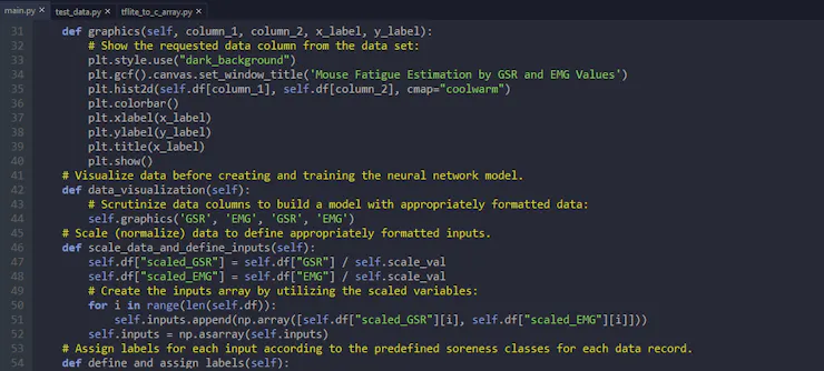

Since it is essential to understand a given data set to pass appropriately formatted inputs and labels to a neural network model, I decided to visualize my data set and scale (normalize) it in Python after extracting it from the mouse_fatigue_data_set.csv file saved in the data folder.
⭐ In the graphics function, visualize the requested data column (field) from the given data set by utilizing the Matplotlib library.
def graphics(self, column_1, column_2, x_label, y_label):        # Show the requested data column from the data set:        plt.style.use("dark_background")        plt.gcf().canvas.set_window_title('Mouse Fatigue Estimation by GSR and EMG Values')        plt.hist2d(self.df[column_1], self.df[column_2], cmap="coolwarm")        plt.colorbar()        plt.xlabel(x_label)        plt.ylabel(y_label)        plt.title(x_label)        plt.show()
⭐ In the data_visualization function, scrutinize all data columns (fields) before scaling and preprocessing the given data set so as to build a neural network model with appropriately formatted data.
def data_visualization(self):        # Scrutinize data columns to build a model with appropriately formatted data:        self.graphics('GSR', 'EMG', 'GSR', 'EMG')

⭐ In the scale_data_and_define_inputs function, divide every data element into their required values so as to make them smaller than or equal to 1.
⭐ Then, create inputs with the scaled data elements, append them to the inputs array, and convert this array to a NumPy array by using the asarray function.
⭐ Each input includes two parameters [shape=(2, )]:
def scale_data_and_define_inputs(self):        self.df["scaled_GSR"] = self.df["GSR"] / self.scale_val        self.df["scaled_EMG"] = self.df["EMG"] / self.scale_val        # Create the inputs array by utilizing the scaled variables:        for i in range(len(self.df)):            self.inputs.append(np.array([self.df["scaled_GSR"][i], self.df["scaled_EMG"][i]]))        self.inputs = np.asarray(self.inputs)

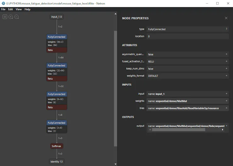

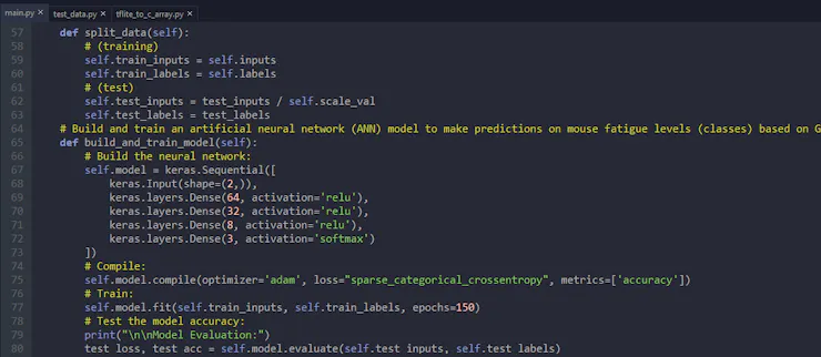

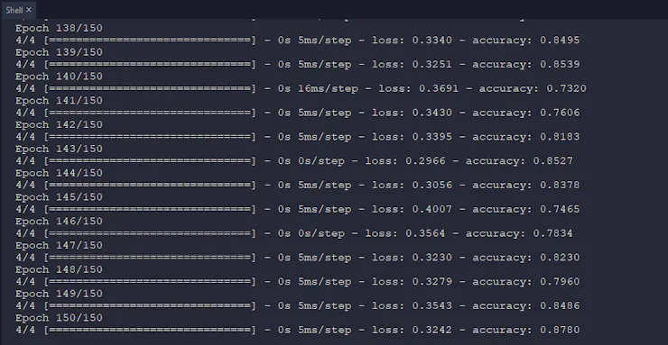

Then, I built my artificial neural network model (ANN) by utilizing Keras and trained it with the training set for 150 epochs.
You can inspect these tutorials to learn about activation functions, loss functions, epochs, etc.
def build_and_train_model(self):        # Build the neural network:        self.model = keras.Sequential([            keras.Input(shape=(2,)),            keras.layers.Dense(64, activation='relu'),            keras.layers.Dense(32, activation='relu'),            keras.layers.Dense(8, activation='relu'),            keras.layers.Dense(3, activation='softmax')        ])        # Compile:        self.model.compile(optimizer='adam', loss="sparse_categorical_crossentropy", metrics=['accuracy'])        # Train:        self.model.fit(self.train_inputs, self.train_labels, epochs=150)			...

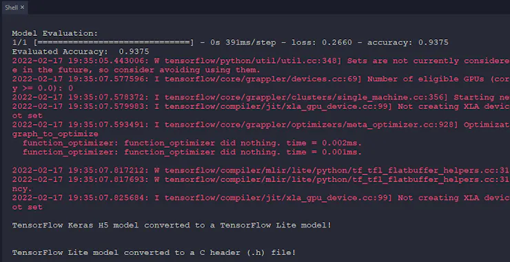

After training with the training set (inputs and labels), the accuracy of my neural network model is between 0.83 and 0.88.
Step 4.4: Evaluating the model accuracy and converting the model to a C array
After building and training my artificial neural network model, I tested its accuracy and validity by utilizing the testing data set (inputs and labels).
The evaluated accuracy of the model is 0.9375.
        ...		        # Test the model accuracy:        print("\n\nModel Evaluation:")        test_loss, test_acc = self.model.evaluate(self.test_inputs, self.test_labels)         print("Evaluated Accuracy: ", test_acc)

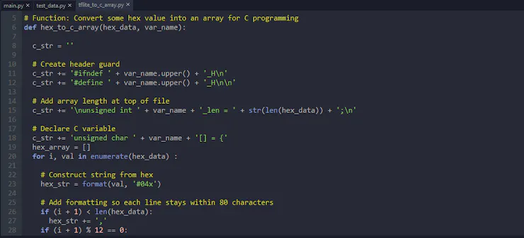

However, running a TensorFlow Keras H5 model on Wio Terminal to make predictions on muscle soreness levels is not eligible and efficient considering size, latency, and power consumption.
Thus, I converted my neural network model from a TensorFlow Keras H5 model (.h5) to a TensorFlow Lite model (.tflite). Then, I modified the TensorFlow Lite model to create a C array (.h file) to run the model on Wio Terminal successfully.
To revise the TensorFlow Lite model as a C array, I applied the hex_to_c_array function copied directly from this tutorial to the tflite_to_c_array.py file.
⭐ In the convert_TF_model function, convert the recently trained and evaluated model to a TensorFlow Lite model by applying the TensorFlow Lite converter (tf.lite.TFLiteConverter.from_keras_model).
⭐ Then, save the generated TensorFlow Lite model to the model folder (mouse_fatigue_level.tflite).
⭐ Modify the saved TensorFlow Lite model to a C array (.h file) by executing the hex_to_c_array function.
⭐ Finally, save the generated C array to the model folder (mouse_fatigue_level.h).
def convert_TF_model(self, path):        #model = tf.keras.models.load_model(path + ".h5")        converter = tf.lite.TFLiteConverter.from_keras_model(self.model)        #converter.optimizations = [tf.lite.Optimize.DEFAULT]        #converter.target_spec.supported_types = [tf.float16]        tflite_model = converter.convert()        # Save the recently converted TensorFlow Lite model.        with open(path + '.tflite', 'wb') as f:            f.write(tflite_model)        print("\r\nTensorFlow Keras H5 model converted to a TensorFlow Lite model!\r\n")        # Convert the recently created TensorFlow Lite model to hex bytes (C array) to generate a .h file string.        with open("model/{}.h".format(self.model_name), 'w') as file:            file.write(hex_to_c_array(tflite_model, self.model_name))        print("\r\nTensorFlow Lite model converted to a C header (.h) file!\r\n")

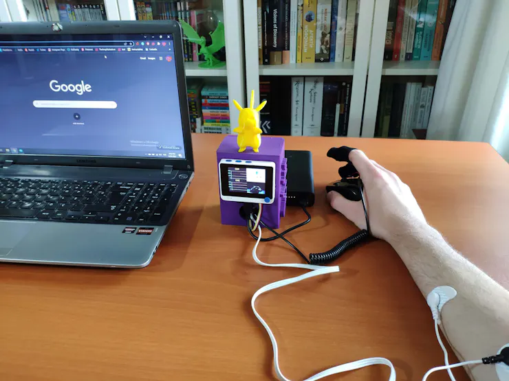

Step 6: Running the model on Wio Terminal to make predictions on muscle soreness levels

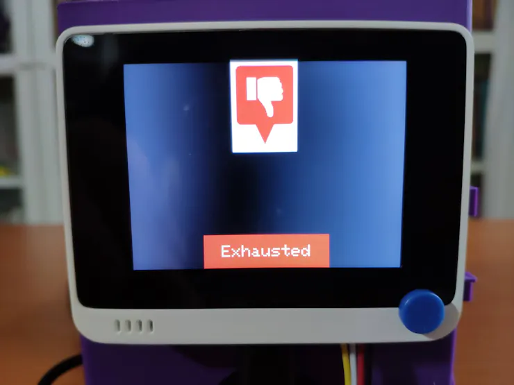

My neural network model predicts possibilities of labels (muscle soreness classes) for each given input as an array of 3 numbers. They represent the model's "confidence" that the given input array corresponds to each of the three different muscle soreness classes based on GSR and EMG measurements [0 - 2], as shown in Step 4:
After importing and setting up my neural network model as a C array on Wio Terminal successfully, I utilized the model to run inferences to forecast muscle soreness levels.
After executing the code for running inferences on Wio Terminal:

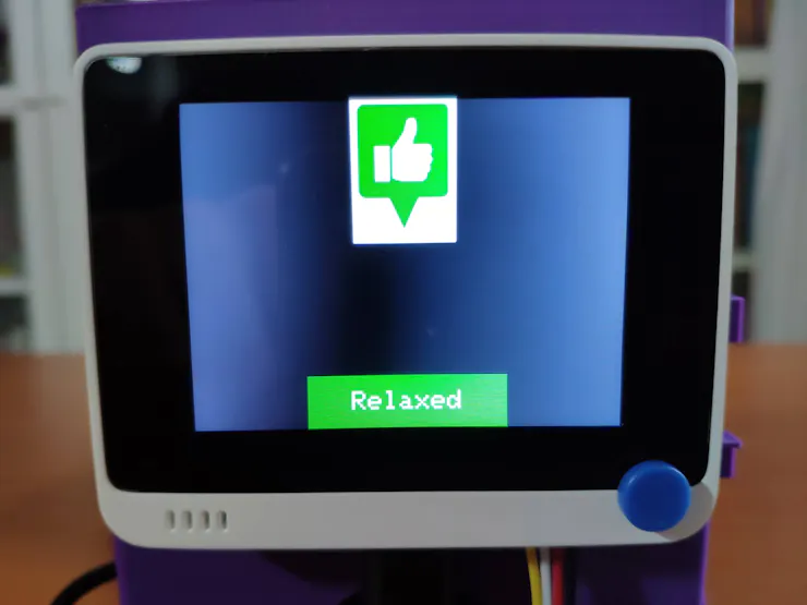

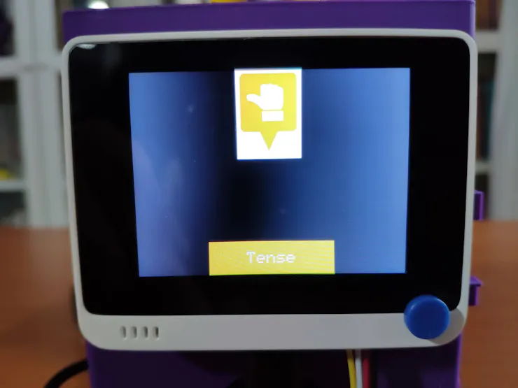

💪💻 If the 5-way switch is pressed, the device runs inference with the model by employing the most recently generated GSR and EMG measurements as the input.
💪💻 Then, the device displays the output, which represents the most accurate label (muscle soreness class) predicted by the model.
💪💻 Each muscle soreness level (class) has a unique image (16-bit BMP file) and color code to be shown on the TFT screen when being detected as the output:
As far as my experiments go, the device operates impeccably while predicting forearm muscle soreness levels (classes) :)
