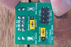

- Power Grid System
- While the PCB design is good, I'd like to remake the PCB.
