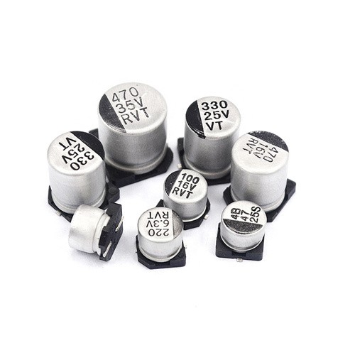

  3. Capacitor – 2.2µf/50v (SMD_4*5.4mm)

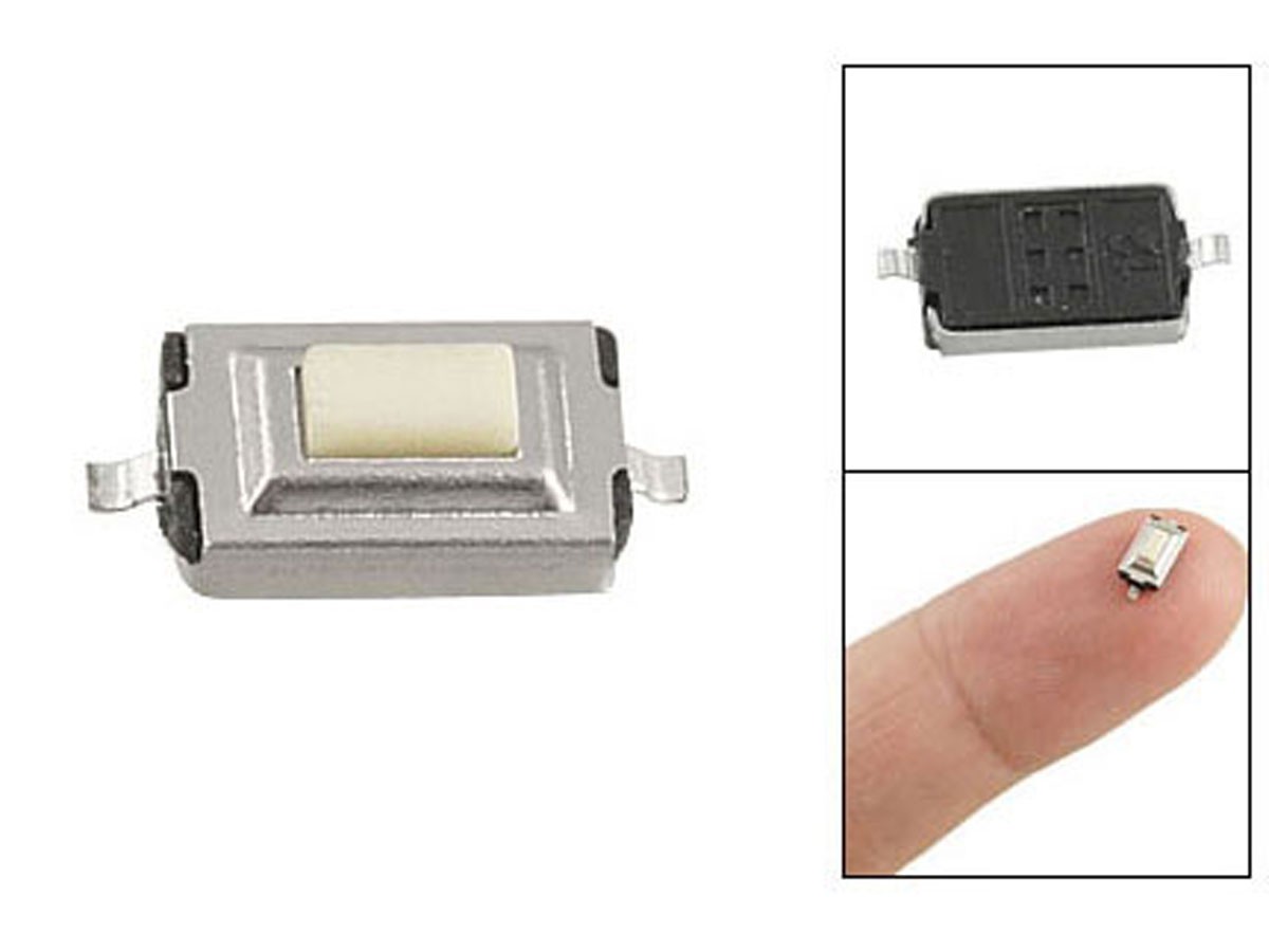

  5. Push Switch – TS3625A

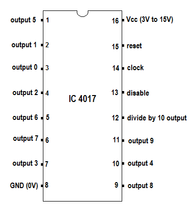

CD-4017 Pin Out -
CD-4017 is used for low range counting applications. It can count from 0 to 10 (the decade count). It has 10 outputs that represent the number 0 to 9. The counter increases with one for every rising clock pulse. After the counter has reached 9, it starts again from 0 with the next clock pulse.
The easiest way to create a decade counter is by connecting 10D flip-flops in series to create a shift-register. This is also known as a ring counter. One of the most popular hobbyist projects to build with this chip is the running LEDs circuit.
The LEDs blink in sequence from the first to last and then starts from the first again. LEDs are connected to each of the outputs and therefore appear to be “running” along a line.
Its 16 legs Pin Out can be seen above -
  1. Pin-1: When the counter reads 5 counts then this pin 1 will become high which is output number 5.
  2. Pin-2: When the counter reads 1 count then this pin 2 will become high which is output number 1.
  3. Pin-3: When the counter reads 0 counts then this pin 3 will become high which is the output number 0.
  4. Pin-4: When the counter reads 2 counts then this pin 4 will become high which is output number 2.
  5. Pin-5: When the counter reads 6 counts then this pin 5 will become high which is output number 6.
  6. Pin-6: When the counter reads 7 counts then this pin 6 will become high which is the output number 7.
  7. Pin-7: When the counter reads 3 counts then this pin 7 will become high which is the output number 3.
  8. The ground is supply to this IC at Pin number 8.
  9. Pin-9: When the counter reads 8 counts then this pin 9 will become high which is output number 8.
  10. Pin-10: When the counter reads 4 counts then this pin 10 will become high which is output number 4.
  11. Pin-11: When the counter reads 9 counts then this pin 11 will become high which is the output number 9.
  12. This pin number is used to delay the counting operation. When the 10 clock cycles complete one full cycle complete and the carry bit will be used as a delay
  13. When the enable is low then the IC CD 4017 will perform its operation. So to make the IC on we will ground the enable pin and if we want to off the IC we will make it high when this pin is in the high state it will ignore the clock signal. It will work only when we make this pin to operate in a low state.
  14. This pin will operate on the positive edge of the clock. When the first clock pulse is detected pin 3 goes, for the next clock pulse pin 2 goes high like this sequence is formed. A sequence output will be formed...
