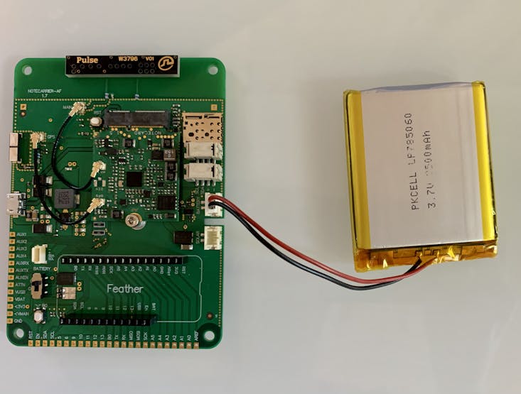

In addition to the Notecarrier-AF, I also bought an Adafruit Lithium Ion Polymer Battery - 3.7v 2500mAh (LiPo battery), to power this board as it roams around with me in my car.
When the Notecarrier is connected to a computer via the micro-USB port, as it will be for the initial configuration, the computer can power the board, otherwise it needs its own standalone power source.
There is a LiPo battery JST connector on the side of the board (which can recharge a battery when the board's connected to a computer via the micro-USB power port), and right next to that is a solar panel JST connector. If need be, this tracker can run entirely via solar power and never needs to be plugged in to recharge.
With my Notecarrier-AF in hand, my cellular and GPS wires correctly connected to the board and the Notecard, and a LiPo battery to power the whole thing, it's time to set up the cloud project that will initially receive the data collected.
Note: For this project, don't install the Adafruit Feather microcontroller - it will drain the battery much too fast and is not necessary for this project. It's best kept when you'll be programming it and giving it a steady power source.
Here's a picture of my working development board and its LiPo battery source.
My Notecarrier-AF hooked up to its LiPo battery - this little device is ready to go. Notice I've removed the Feather microcontroller from the development board - it's a battery killer.

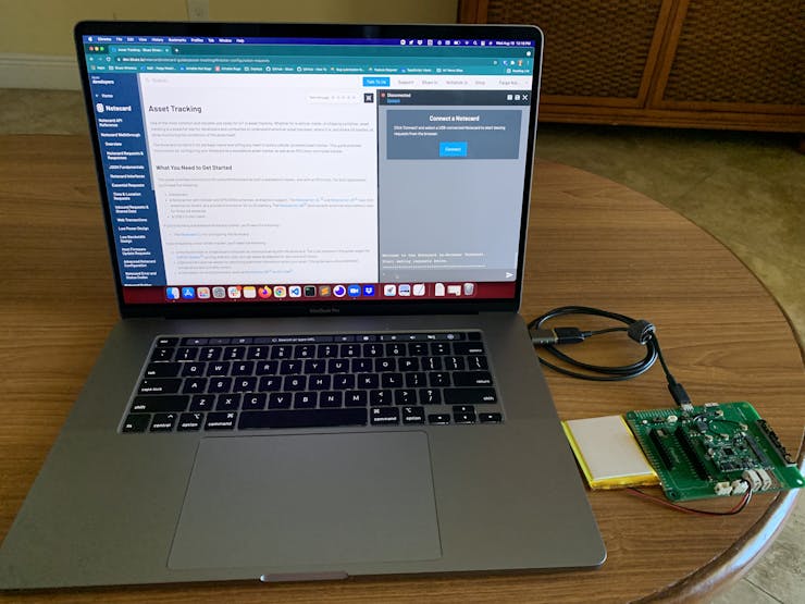

The Notecard CLI is a command-line utility for interaction with a Notecard connected directly to a computer over USB. If you're planning to do more Notecard programming, I'd recommend downloading it locally from GitHub so you can use your preferred terminal to interact with the Notecards.
Here's mine connected to my MacBook with a micro-USB to USB-A connector cable. I got this one for cheap from Amazon, plus a USB-A to USB-C adapter -because Apple must always use something different than everyone else (lightning charger, anyone?).
Notecarrier-AF connected to MacBook Pro via micro-USB to USB-A connector cable.
Once you're connected to your computer, you can expand the Notecard Playground on the right side of the screen and follow along with the set up instructions.
I just used the barebones "Tracker Configuration" instructions, so I'll show you my code snippets (also included in the code portion of this article) but spare you the details - you can read them when you visit the page yourself.

Possible issue #1: The Notecarrier-AF battery drains fast
I encountered this issue early on where it seemed like my Lithium Ion battery lasted only a couple of days before the Notecarrier would brown out and stop recording metrics - but the Notecard is supposed be ultra low power, especially when not in use.
Yes, the Notecard is low power, but the Adafruit Feather ESP32 microcontroller on top of the Notecarrier-AF is not. It's quite the battery hog, which one of the embedded hardware engineers revealed to me when we were trying to troubleshoot why my Notecarrier (which is supposed to last at least 3 years on a single battery charge) was dying so quickly.
Solution: Remove the Feather microcontroller from the top of the development board for better battery life (it's not needed for this project anyway).
