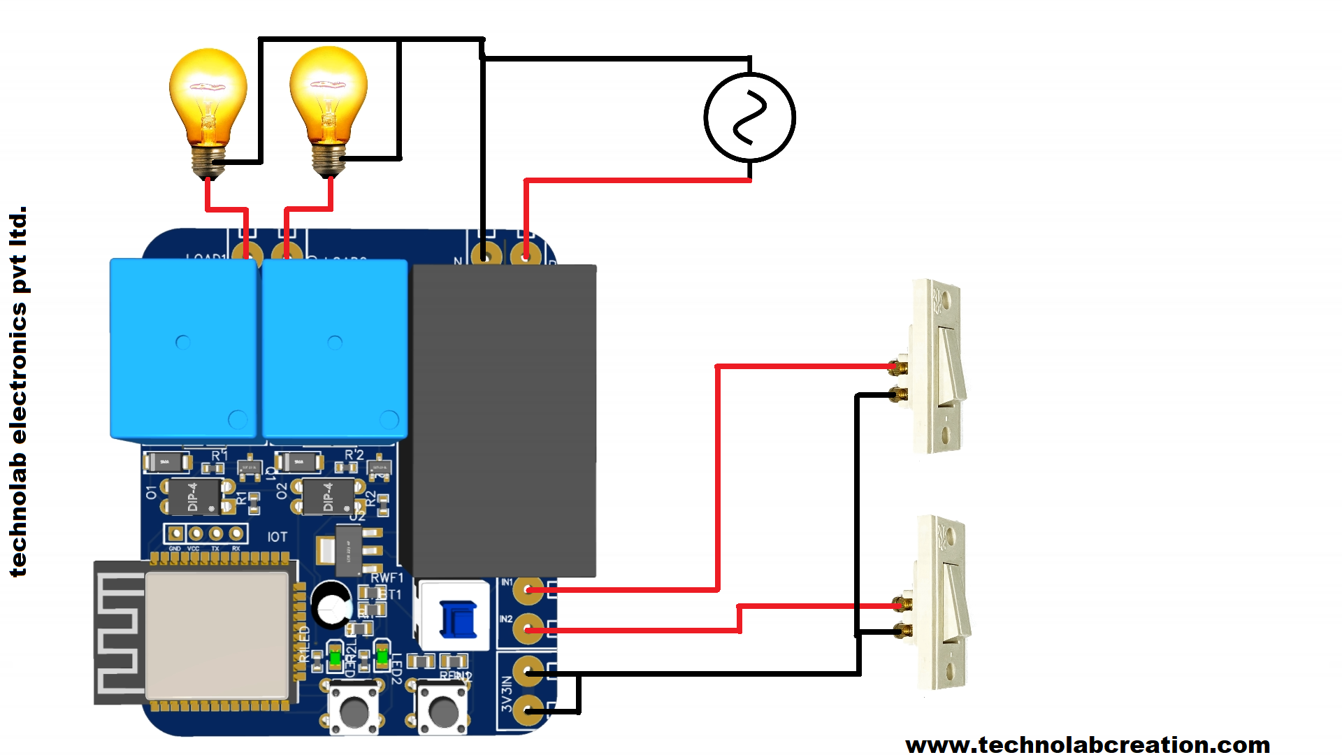

In this home automation project we can control our home-appliances via BLYNK smartphone application , BLYNK web-dashboard from anywhere in this world.
and also we can control our home-appliances via manual switch buttons and we can also monitor the real time status in the BLYNK app.

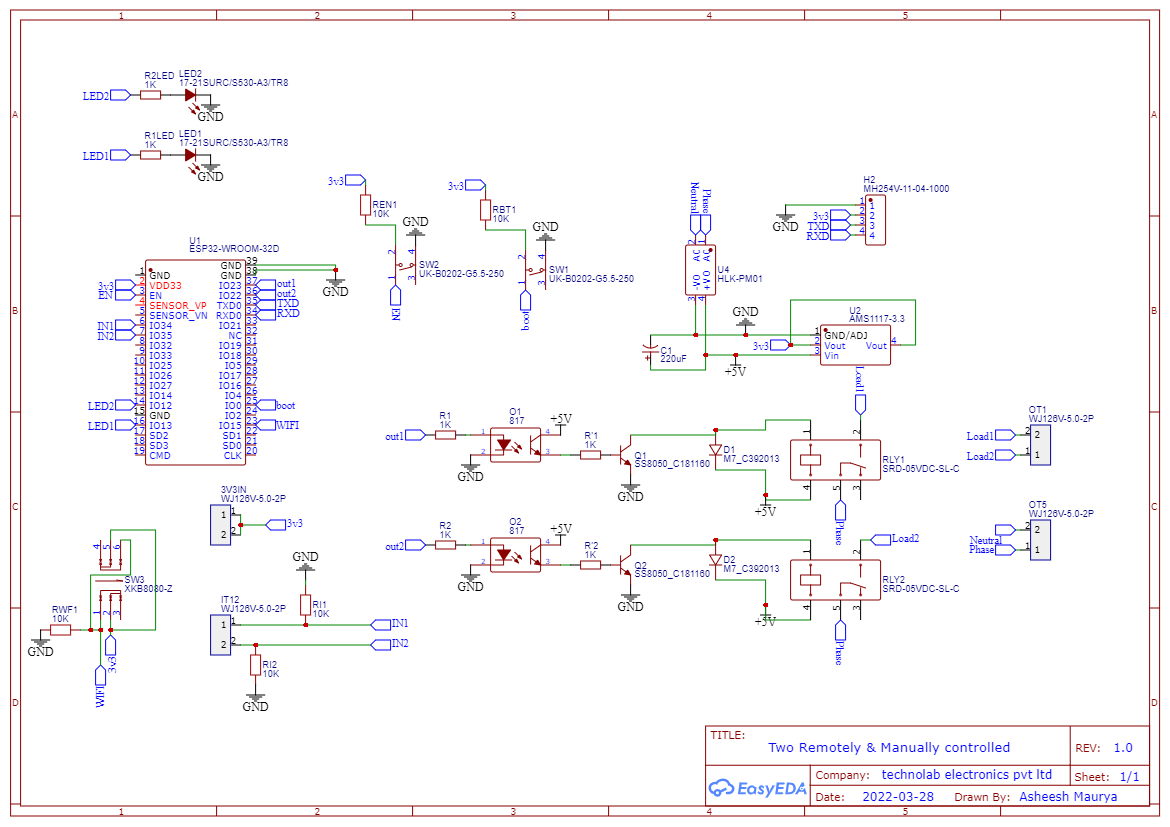

Designing the PCB.
To design the circuit and PCB, we used EasyEDA which is a browser based software to design PCBs.
Designing the circuit works like in any other circuit software tool, you place some components and you wire them together.
Then, you assign each component to a footprint.
Having the parts assigned, place each component. When you’re happy with the layout, make all the connections and route your PCB.
Save your project and export the Gerber files.

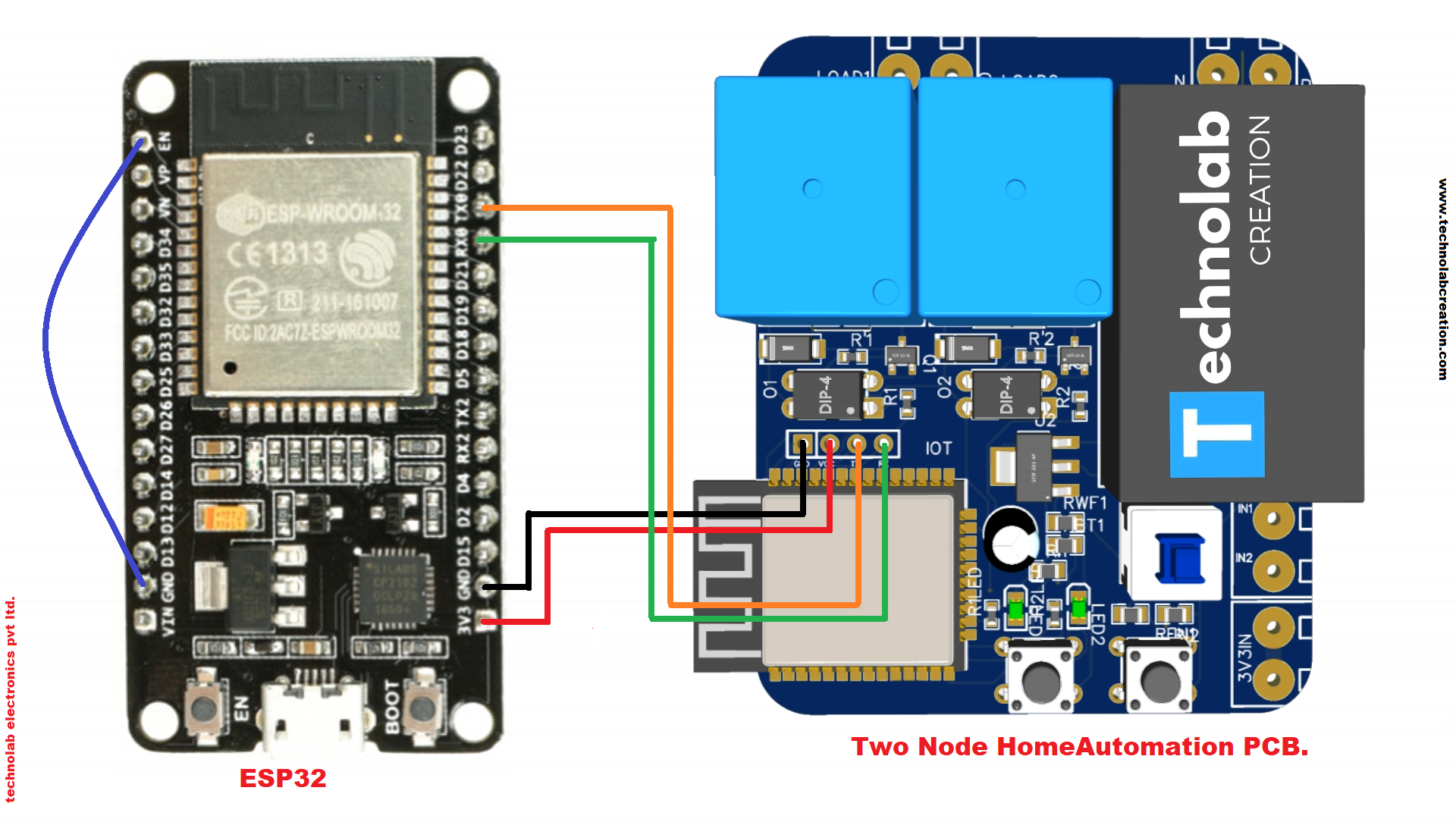

Now grab all the components whose list is mention below, and soldered on the PCB.
1.ESP32 Chip.
2.Highlink (HLK-5M05).
3.Relay (5volts).
4.Terminal connectors.
5.Optocoupler(PC817).
6.DPDT Switch.
After soldiering rest of components PCB look like this neat, clean and well arranged.
