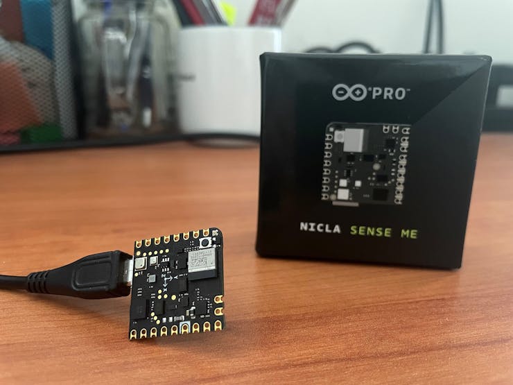

The ML model will be deployed on the Arduino Nicla Sense ME board, a tiny and low-consumption Arduino board with strong computational power. It is based on a 32-bit microcontroller with 4 sensors: motion, magnetometer, pressure, and gas sensor. It is suitable for projects that need to combine sensor measurements and AI tasks on a small device. The perfect match for this experiment!
Arduino Nicla Sense ME.

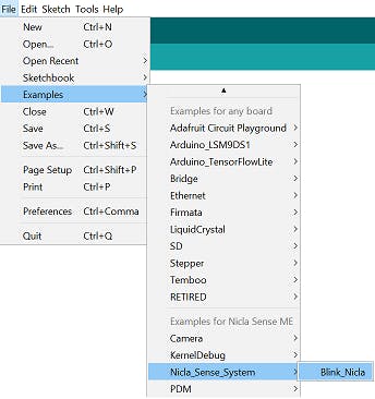

Before “getting your hands dirty” with Machine Learning, check if Nicla works correctly: open the “Nicla_Blink” sketch inside “Nicla_Sense_System” examples and upload it. The LED mounted on your Nicla will start to blink green.
Nicla_Sense_System examples.
Blink_Nicla sketch runs on Arduino Nicla Sense ME.

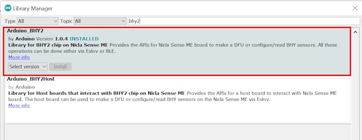

Accelerometer measurements will be performed by the Bosch BHI260AP: a 6-axis IMU sensor mounted on Nicla.To verify that all Nicla sensors are working correctly, download “Arduino_BHY2” library from the library manager and open the “Standalone” example.
Arduino_BHY2 library.

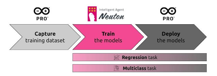

The experiment consists of three stages:
Experiment process flow.

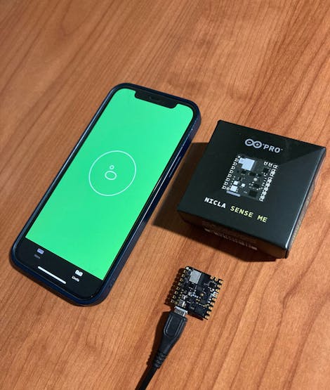

Upload and run the sketch, open the serial monitor and incline your Nicla in the target position (verify it with the inclinometer or with the app). After that, you type the degree value in the input field of the serial interface and press enter: the program will perform the measurement… Do not move your board during it!Repeat this for each degree to measure. In this experiment, I measure from 0° to 5° in steps of one degree (0°, 1°, 2°, 3°, 4°, and 5°).
Nicla Sense ME and iOS Measure app.

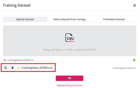

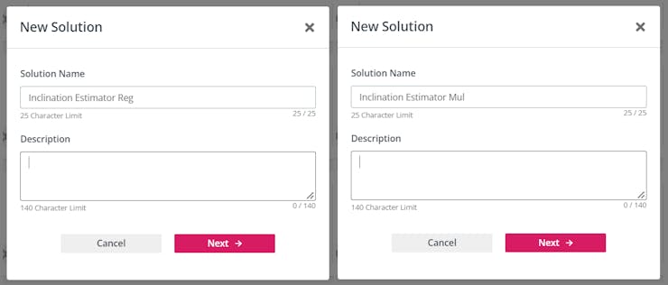

2a. Uploading dataset
Neuton: add a new solution.
For each solution:
Neuton: validated dataset.
Neuton: Target variable.

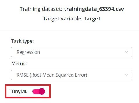

Neuton: Task type selection - Regression
Neuton: Task type selection - Multi classification
Neuton: TinyML option.
Neuton: TinyML Advanced settings.

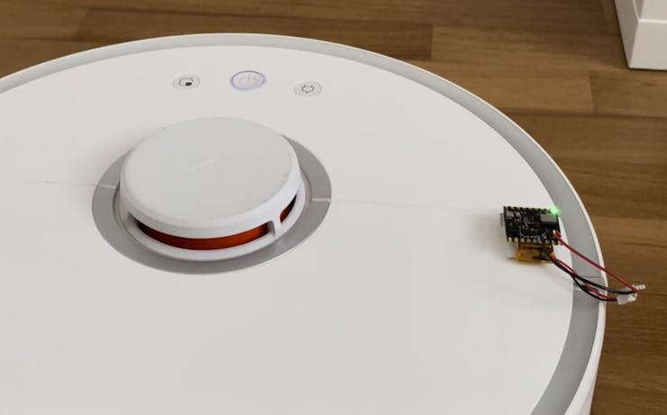

To show the inclination estimate in action, I put the Nicla powered with a small battery on the vacuum robot.The Nicla indicates slope value with led color:
Nicla and battery installed on my vacuum cleaner robot
