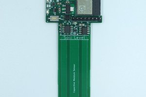

FLORA's main use case is to make your garden, or home farm just that little bit smarter. It has an onboard sensor that can be used to measure temperature and humidity, three ports to connect to a soil moisture sensor, and a LoRa module that can be used to transmit data to any other LoRa modules that are on the same frequency band up to 3 km away.
The ability to use multiple soil moisture sensors for each FLORA unit allows you to ensure that a particular flower bed or patch of soil is irrigated evenly. The moisture sensors themselves are based on a capacitive sensor that measures the change in the dielectric which allows them to be fully insulated and corrosion proof. Learn more about the technology here.

  • Soil Moisture Sensor | Made by elektroThing
    • Uses Capacitive Sensing
  • LoRa Transceiver | RA-01H
    • Frequency | 803/930 MHz
    • Interface | SPI
    • Antenna | External Antenna or PCB Antenna (reduced range)

    Over the past few months, I have been writing up the firmware for FLORA as well as identifying and trying to resolve the issues with the board. I am happy with what it is capable of doing for now however, there are still some niggling issues that need to be overcome for it to be able to perform as described.
    The setup how the FLORA units are shown below. Using two usings, one as a receiver and the other as the "boots on the ground". The unit placed outside is powered solely by solar power and can read from its sensors and relay them back to the receiver. The intention is to leverage LoRaWAN to increase operational range and broaden its use cases. However, for simplicity, the current setup uses ESP's very own ESP-NOW communication protocol that performs well up to 50m. Over ESP-NOW, the receiver can read the temperature, humidity, and soil moisture levels from the unit in the garden.
    The data is then presented over a simple GUI that can be accessed over the WiFi network by typing in the IP address of the unit - e.g. 192.168.1.111::8080. Each data point is also sent to the cloud using Thingspeak's services to further analyze and visualize the data. This could then be used to trigger some sort of action to the user such as sending an email/SMS to rectify an issue in the garden.
