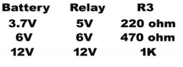

Circuit diagram has a potentiometer of 10k with resistor in series and controlling the overall action of relay. Here are some changes in the configuration, you can see the ratings of battery and relay in the diagram given below.
All the other things remains same, just relay and LED protection resistor is changed. Relay coil is always supplied in a parallel reverse baise diode. Which eliminate huge spikes due to voltage across the coil.

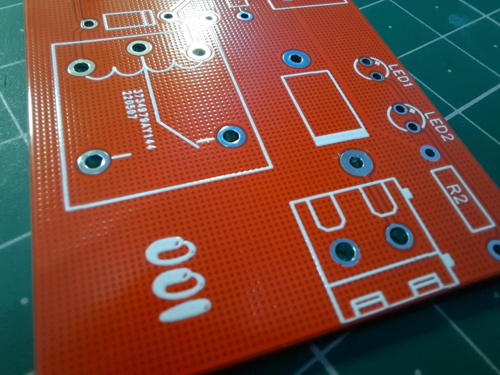

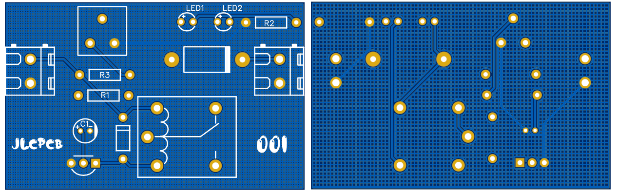

PCB layouts:
If you want to use the same designs as mine then Download PCB Gerber files from here.
I ordered 1.6mm thick PCBs with Hasl finishing, red solder mask. You can try JLCPCB prototype service for your projects. And here is a good news! If you sign-up using this link you will get free coupons of worth $30 to order PCB and for SMT assembly service. If you want to know more about JLCPCB and SMT assembly service then see our article "Why I prefer JLCPCB for my projects.
