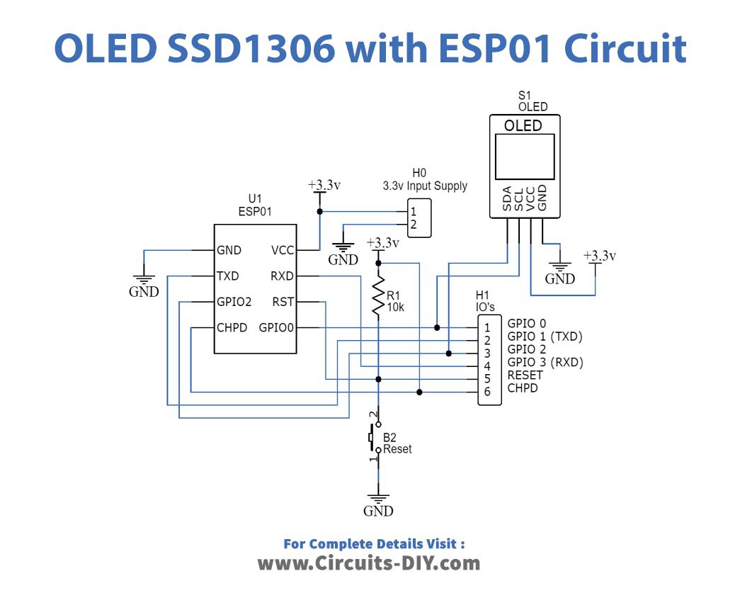

In this post, we are going to add a screen to ESP8266 ESP-01 to display data obtained from a web service. The ESP-01 is limited in the number of GPIO pins available, with up to 4 pins available if we count the TX and RX pins (but once you use those, you will no longer be able to use the serial monitor, as those pins will become GPIO and not transmit serial data). This might be a stopper for many projects, but not for this particular scenario, if we use I2C.
I2C is a protocol that lets multiple secondary chips communicate with a primary chip. It only requires two connections to exchange information. For this scenario, I will use an I2C OLED screen that will be connected to GPIO0 and GPIO2 pins on the ESP-01.

Circuit Diagram
