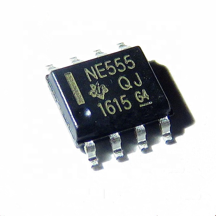

NE555 Pin Out -
Pin 1
It is the ground pin directly connected to the negative rail. It should not be connected using a resistor, because all the semiconductors inside the IC will heat up due to stray voltage accumulating in it.
Pin 2
It is the Trigger pin to activate the IC’s timing cycle. It is generally low signal pin and the timer is triggered when voltage on this pin is below one third of the supply voltage. The trigger pin is connected to the Inverting input of the comparator inside the IC and accepts negative signals. The current required for triggering is 0.5 uA for a period of 0.1uS.The triggering voltage maybe 1.67 V if the supply voltage is 5V and 5 V if the supply voltage is 15V. The triggering circuit inside the IC is too sensitive so that the IC will show false triggering due to noise in the surroundings. It requires a pull up connection to avoid false triggering.
Pin 3
It is the output pin. When the IC triggers via pin 2, the output pin goes high depending on the duration of the timing cycle. It can either sink or source current which is at maximum 200mA. For logic zero output, it is sinking current with voltage slightly greater than zero. For logic high output, it is sourcing current with the output voltage slightly lesser than Vcc.
Pin 4
It is the reset pin. It should be connected to the positive rail to work the IC properly. When this pin is grounded, the IC will stop working. The reset voltage required for this pin should be 0.7 volts at a current of 0.1mA.
Pin 5
Control pin – The 2/3 supply voltage point on the terminal voltage divider is brought to the control pin. It requires to be connected to an external DC signal to modify the timing cycle. When not in use, it should be connected to the ground through a 0.01uF capacitor; otherwise the IC will show erratic responses
Pin 6
It is the Threshold pin. The timing cycle is completed when voltage on this pin is equal to or greater than two-third of Vcc. It is connected to the non inverting input of the upper comparator so that it accepts the positive going pulse to complete the timing cycle. Typical threshold current is 0.1 mA as in the case of Reset pin. The time width of this pulse should be equal or greater than 0.1uS.
Pin 7
Discharge pin. It provides a discharge path for the timing capacitor through the collector of the NPN transistor, to which it is connected. The maximum allowable discharging current should be less than 50 mA otherwise...
