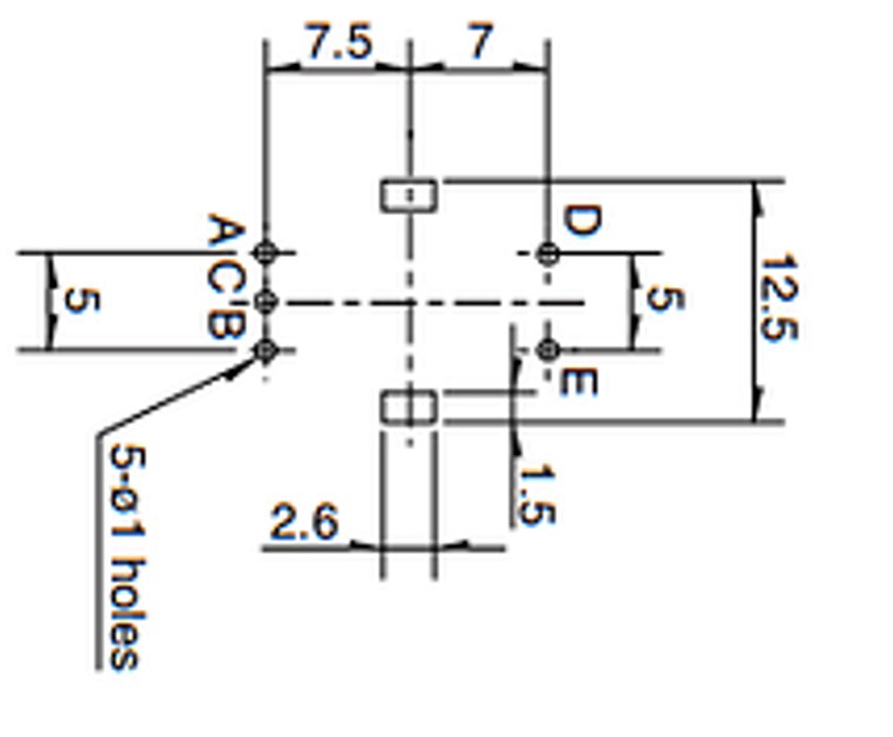

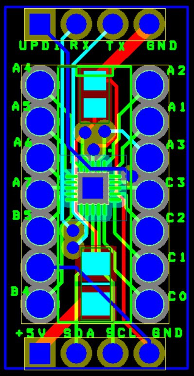

Hope everyone likes this example of using the KY-40 encoder shield with the Attiny3226 microcontroller, still working on making the footprint :
A4 and A2 will be for the encoder inputs, and its GND pin to pin 6.  B5 and
C2 will take care of the pushbutton pins from the encoder.
This board pictured directly above will 'plug-in' to the matrix carrier board pictured above this.
                    9/27/22,  encoder carrier boards came in from JLCpcb, and looks like I need a gnd
