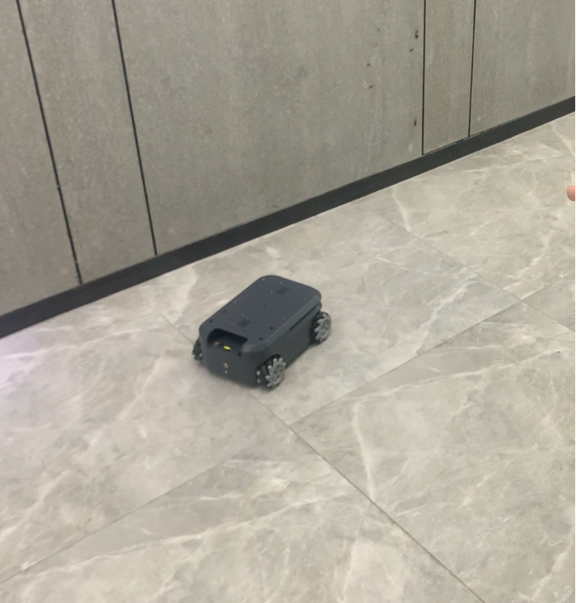

1 myAGV:
myAGV is an autonomous navigation smart vehicle from Elephant Robotics. It uses the competition-level Mecanum wheels and a full wrap design with a metal frame. There are two built-in slam algorithms to meet the learning of mapping and navigation directions.

Place the myAGV on a level surface.
The launch file will start the odometer and IMU sensor of myAGV.
Enter the command in the terminal
roslaunch myagv_odometry myagv_active.launch
After turning on the odometer and IMU sensors, we then turn on the radar and gmapping algorithms to start the map creation.
Enter the command in the terminal:
roslaunch myagv_navigation myagv_slam_laser.launch
This is the page we just started, then we move myAGV and we can draw the map out. To control myAGV movement, Elephant Robotics gives us keyboard control.

roslaunch myagv_navigation navigation_active.launch
Use keyboard control to make myAGV rotate in place for positioning. After the positioning is completed and the point cloud converges, proceed to the next navigation step.
Click "2D Nav Goal" on the top, click the point on the map you want to reach, and myAGV will set off towards the target point. You can also see a planned path of myAGV between the starting point and the target point in RVIZ, and myAGV will move along the route to the target point.
