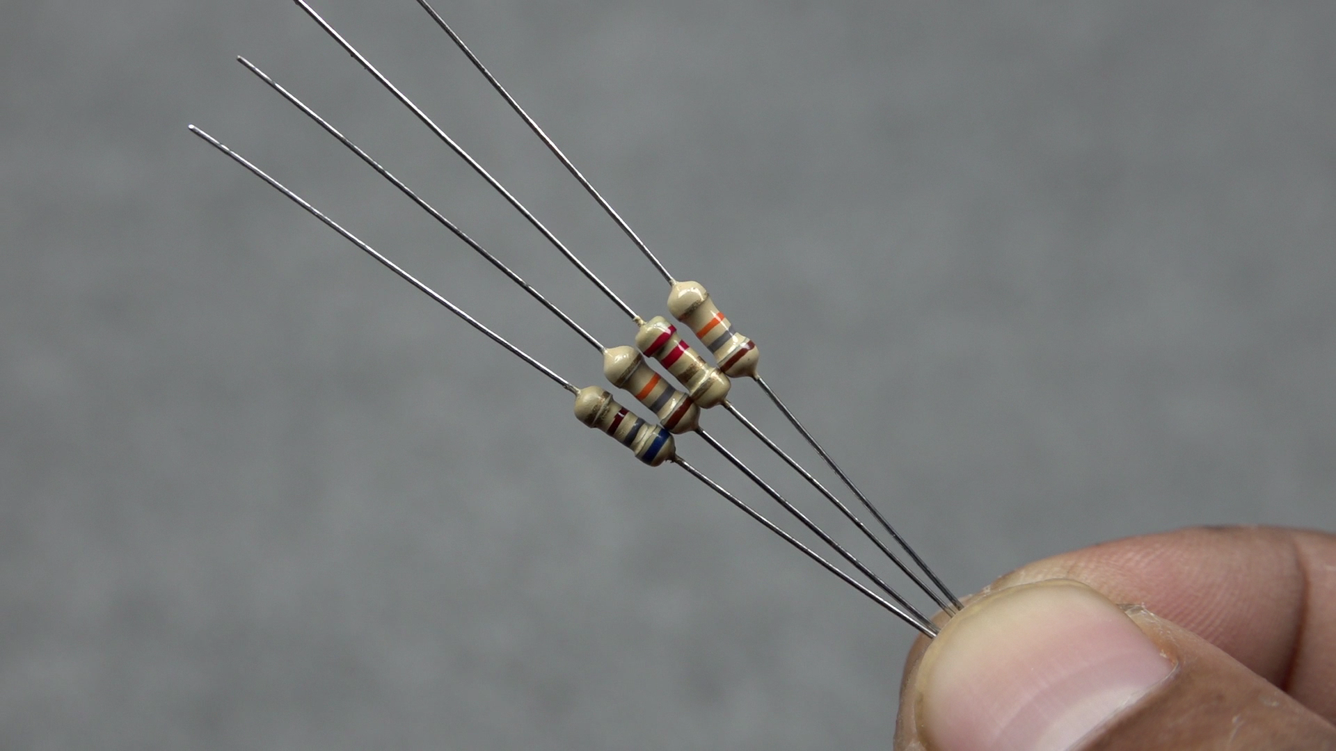

• Resistor – 18 K Ω*2, 2.2 Ω, 680 Ω

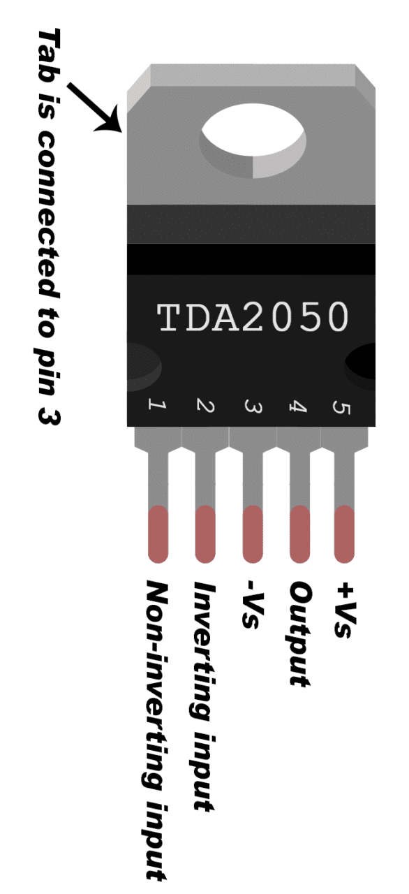

• Non – Inverting Input
• Inverting Input
• Ground
• Output
• Supply Voltage

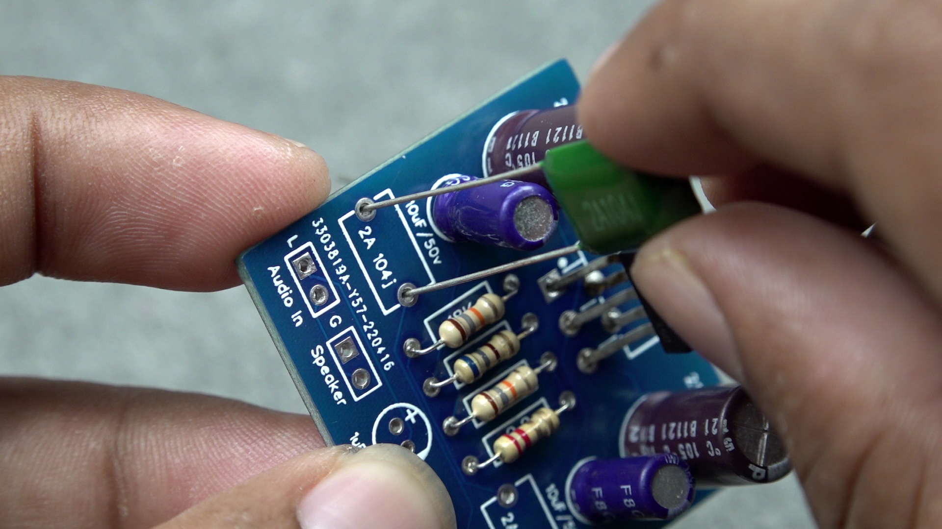

Connect Resistor with the Circuit -
To make this mono amplifier circuit, 1st we connect resistor with the circuit. We connect 18 KΩ resistor with 1 no leg of this sound IC. Then connect 680 Ω resistor with 2 no of this sound IC and again 18 KΩ resistor with 4no leg of sound IC and it’s other terminal with 2no leg of Sound IC.
We also connect 2.2 Ω resistor with 4 no leg of sound IC. Our all resistor connection is complete.
Connect Capacitor with the Circuit -
Now we connect 1µf / 50v capacitor positive leg with 1no leg of sound IC. Then connect 10µf / 50v capacitor positive leg with 680 Ω resistor and another 10µf / 50v capacitor positive leg with 2.2 Ω resistor. We connect one piece polyester film capacitor with 200µf / 25v capacitor. Then connect it’s negative terminal with 3no leg of sound IC.
Again we connect another polyester film capacitor with 220µf / 25v capacitor. Then connect it’s positive terminal with 5no leg of sound IC.
