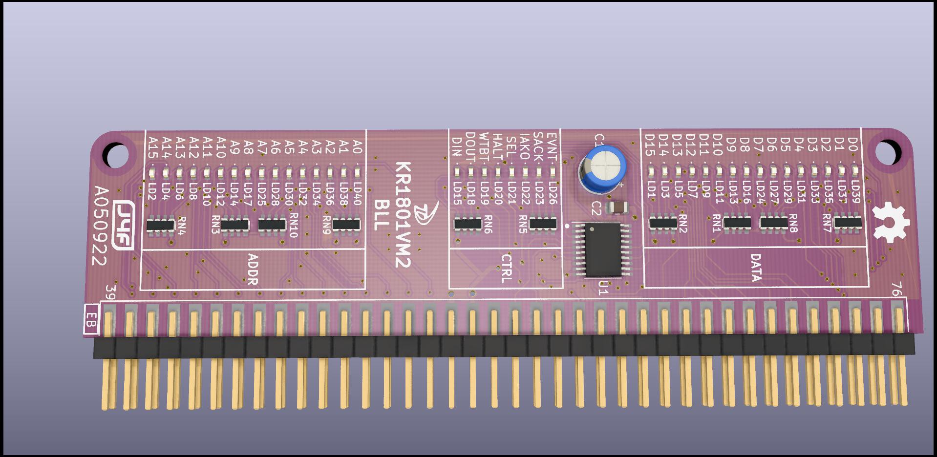

* * KR1801VM2 BLINKING LEDS (BLL) BOARD * *
Certainly could not miss a board with blinking leds, so I did the KR1801VM2 Blinking Leds (BLL).
The Z80 KR1801VM2 Blinking Leds (BLL) board allows "to see" the status of the bus with some leds. Bot the 16 bit Address...
