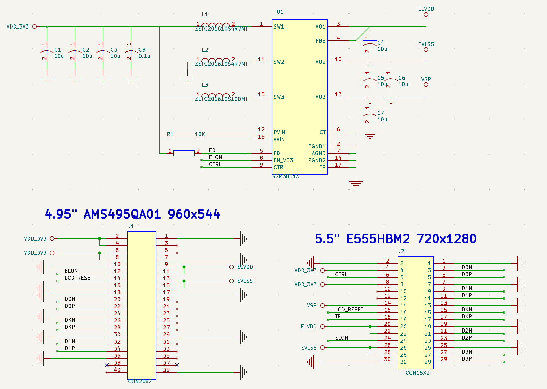

    I designed two OLED screen sockets on the same adaptor board, one is 4.95" AMS495QA01 960x544 and the other is 5.5" E555HBM2 720x1280, which use the same OLED power chip.

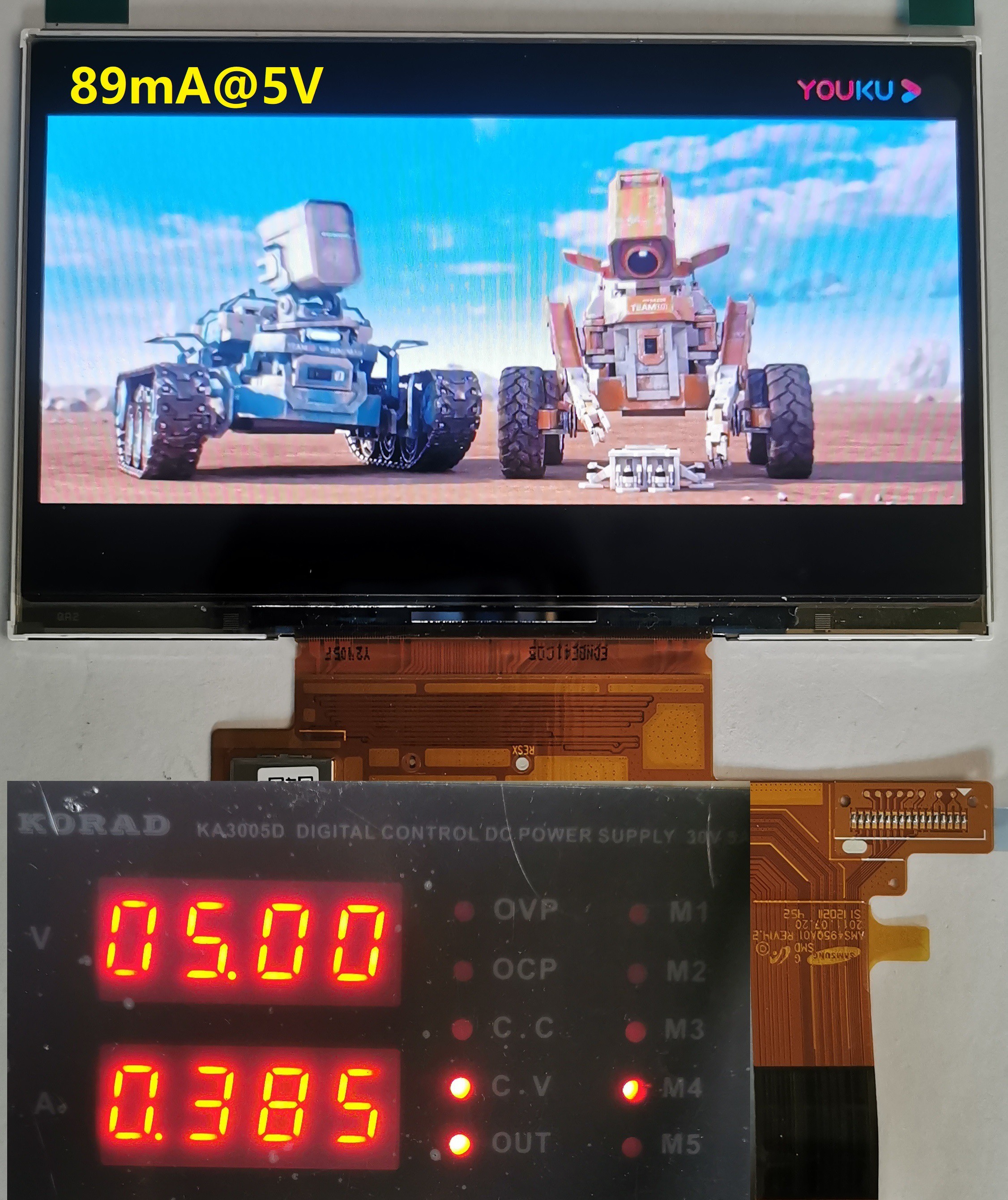

  • The PSV1000 screen AMS495QA01 960x544 is OK
    ElecLab12/28/2025 at 09:19 0 comments
    Another oled is also OK. The PSV1000 screen AMS495QA01 960x544 is set with the highest contrast ratio. The power consumption of this screen is relatively low. It only needs two voltages of ELVDD ELVSS, which is the same as the E555HBM2 voltage value, and is driven by the same SGM8351A power chip.
    AMS495QA01 video playback current is still low on a non-white background.

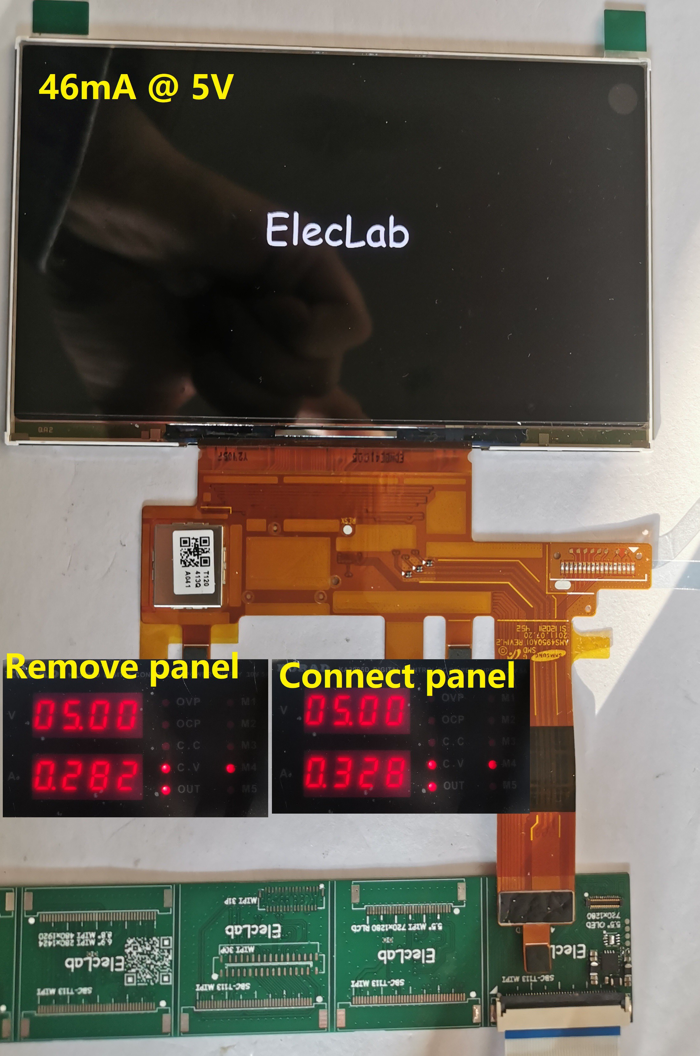

  • The 5.55" AMOLED of E555HBM2 720x1280 has been tested.
    ElecLab12/28/2025 at 04:16 0 comments
    The 5.55" AMOLED of E555HBM2 720x1280 has been tested. Now the contrast ratio is set at 50%, and the power consumption of all white is still very large. The conversion board uses 3.3V. If the contrast ratio is 100%, it will lower 3.3V. The power consumption of the screen is recorded.

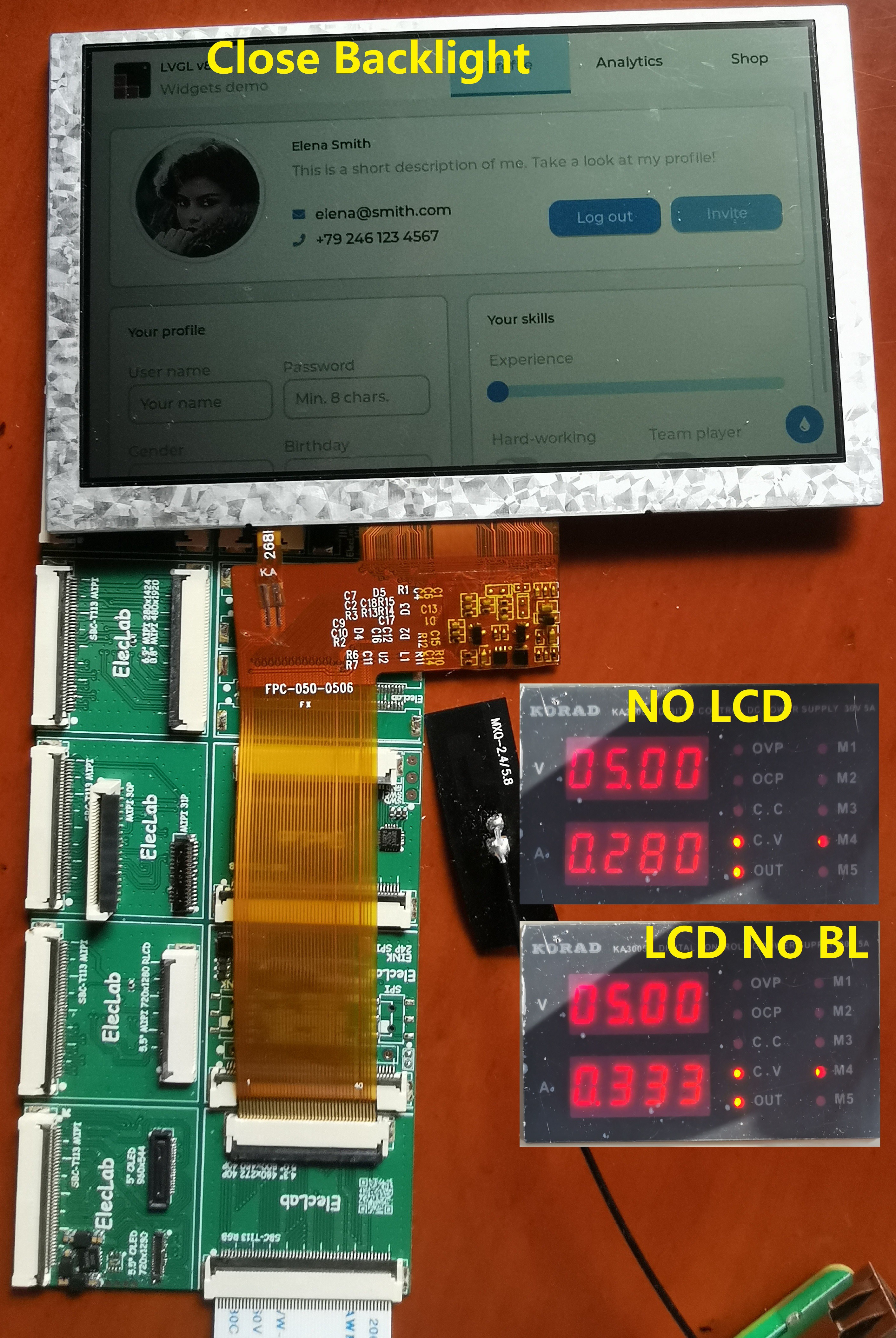

    5 RGB expansion boards and 5 MIPI expansion boards are designed to externally reflect LCD screen/AMOLED/QSPI screen/MCU screen/24P Eink screen.
    10 display expansion boards have been designed for SBC-T113,
     5 kinds of 50P RGB expansion boards
     1. 40P RGB888 socket (such as 4.3" 480x272/800x480, 5.0" 480x272/800x480/1024x600, 5.0" 800x480 semi-reflective screen)
     2. 24P spi Eink socket (can be XH2.54 led out, or it can be QSPI function), using the special DBI function of T113.
     3. 40P SPI+RGB666+6P capacitive touch screen socket (use $0.07 Cortex-M0 to initialize spi, support a variety of sizes and resolutions of LCD screens, and this kind of 40P LCD can integrate capacitive touch screen)
     4. 30P/40P MCU 16bit socket (40P with TE foot with tear-proof function, and also supports more specifications of LCD screens)
     5. 24P QSPI LCD screen socket (supports 1.8" 360x360 TFT round LCD screen, 2.13" 410x502 AMOLED square LCD screen)
     5 kinds of 40P MIPI expansion boards
     1. 30P/40P AMOLED socket (5.5" 720x1280 AMOLED, 5" 960x544 AMOLED)
     2. 30P RLCD socket (5.5" 720x1280 full reflection LCD screen)
     3. 30P/31P MIPI socket
     4. 40P MIPI socket (supports 8.8" 480x1920 HSD088IPW1-A, 6.9" 280x1424 MIPI screen)
     5. 40P MIPI socket (supports 8" 800x1280, 10.1" 800x1280 LCD screen)
