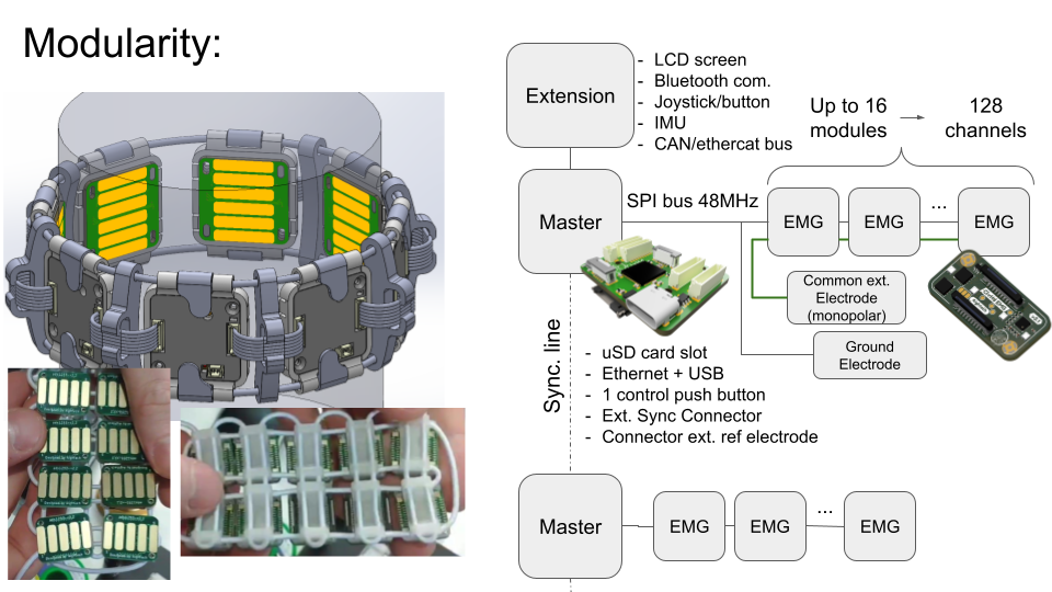

The system is composed of a controller module and a set of HMI modules.
Controller module
The controller module is the core of the system. It is responsible for the communication between the HMI modules and the computer. It is based on a microcontroller (Teensy 4.1) and a communication module (ESP32). The controller module is equipped with a USB, ethernet and WiFi interface, which allows the user to easily connect the system to a computer. The controller module is also equipped with a microSD card, which allows the user to store the data locally.
HMI modules
The HMI modules are responsible for the bio-signal acquisition and the real-time feedback. The HMI modules are themeseleves composed of several sub-modules, which can be easily connected to each other:
  • Communication module: This sub-module is responsible for handling the communication between the different modules of the controller.
  • Sensor module: This sub-module is responsible for acquiring the signals (EMG, ECG, EEG, IMU, etc.).
  • Feedback module: This sub-module is responsible for providing a real-time feedback to the user (vibration, LED, Electro-stimulation, etc.).
  • Electrode module: This sub-module is responsible for providing the interface between the sensor module and the user (electrodes, accelerometers, etc.).
  • Interface module: This sub-module is responsible for extending the electrode module with additional features (Jack connector, flexible PCB, etc.).

Modular architecture
The system uses a shared bus architecture, which allows the user to easily add or remove modules to adapt the system to...

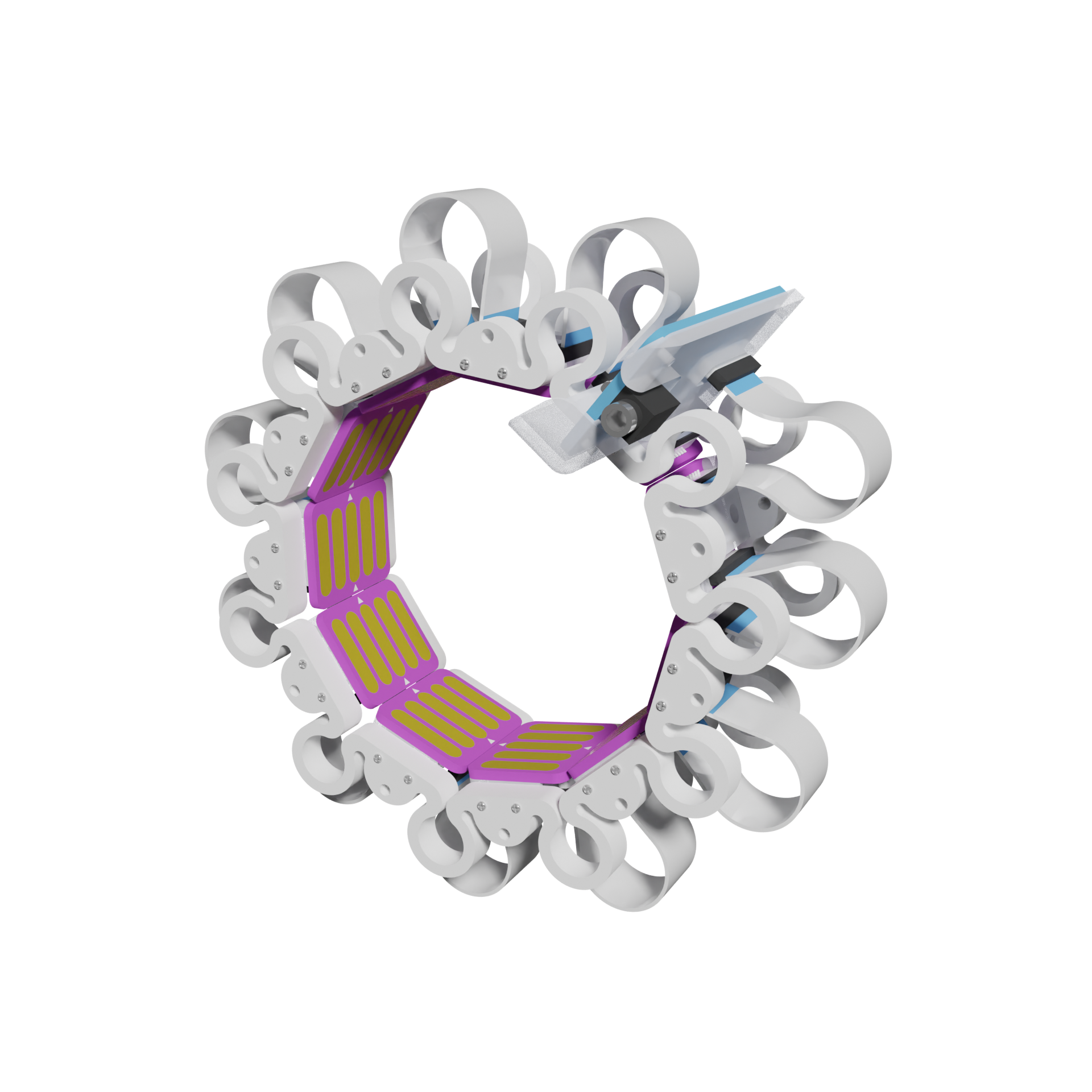

    Here is the most recent form factor I am testing. It comprises a total of 11 modules, which results in 55 individual electrodes.
    I use this opportunity to learn how to make some rendering on blender :D
    Here the final result. I used FDM printing and flexible filament for the white curly band and I used SLA printing and transparent resin for the small protective case of each module.
