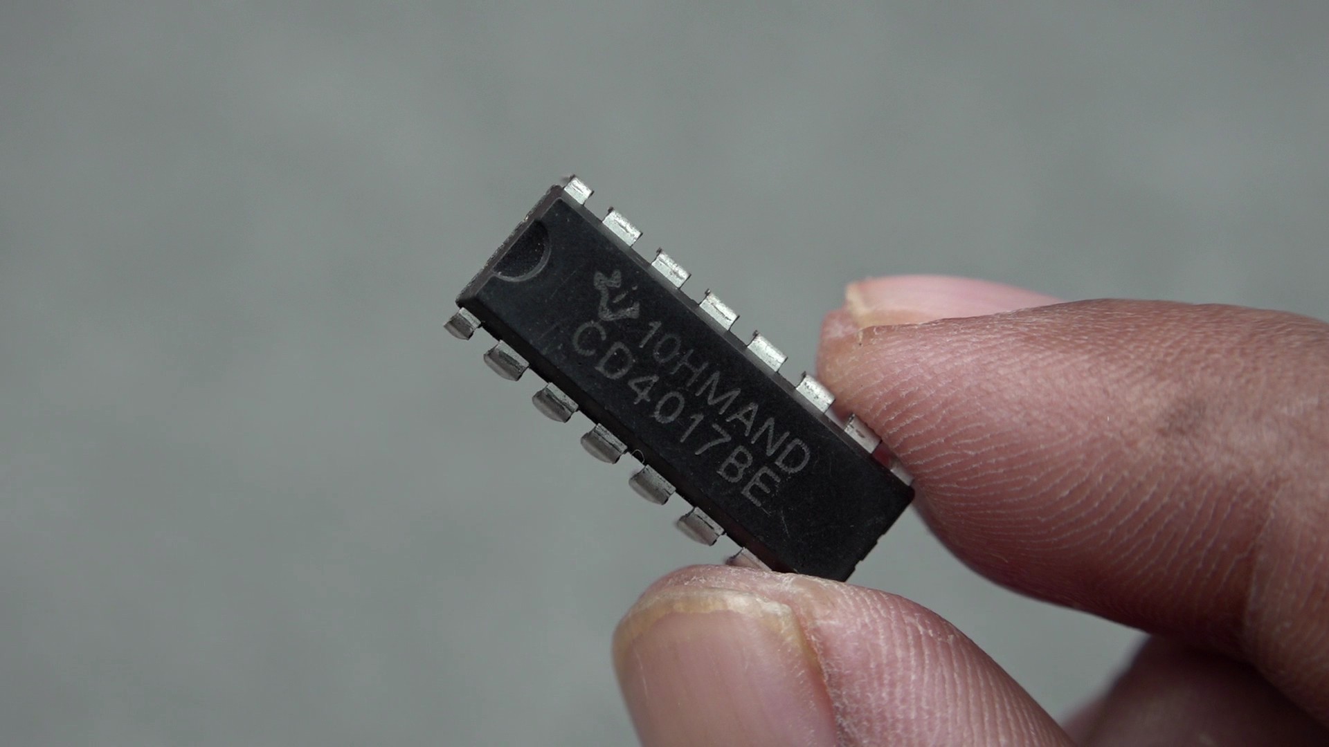

  2. IC – CD 4017 BE

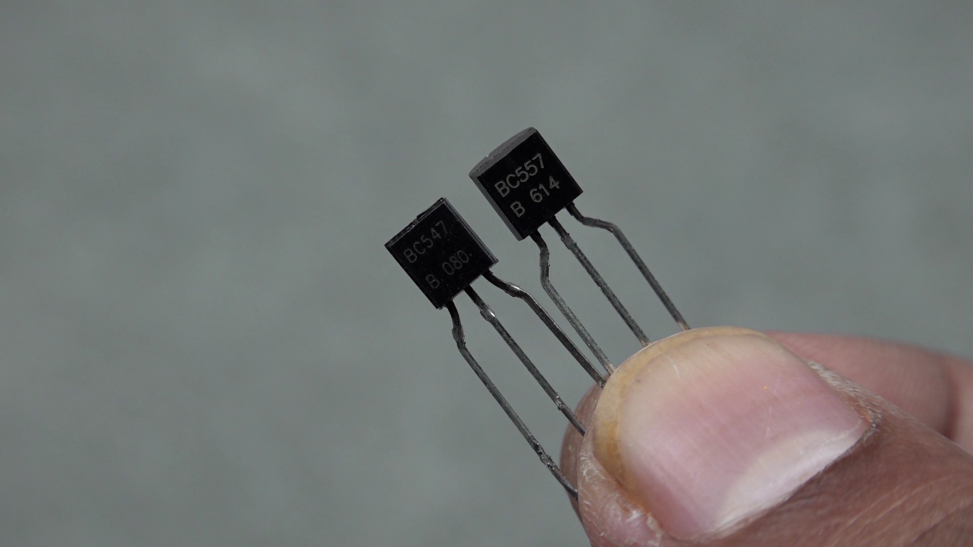

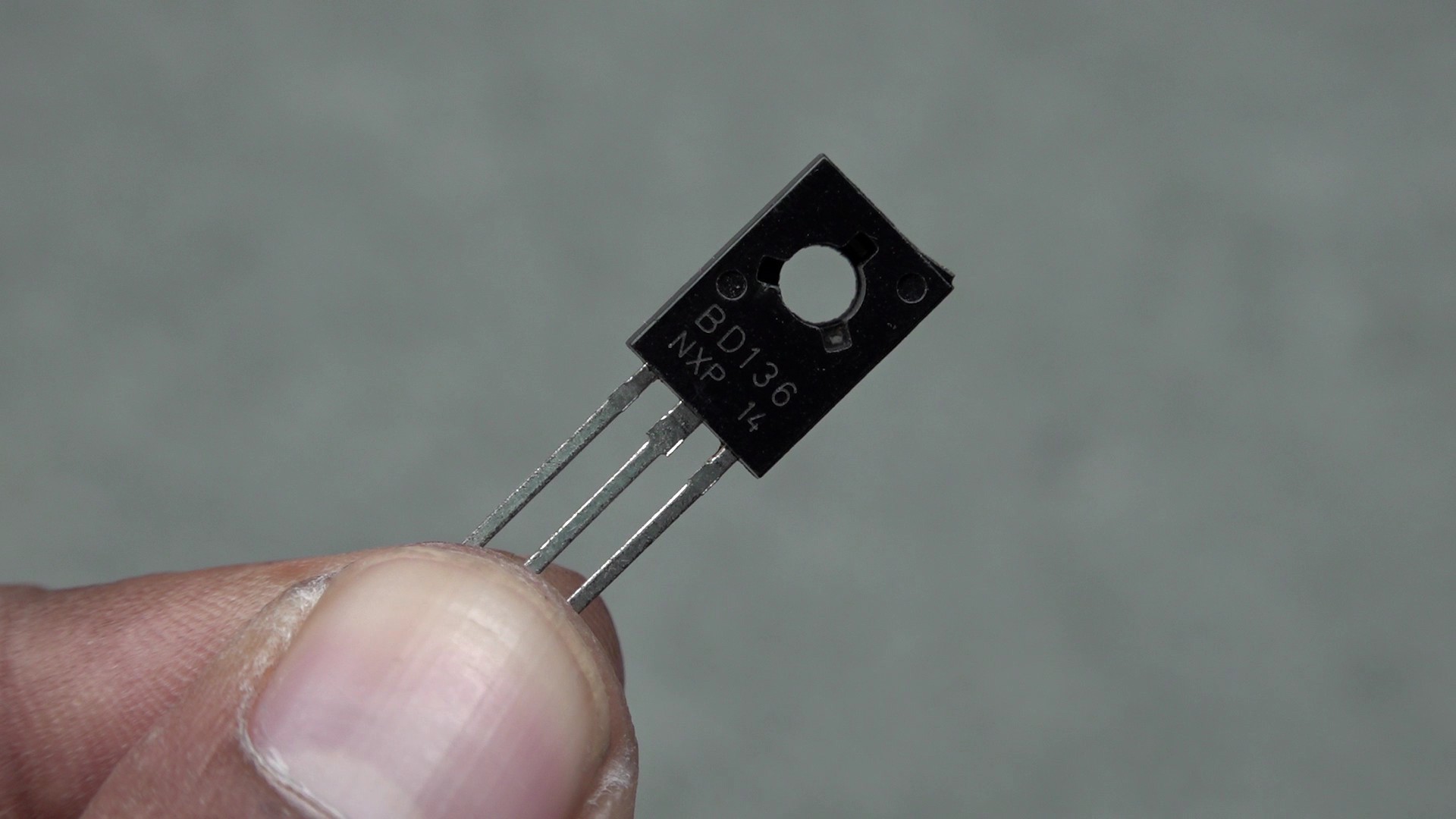

  3. Transistor – BD136, BC547, BC557

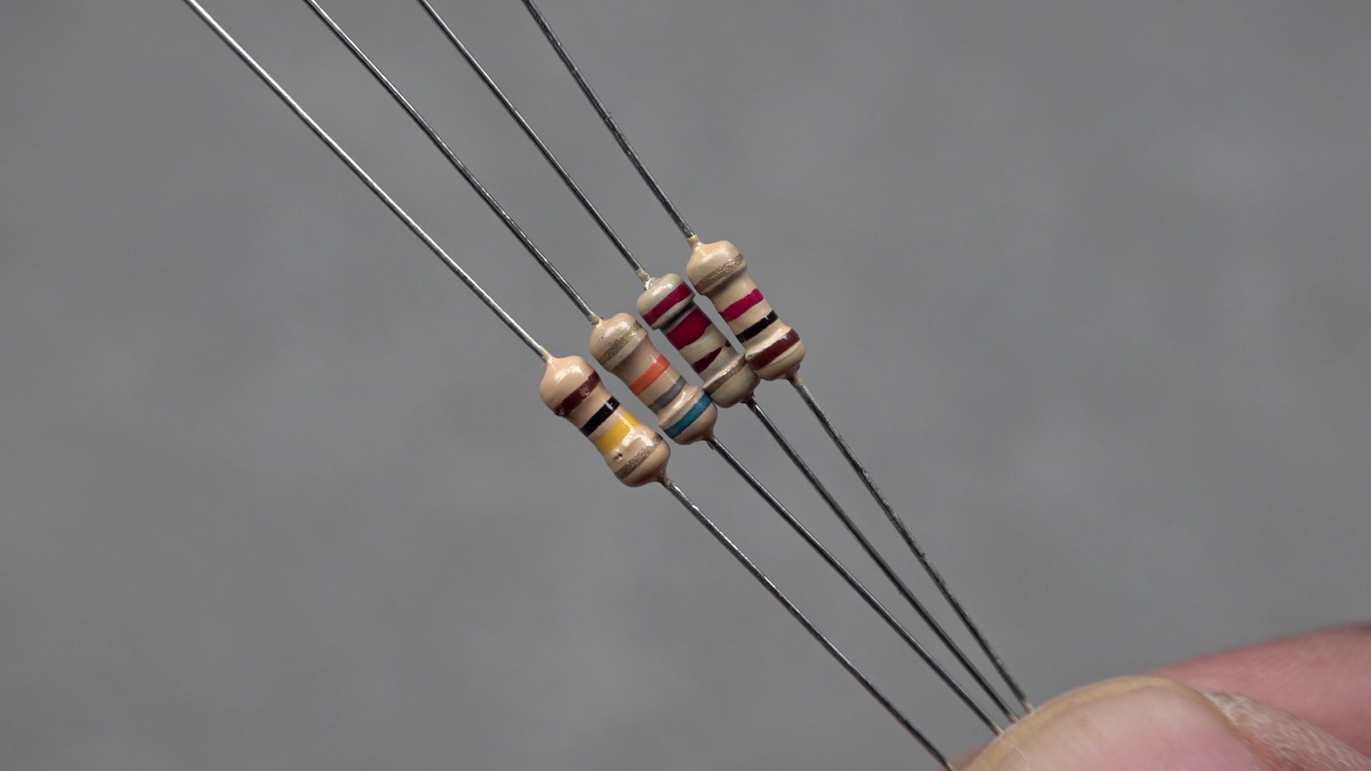

  5. Resistor – 1KΩ, 220 Ω, 68KΩ, 100kΩ

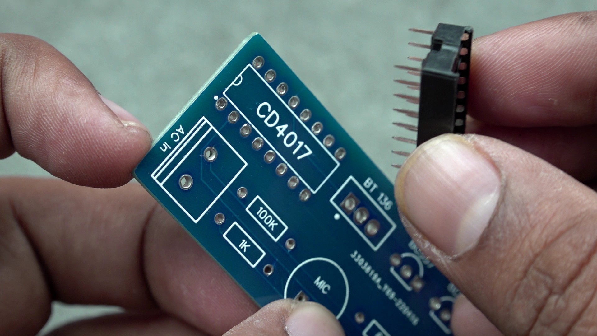

Schematics and PCB Design -
The schematics of PCBs can be seen above.
Feature of CD4017 -
• High speed 16 pin CMOS Decade counter
• Supports 10 decoded outputs
• Wide supply voltage range from 3V to 15V, typically +5V
• TTL compatible
• Maximum Clock Frequency: 5.5Mhz
• Available in 16-pin PDIP, GDIP, PDSO packages
Application of CD4017 -
• Used in LED matrix, LED chaser and other LED projects
• Binary counter or Binary decoder
• Can be used for divide by N counting
• Remote metering, automotive, medical electronics

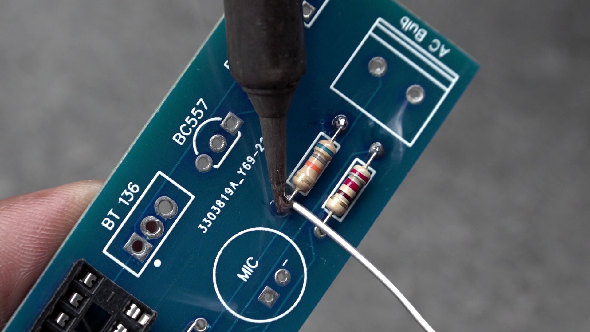

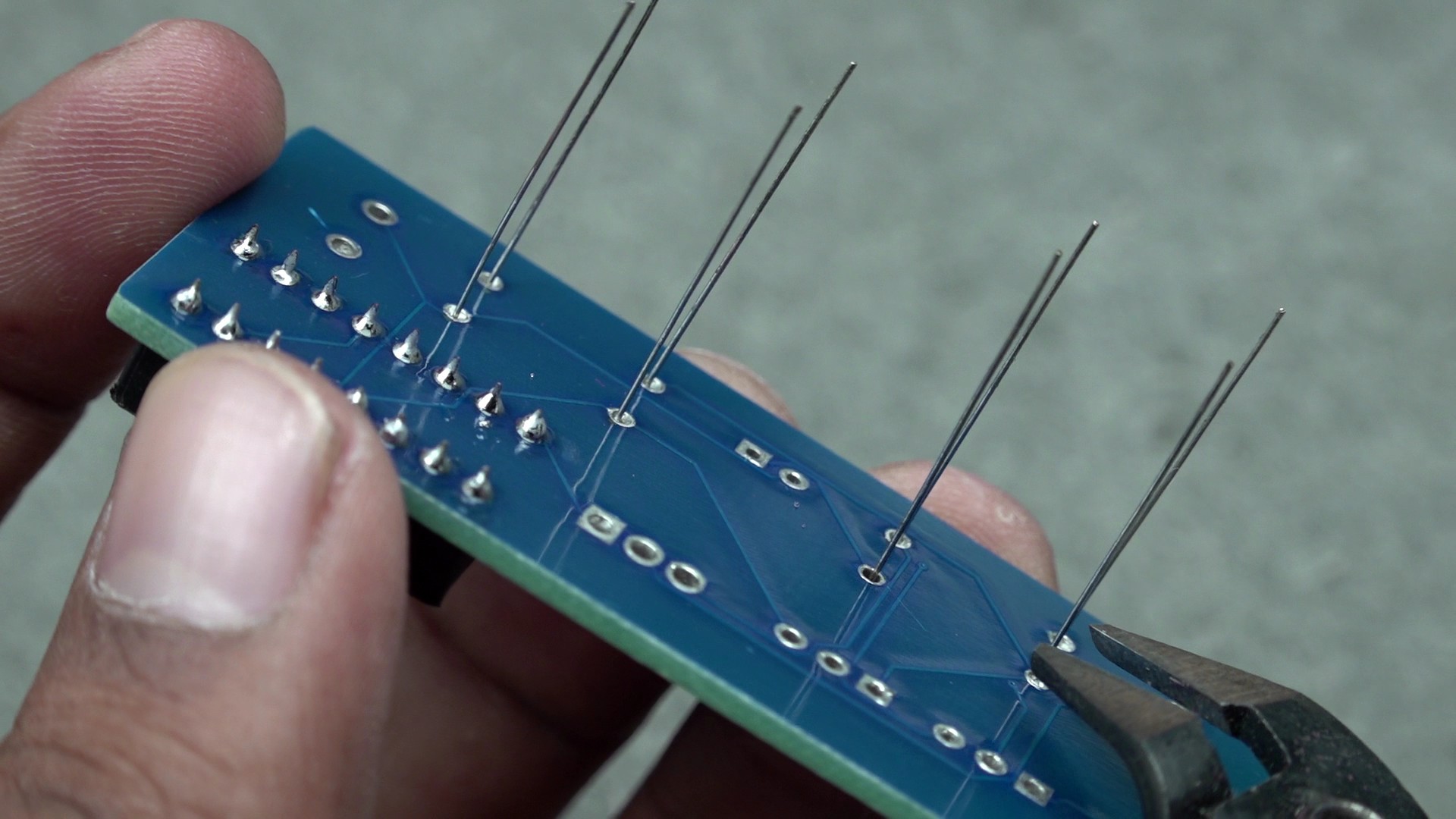

Circuit Connection – Step 1

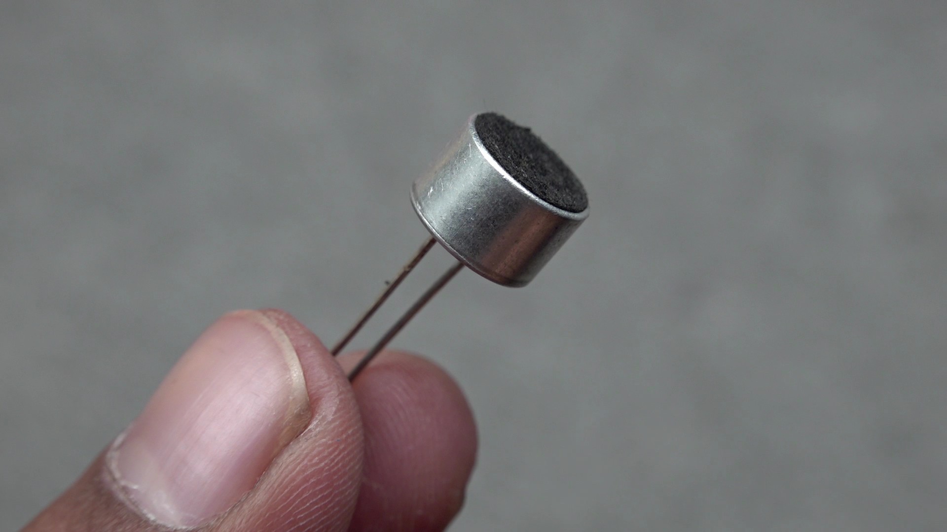

To make this music reactive circuit, we connect BC547 transistor collector leg with Base leg of BC557 transistor. Then we connect BC547 transistor base leg with positive leg of Mic and connect BC547 transistor emitter leg with negative leg of Mic.
Now we need to connect 68 KΩ resistor with emitter leg of BC557 transistor and connect 1 KΩ resistor with base leg and emitter leg of BC557 transistor. Then connect 100 KΩ resistor with emitter leg of BC547 transistor and collector leg of BC557.
Circuit Connection – Step 2

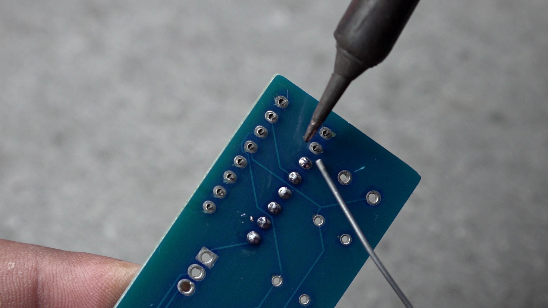

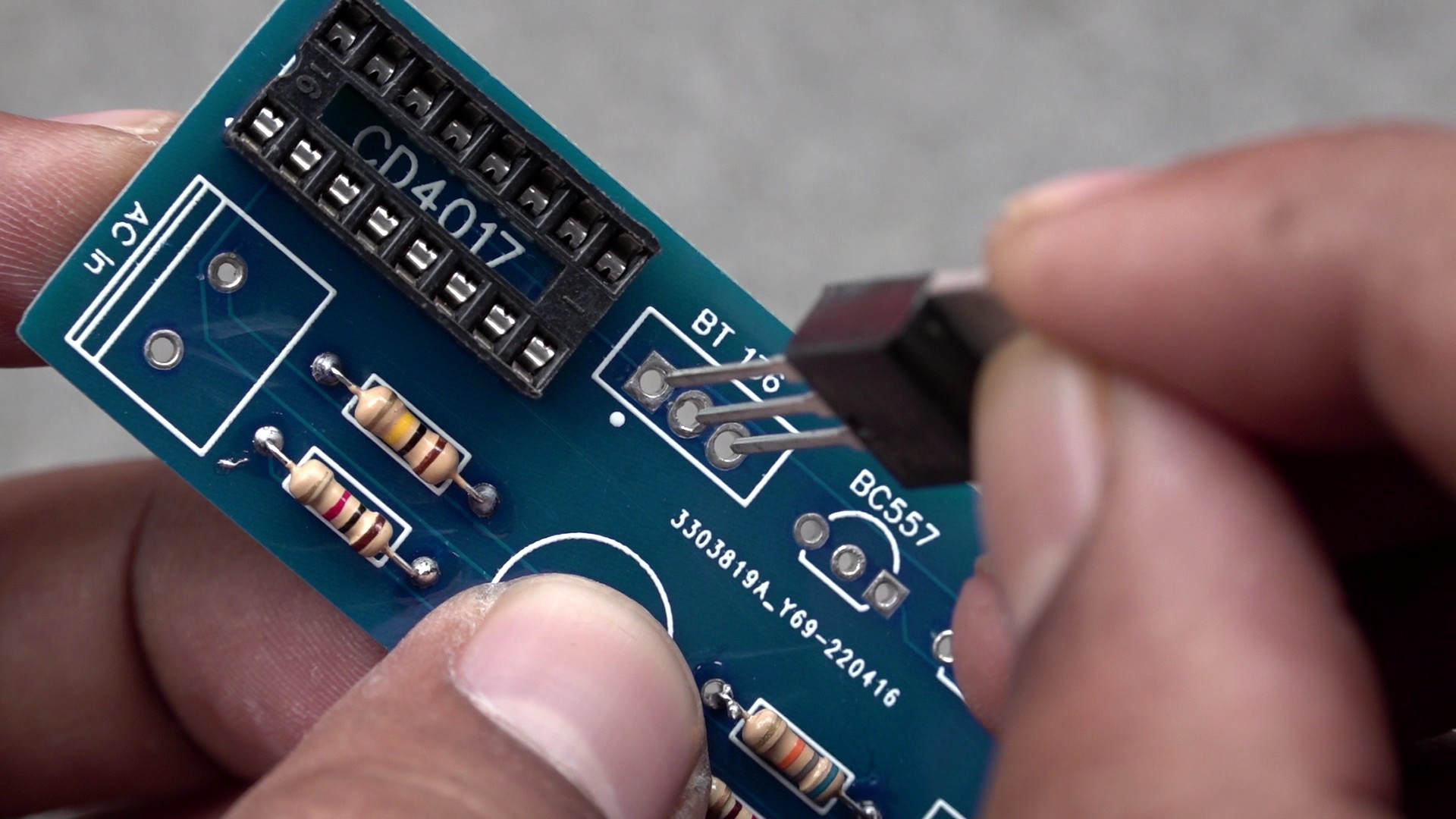

This time we need to connect BC557 transistor collector leg with 14 leg of CD-4017 IC and connect 4no and 15no leg of CD-4017 IC.
It is time to connect CD-4017 IC 13no leg with emitter leg of BC547 transistor. We also need to connect 13no and 8no leg of CD-4017 IC.

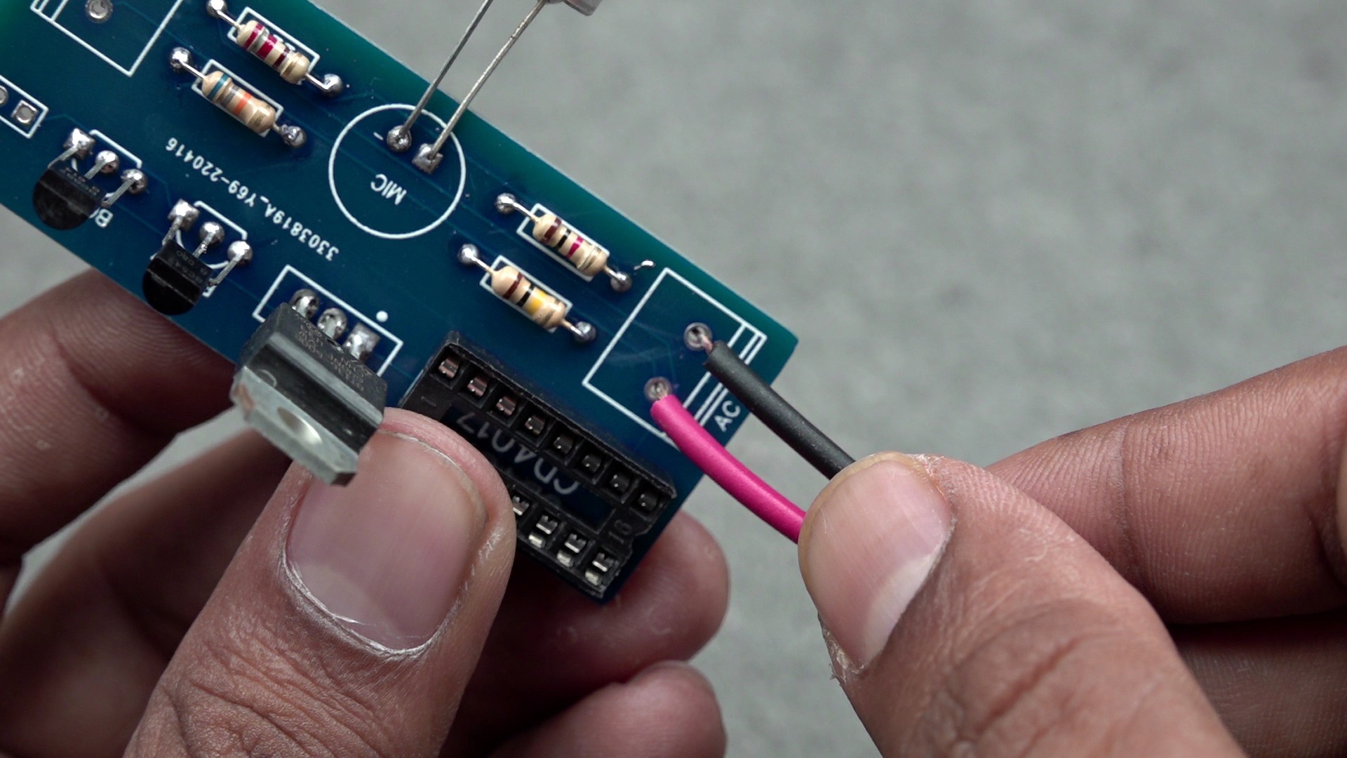

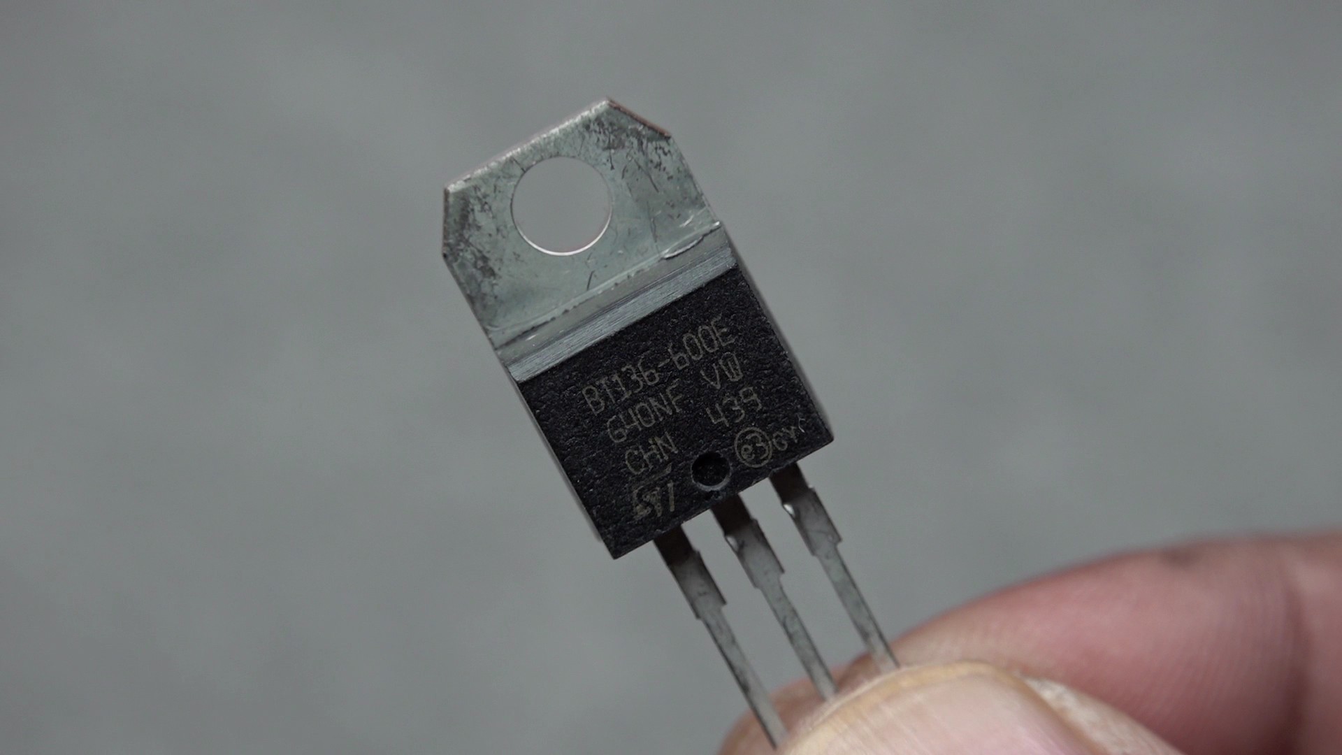

Our circuit is now completely ready for use. Now need to connect a Triac with the circuit. Connect triac “T1” terminal with 8no leg of CD-4017 IC.
Circuit Connection – Step 3

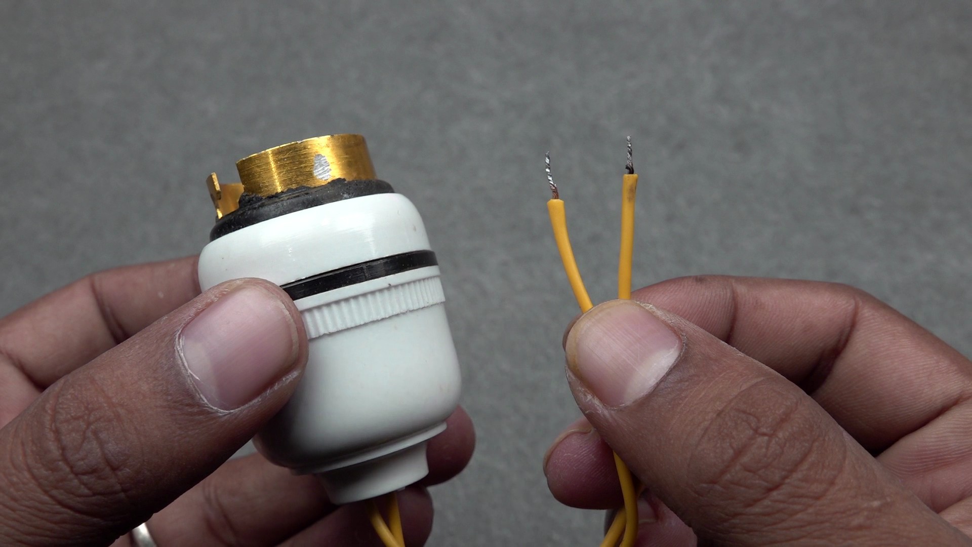

Now we need to connect a 220 Ω resistor with the circuit. We connect this resistor with 2no leg of CD-4017 IC and connect its other terminal with “G” terminal of triac. Since it is an AC bulb music active circuit, for that we need to connect an AC bulb with the circuit.
Connect AC bulb one terminal with “T2” terminal of triac and AC bulb other terminal with 220 volt AC line. Then connect AC voltage other terminal with 8no leg of CD-4017 IC. Now need to connect DC-9v power supply with the circuit. We connect DC-9v positive cable with “Emitter” leg of BC557 transistor and DC-9v negative cable with 13no leg CD-4017 IC.

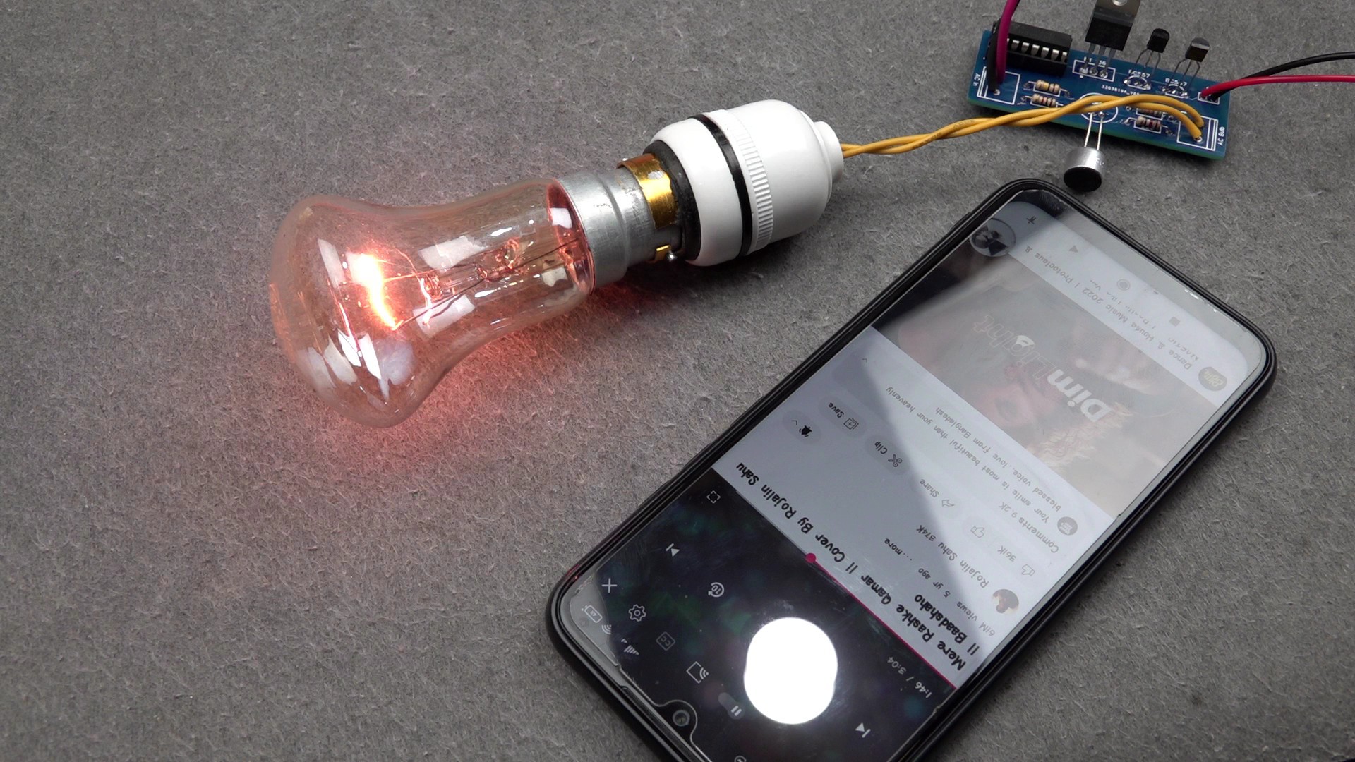

Now just, plug-in power and put Mic beside the sound system and connect AC bulb with the holder. Enjoy the effect of music reactive light circuit.
