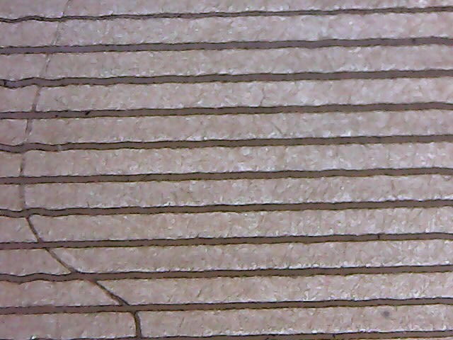

My laser cutter makes ragged edges on simple cuts, so I decided to look into the issue in detail using scientific inquiry. The experiments are detailed below.
I found that the air assist compressor "puffing" causes the irregular cuts shown, and adding an air tank inline smoothed out the puffing and fixed the problem.
Ragged edges on straight cuts

After much experimentation, I determined that the "puffing" of the air assist pump was causing the ragged edge.
The fix was to install a tank inline with the air assist to smooth out the air puffs. The before/after images show that this completely solves the ragged edge problems.

    After appearing on the HAD blog, someone IM'd me and suggested to check how snugly the lens was seated and... It was a loose lens!
    The lens retaining ring had come loose, and slowly unscrewed itself down the lens tube so that the lens was simply laying on top of the ring. Individual pulses of air caused the lens to jump up, changing the focus and the cut width!
    The retaining ring was waaaay down the tube - more than 10 turns away from snug.

    The makerspace cutter does not have the same problems, or at least doesn't have the problem to the same degree.
    Comparing the same cut profile from the makerspace cutter (top image, below) shows relatively smooth cuts, not the ragged edge of my laser cutter (bottom image, below).
    As further evidence, prior experience I know that the edges of an acrylic piece should be polished and smooth. Comparing the cut edges of a 6mm piece of acrylic from the makerspace (top image, below) with mine (bottom image) shows in stark contrast that it's definitely a problem with my machine.
