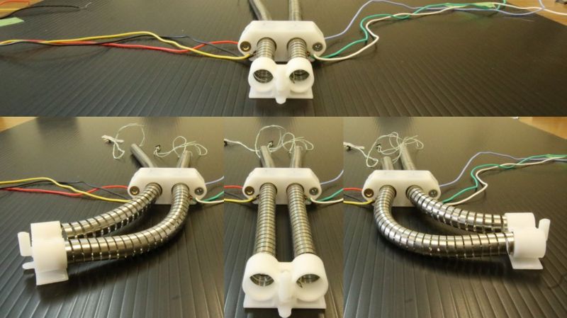

Linear Voice Coil actuators/motors:
These work just like the speakers, and since they have "voice coils" in the name, I can assume these are used for super ultra loud speakers.
Electromagnetic linear motors:
These are the equivalent of a brushless electric motor, I think.
But still, these are heavy and quite solid, if you were to use these as electromagnetic actuators, you could easily position it, but they wouldn't be safer to be around.
You could use malleable materials, like the copper wire by itself (also called as "air core coil") covered in heating dissipating silicon rubber, for example. But at the cost of efficiency, since the metal core is there for a reason.
Just like this post on Hackaday, where they used metal springs and a stator to move it around.
Even so, these are in my number 2 of "favourite" options. Specially since you could both use the pulling force and the pushing force on the opposite sides of the part you're trying to actuate. "Number 2" because I would need to wire everything by myself.
The problem is that I don't know how strong they are or how much I would need to increase its size and power consumption in order to lift a certain amount of weight (let's say, 1kg).
