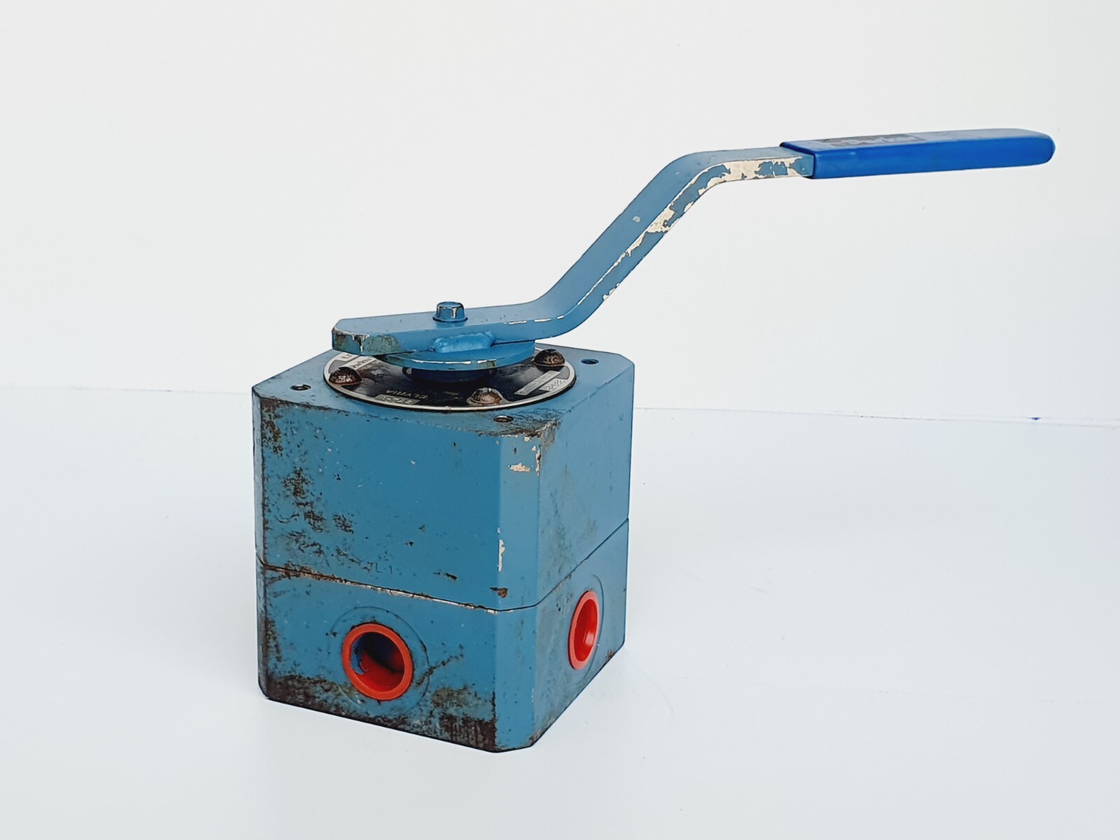

Well, I was thinking on how I would make an hydraulic pump that could change the fluid flow depending in which direction it works, but I couldn't think on anything but gear pumps, and actually, I think hydraulic gear pumps aren't meant for this kind of job.
I would either need a complicated (and expensive) direction control valve or a servo ball-valve in which the direction of flow would change on how much one turns the valve:
However, I'm still not satisfied.
