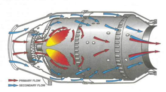

I even thought on using a micro turbine engine with a high speed alternator, which would be way lighter, but these aren't cheap, easy to make, nor efficient.
This one is a 8 kilowatt microturbine generator, I literally cannot find anything like that online, but taking into consideration that turbine engines uses titanium alloys and/or inconel alloys, it definitely ain't cheap.

Turbine engines, more specifically, the turbine blade of the engine uses Inconel, a superalloy, in order to survive the high temperatures, but the combustion chamber faces the highest temperatures and only uses conventional steel materials.
The material is still able to survive due to an air layer that it produces, after all, air is a terrible heat conductor.
You could use this to make a magnetohydrodynamic furnace reach incredible high temperatures without destroying the whole thing, after all, the plasma gas don't necessarily needs to touch the walls to generate energy, only to pass through the electric fields.
But the problem of miniaturization still persists.
