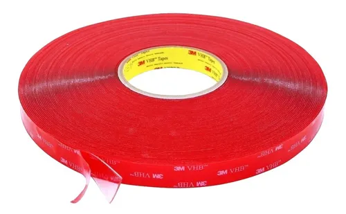

Anyway, I do need to figure out how to mass-produce the inner bladder, although I can buy kilograms of plastic tube, it would still be preferable to handmake those instead of buying, it will be expensive enough to buy the required equipment for the pump and electric motor.
This one costs 57 dollars or 250 reais (without the taxes).
Actually, I think I'm just overthinking the inner bladder thingie, I could "just" extrude it just like the filaments for the braided sleeve.

By the way, the article says it uses VHB 4910 elastomer tape and 5 to 7 Kilovolts, such as in the image below:
