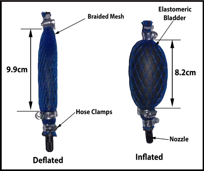

I also don't know if other shapes could work, for example, the McKibben muscle works in a similar way with the braided mesh, but they also use linear meshes. If the linear meshes are viable, then would them work in the fiber 3D printed DEA?
Restricted DEA with a braided mesh:
McKibben muscle with a similar mesh:
McKibben muscle with linear mesh:
Would any of these work with the fibrous 3d printed DEA?
If this was to work, then it woud way easier to make the actuator in a mass-produced manner, and it would probably be possible to make it smaller than 1mm.

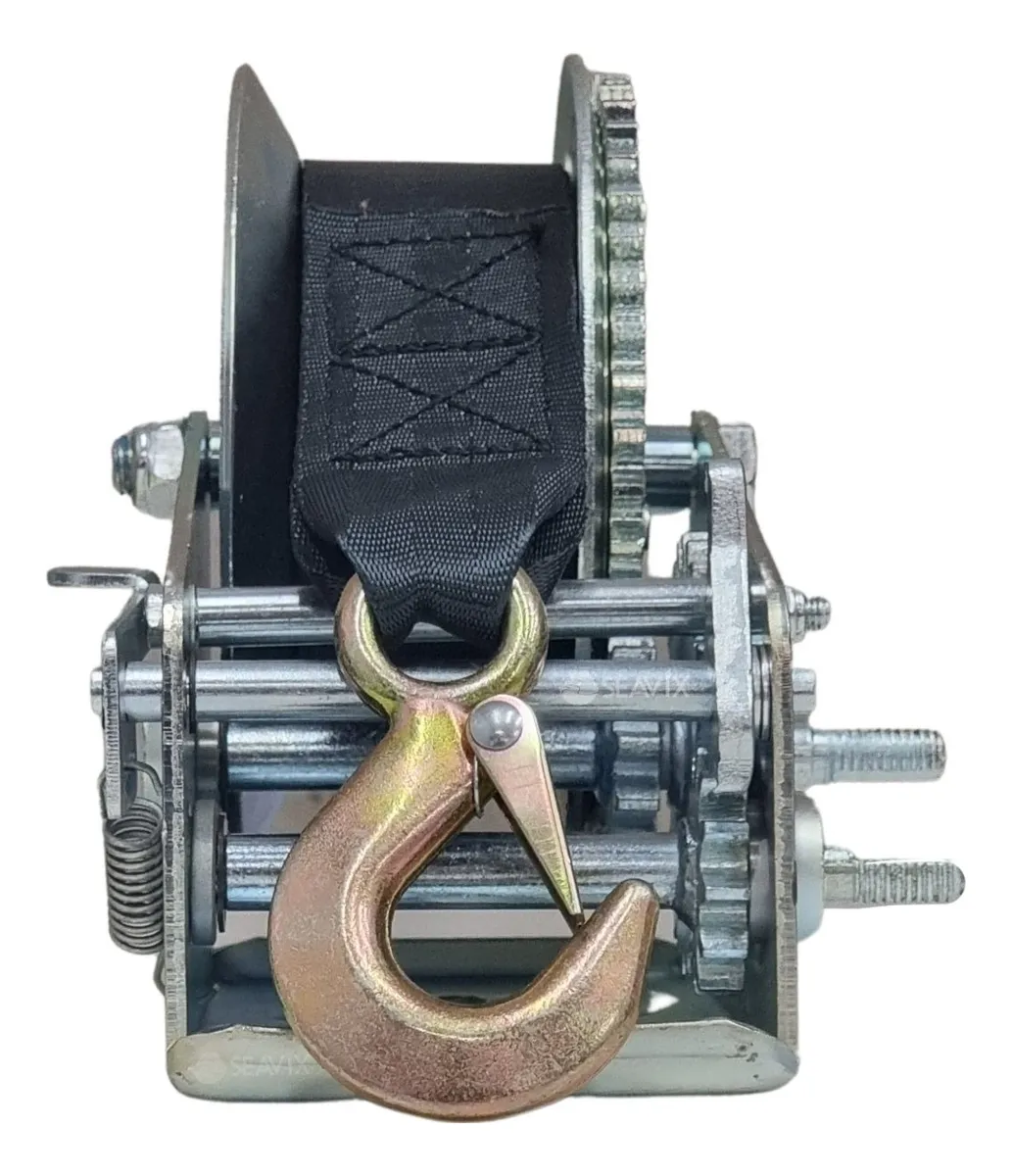

Well, this is me from the future, and I finally went to check the price of mechanical/electromagnetic brakes and winches with the lifting capacity closer to the intended input force (3000kg), and guess what?
It is too expensive and heavy. :|
With the exception being the manual winch brakes, which would need to be modified for higher load and also for the insertion of a encoder:

It just occurred to me that I could just make cylinders actuated by the HASEL/DEA actuators instead of a biomimetic mess that would be harder to build and maintain…
That is a way of doing that alright. Obviously I’m not gonna do this way, but you get the ide
