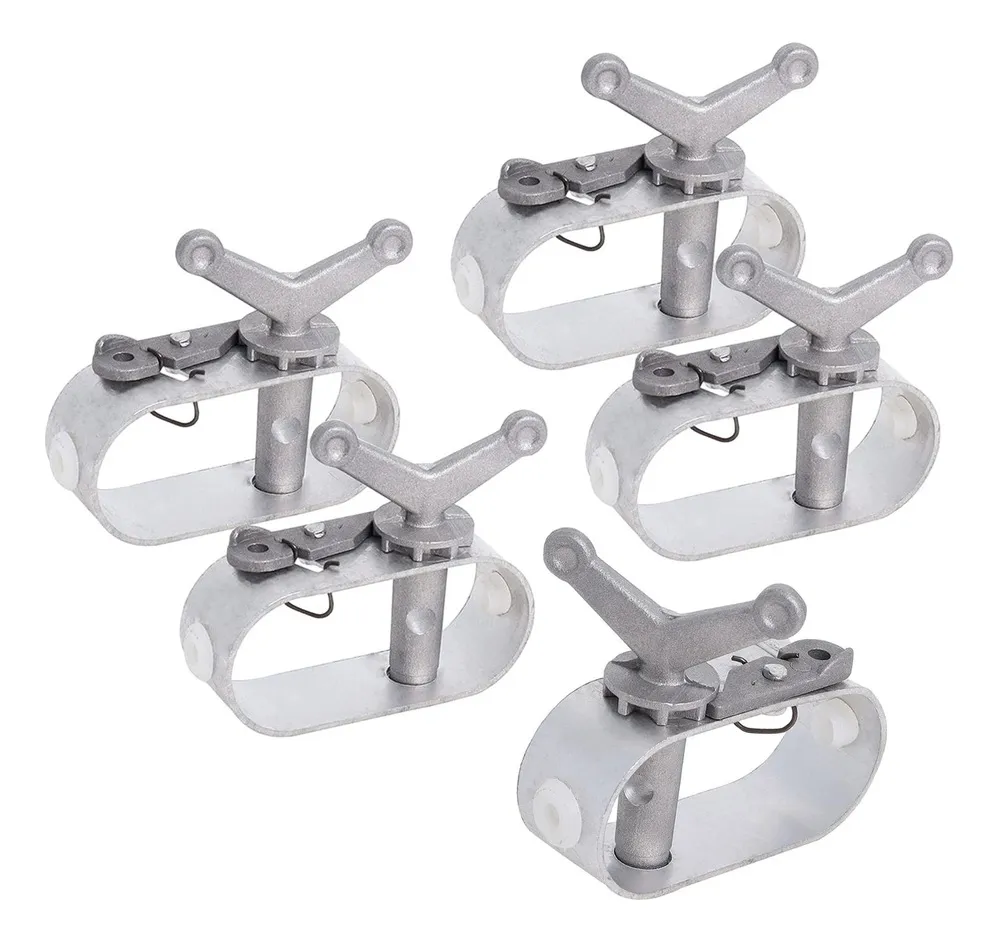

That being said, there are many, many ways of making screwless fasteners, a few examples:
- Hydraulic collet chuck/internal diameter clamp: ETP HYDRO-GRIP COMPACT - Hydraulic high precision toolholder Dine DHE Hydraulic Expansion Chuck - Cutwel TV (this one uses a screw to compress the hydraulic fluid, but you could do the same with a lever instead)
- Toggle latch: CL-100-LSPC Locking Push Pull Toggle clamp Toggle Latch Clamp Heavy Duty Self Lock For Cabinet Boxes Heavy Duty Type Toggle Latch
- Not a toggle latch/clamp, but that can work as one if you change it: On-load release hook RM RB 02 (prototype)
- Quick Change Fasteners: Quick Change Fasteners for Machine & Fixture Changeover | IMAO
