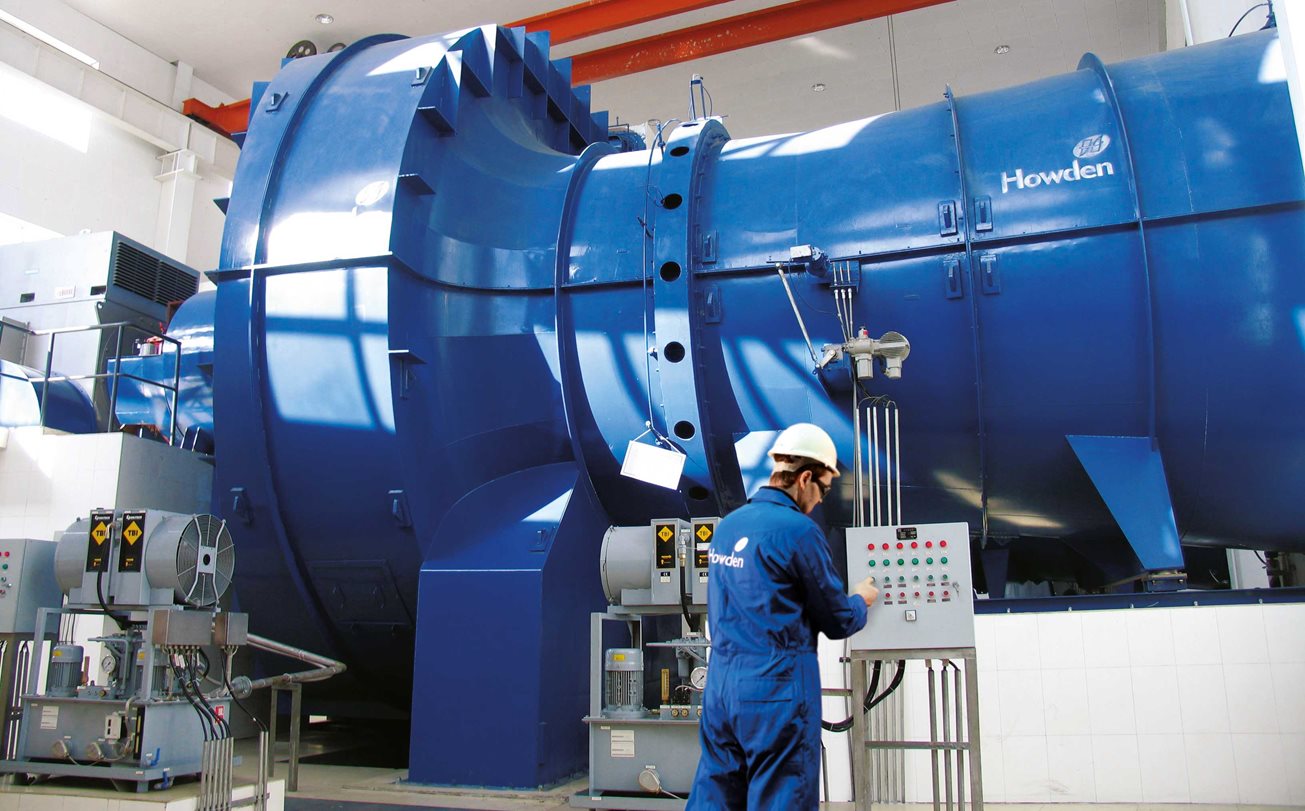

All of the principles mentioned so far can be somewhat applied to the pneumatic system, the difference is that these work with lower compression ratios because unlike liquids, air is compressible. So no matter the pressure you work with, it will always have the same air flow, the difference is that you need to find a balance between pressure and volume of the actuators.
Another problem with pneumatic systems is that the faster the compression, the higher the heat loss, thus, the lower the efficiency.
You can circumvent that by:
- Using multiple stage compressors, compressing the air slowly.
- Using heat exchangers that use the air intake flow to cool down the compressed air in the system, not letting the heat leave the system, and thus, increasing efficiency. But that maintains the system efficiency, not the compressor’s efficiency. You still need to compensate for the heat loss with more air.
Of course, that is assuming piston/diaphragm compressors. I don’t know how axial/centrifugal compressors should work.

Even though it is doable, how the hell will I transport 138,960,000 liters per minute of air without a gigantic windmill?!
50,000,000 CFM
This one has 1 million CFM Source: Axial fans | Chart Industries
I mean, I know that you don’t actually need to move 50 million CFM, only that you need a certain amount of air to move at that speed. But how do you convert liters per minute of fluid flow to meter second?
