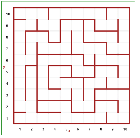

4Read Maze Map using a Dry Run
Now that the whole concept is clear, let us begin with the steps on reading and storing the Path Map to the cloud -
- There are 2 cases when it should stop reading the map, and follow other commands - 1. When there is a loop, the robot may infinitely keep looping within the loop. To avoid this case, a part of the application will send a change in methodology to come out of the loop. 2. When the robot reaches the starting point, it should turn halt, and wait for next commands
- When trying the build a maze solver, there is a concept of - Left Hand Rule & Right Hand Rule.
- The story maze, it is said that - Any maze that has a starting and ending point, the one thing that connects both apart from the path, is the side walls. Let us understand - 1. Walking through a maze, while placing right hand on right side wall. 2. Without any 2nd thoughts, take every right turn that comes while going ahead. 3. Eventually, we shall reach the end of maze.
- Let us take the above example. We shall put our robot on the START point and find the number of steps till it reaches the END point. Notation used - F = Forward, L = Left, R = Right, UF = Backward, U = U Turn
- If the robot is based on LHR - FLFFUFLFFFLFUFLFRFLFUFLF If the robot is based on RHR - FLFRFRFLFLFRFFRF From above example, we find out the RHR is much better for this path map.
- You might have noticed we have taken right turns in LHR and vice versa. It is necessary in the cases, when there is no other path (right or forward).
- Now that we know how to read movements, let us further put it in detail using rotary encoder. The goal is to have a string somewhat like below text - F5-L-F5-F5-U-F5-L-F10-F5-F5-L-F5-U-F25-L-F10-R-F2-L-F5-U-F5-L-F3
- The purpose is to convert the above text into turtle's drawing mechanism and visualize a custom map on the Web Application.

5Shortest path between location X & Y
In a maze, for locomotion from one point to another, there are more than one way to reach the spot. But the question is, which is the shortest path to reach the spot? A maze consists of 90º sharp turns. So, we shall consider that, and find a logic to find the shortest path, using a simple algorithm.
- We have noticed earlier, what the path(text) for the LFR looks like. For a robot based on LHR - FLFFUFLFFFLFUFLFRFLFUFLF
- But this path is not the shortest path for the robot, since taking the extra turns utilize more time. By avoiding the extra roads that need not be taken, we would ultimately find the shortest path to move from Start to End.
- There is a method to calculate, which is to avoid and remove the below abstracts from any path(text). This removal need to be done repeatedly, even on the result after one cycle. Abstracts - LFUFR = UF LFUFF = R LFUFRF = UF FUFL = R FUFF = UF LFUFLF = F
- For example for - FLFFUFLFFFLFUFLFRFLFUFLF Above, after the first trial of removing abstracts - FLFRFFFFRFF
- Now, we can use the data of distance to cover in shortest time. Make sure the total distance for forward is taken into account. For example, if the forwards are 10, 5, 5, 10 before any turn or end. Such instances are FFFFR and RFF.
- We shall insert the forward with total distance in this case - F10-F5-F5-F10-R, In this case, we shall put the total, i.e. 10+5+5+10 = 30. Finally, we shall have FLFRFRF.
- In terms of distance, it is - F5-L-F5-R-F30-R-F5

7Web Application to control LFR in Industry
Here, we first need to visualize a map using the existing Dry Run path text. Later, use the data to find the shortest path. This can be done using the already mentioned method, or we can provide value to each edges and nodes, and later use Dijkstra’s algorithm to find the shortest path.
- In case you aren't aware, in a previous project I have created a visual map of a floor on Web Page using simple HTML, CSS and JS. Check that out here.
- For this project, what we need to focus on is to have an application, that can accept path commands, and it should create a map on the application.
- The important part here is, to have an interactive map that should have buttons on nodes and edges.
- These buttons shall allow the robot to set it's default starting position, and the ending destination.
- Refer to the below image of a sneak peak of the end results -
- Each box in the above map is a node. And the path represents the Line that the LFR follows.
- When the (1x,1y) box is pressed, it is selected as a pick-up point (A), and then it allows us to click another box (3x,5y) as the drop point (B)
