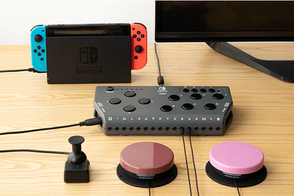

    The Hori Flex controller that recently arrived on the market is a similar aid that allow to play with assistive external devices on a Nintendo switch, for a  $249 cost.
    Horiflex
    The disadvantage of this solution is the compatibility with different joystick, only a few available on the assistive device market are compatible and work properly with the hori flex.
