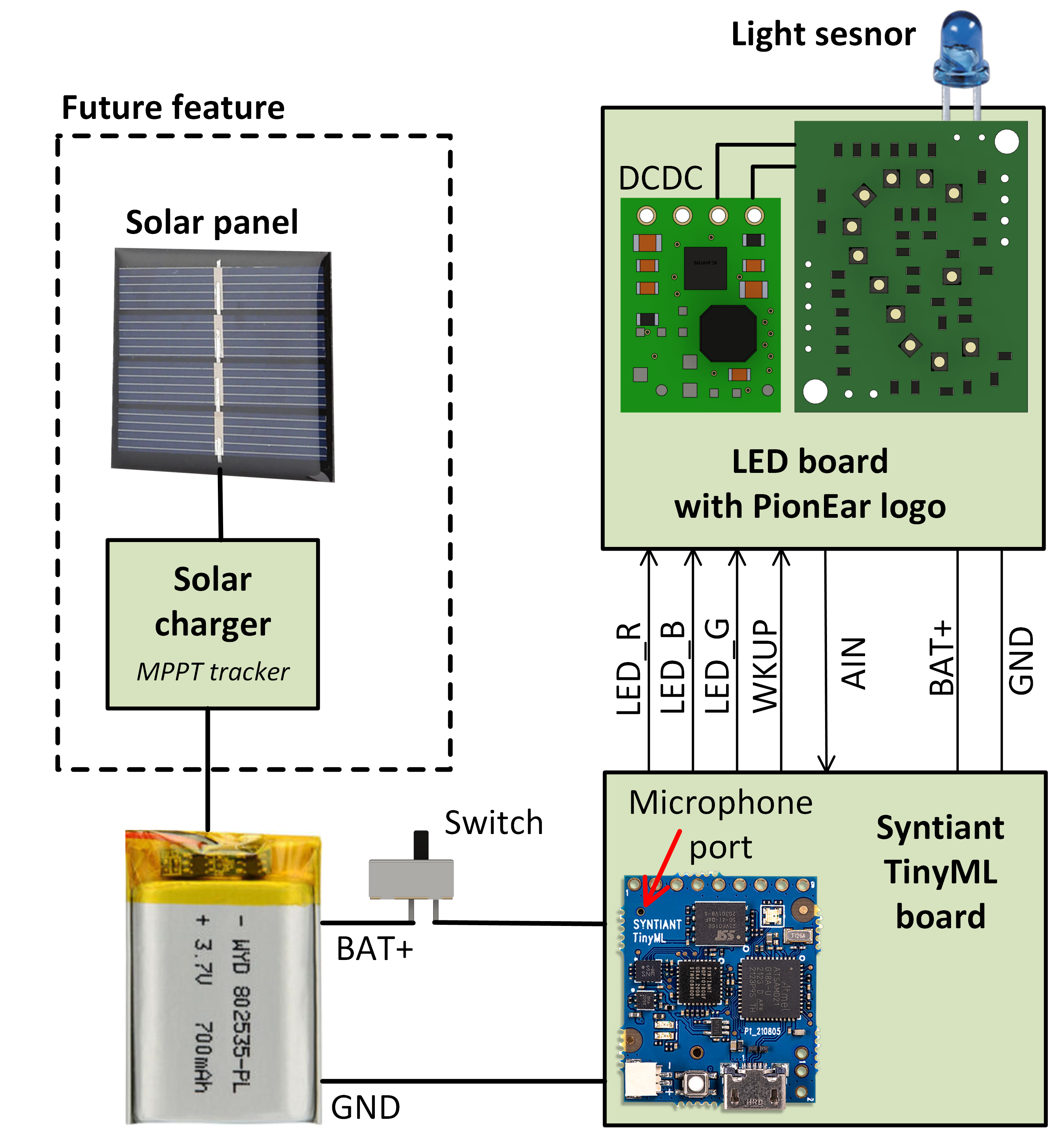

PionEar is a smart, small-sized sensor that helps alert hearing-impaired drivers in time to approaching emergency vehicles. It provides a bright visual alarm in the driver’s field of view, enhancing driving comfort and reducing the risk of an accident. The PionEar sensor utilizes artificial intelligence to analyze external sound patterns. It leverages Syntiant’s TinyML development board to run machine learning algorithms in an extremely energy-efficient manner. This design allows for the sensor to operate for extended periods without charging, or alternatively, it can be powered via a solar panel, eliminating the need for recharging altogether. Upon learning about the challenges deaf drivers face with emergency sirens, I reached out to the hearing-impaired community and discovered a positive demand for such a device. I aim to share this idea with the maker community and bring this device to real users.
The PionEar sensor concept is based on Syntiant TinyML board.  TinyML board is the ideal platform for building low-power voice, acoustic event detection (AED) and sensor ML applications. Equipped with the ultra-low-power Syntiant® NDP101 Neural Decision Processor, the TinyML board packs native neural network computation for the most demanding applications in the lowest power envelope.
The onboard microphone and BMI160 sensor enable easy configuration for any speech, AED or 6-axis motion-and vibration-related application. Trained models can be easily downloaded on the TinyML board through a micro USB connection without the need for any specialized hardware.
The below picture shows how the TinyML board is interfaced with other external circuitry. The external custom-designed PCB contains RGB LED for logo illumination, DC to DC power supply, and a phototransistor acting as a light sensor. The light sensor provides a signal (AIN) that is sensed by the TinyML board, which controls the brightness of the logo. This prevents the driver from being dazzled at night but enables good visibility in the daylight.
The high-temperature li-Pol battery cell (Zoncell LP602530T / 500mAh) is connected directly to the TinyML board battery connector. In parallel to the battery, a solar charger module AEMLION and solar panel IXOLAR SM101K07TF are connected as well. The whole system draws less than 2mA so the solar panel is able to deliver enough power to cover the power consumption of the system. This is valid in any daylight condition not necessarily in the sunlight. It is still possible to recharge the battery via a micro USB port which is present on TinyML Board.
I plan to reduce average current consumption even more by leveraging a motion sensor (MEMS accelerometer) and an additional MOSFET switch. It will sense if a car is moving – if not, it will cut off the power supply from the system. This feature aims to prevent battery discharge during periods when the car is idle and lacks adequate solar charging, such as nighttime or when parked in a garage. I'm confident that once this feature is in place, the PionEar sensor might operate without the need for any charging.
Fig. 1) PionEar sensor HW block diagram

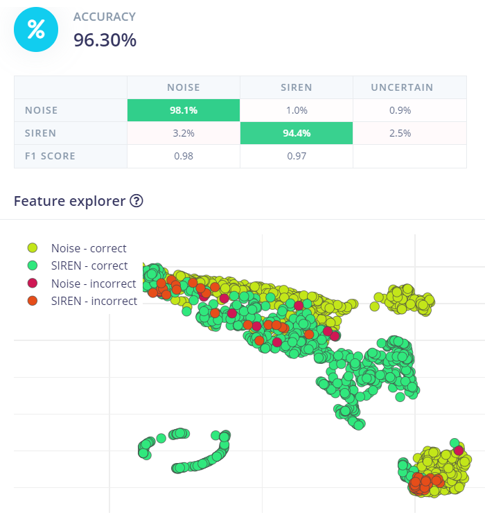

In order to deploy the machine learning model into a TinyML board the Edge Impulse platform can be preferably used. Edge Impulse provides easy to understand interface where you can create and manage your datasets, extract features, train ML models, test and finally deploy into numerous of supported hardware platforms. The TinyML board is fully supported so I have leveraged this advantage.
First, it is necessary to have a suitable dataset of emergency siren sounds and other road noises. One can find many public datasets – I have used sireNNet (license: CC BY 4.0) as a basis for my ML model. I have used other datasets of noises and speech to mix with the original dataset. My dataset including the ML model is publicly available on the Edge Impulse platform – you can find it here. I expect, that I will further evolve it as I will continue with the prototype testing.
I have already tested the latest ML model in real driving conditions. It can safely detect ambulance sirens and exhibits a low amount of false positives when exposed to road noises while driving. There are still some weak points for example music when listening to the radio in the car. However, music was not part of the dataset because I expect that hearing-impaired people typically do not listen to the radio in a car 😊
Fig. 2) ML model accuracy for testing dataset

  • 1 × Syntiant TinyML board https://www.digikey.com/en/products/detail/syntiant-corp/SYNTIANT-TINYML/15293343
  • 1 × Li-Pol battery - Zoncell LP602530T High temperature battery cell suitable for interior car usage
  • 1 × Slider switch SS12D00 Acts as power switch
  • 1 × Phototransistor WP3DP3BT Acts as light sensor
  • 1 × LED extension custom board Schematic, BOM, Gerbers provided in the file list

    Today, I want to provide an update regarding the ML model which I have updated. First of all, I will describe an issue with the old model. During the testing I noticed, that detection sensitivity is very poor when I drive a car at moderate/high speed. After analyzing this problem I have found, that this is caused by additional low-frequency noise generated by the car (engine, tire rolling, etc.), that masks the sound of sirens.
    First I wanted to implement any kind of high-frequency/band-pass filter to analyze and evaluate just the frequency band where a siren typically emits a sound. But I found, that there is no easy way to make it with TinyML board or Edge Impulse studio.
    After this, I decided to create a new ML model that will "learn", that low-frequency noise in a car cabin together with siren sound should result in positive class detection. So I turned my current prototype into a sound recorder and recorded several hours of driving sound. After this, I mixed this with already existing siren sounds.
    I also used a new dataset for siren sounds: sireNNet. This Dataset seems to have better quality as the recordings are cleaner and do not contain any other (often very strange) type of sirens, that were present in the previous dataset. Even though this dataset is much smaller, the observed result in the real driving conditions was much better.
    For a better understanding of how I created the current dataset, please see the block diagram “Dataset_8_2023_diagram.pdf” which I share together with other files. I believe that this might be useful also for other people when trying to build any ML model that should run in a real environment.
    In the block diagram, you'll see that I use varying amplification levels for certain classes. I've discovered that this greatly helps the model in achieving a higher level of abstraction when recognizing sounds. Without this adjustment, the model frequently identified different classes (sounds) based on their average sound level rather than their frequency content.
