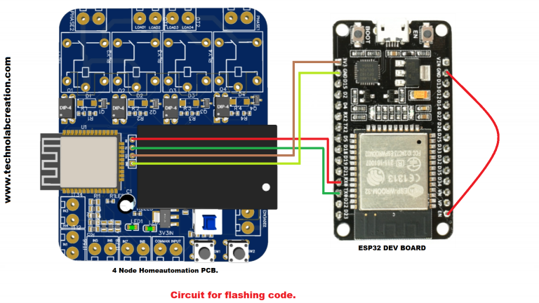

To upload the code into ESP32 chip I will use esp32 development board , Connect the PCB to esp32 board  as per this Circuit diagram.
Click here to download the code from my GitHub Repository.
Here in this section code if you want you can change the Bluetooth device name. This name will appear as the name of your Bluetooth device when we pair ESP32 with our Smartphone.
After this no need to change anything, Now  straight forward upload the code in your ESP32 board After selecting right board and right communication port.
After hitting the  upload button now in the PCB, Press and hold the boot button and press the reset button once to make this module go inside the boot mode.

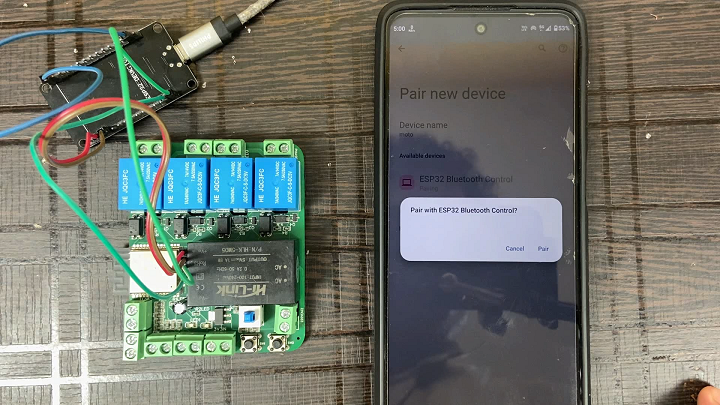

Now open Bluetooth settings of your phone, then click on pair new device…
A Bluetooth device having the same name that we mention in the code have must shown in the Bluetooth device list of your phone, tap on ESP32 Bluetooth Control device to pair with your phone.
Once the esp32 is paired with the phone , Open the app again, Now in the app click on the connect and select your Bluetooth device.
You will see Bluetooth is connected message  is shown in the app, this means now our esp32 is connected with the app.

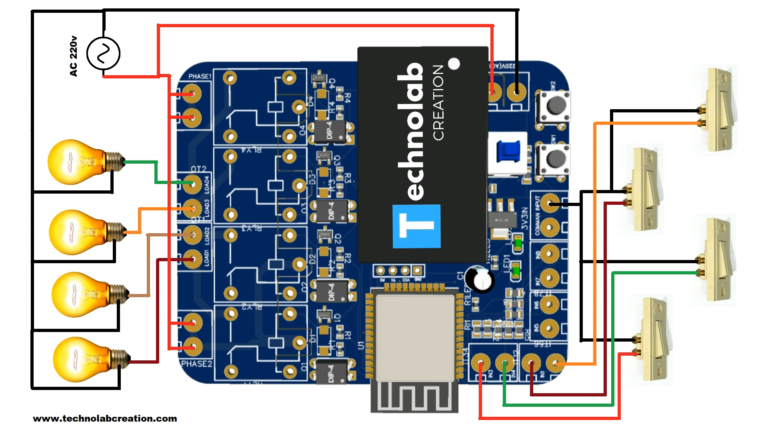

Now connect all the bulbs or any of your home appliances and switches as per this Circuit diagram.

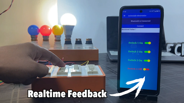

Here everything is done let’s see this project in action.
Now we able to control the bulbs through android app and manual switches and we are also getting the real-time feedback in the app, This home-automation project is very interesting and useful.
