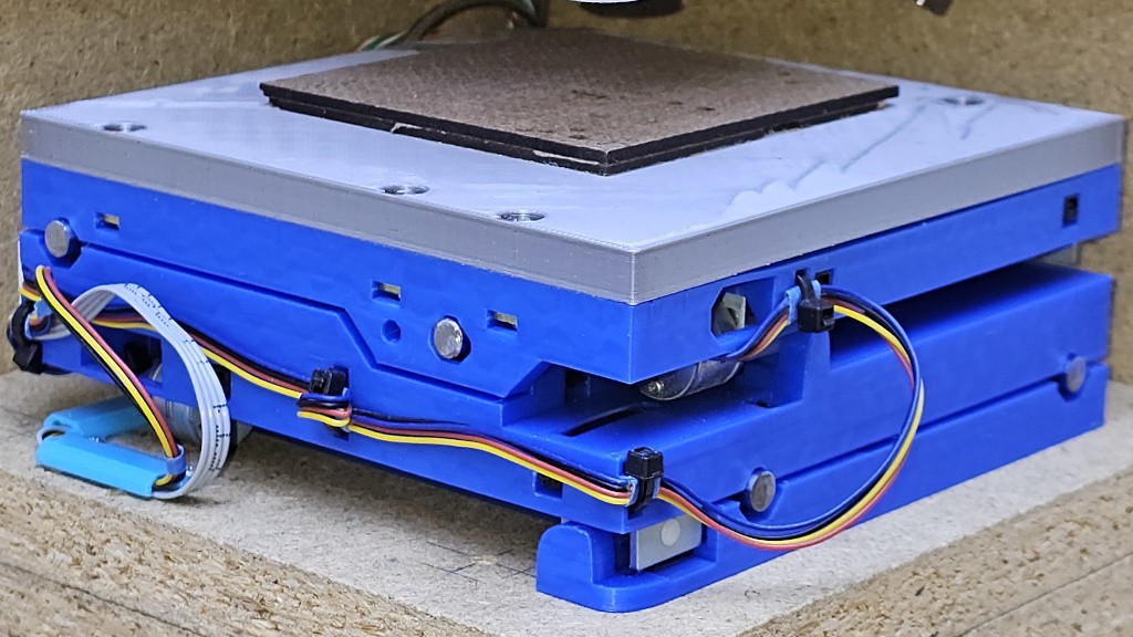

From the previous log: one fine day I discovered solid sliding contact between layers of the XY stack. It appeared to have been so for some time and through a few revisions without hindering normal operation. I could have just said "so it is" and let it be so. But trying to pass that off as a working mechanical design seemed like a slouch too far.
So here's a story that runs more-or-less linear through the part that could have been easy, then diverges.

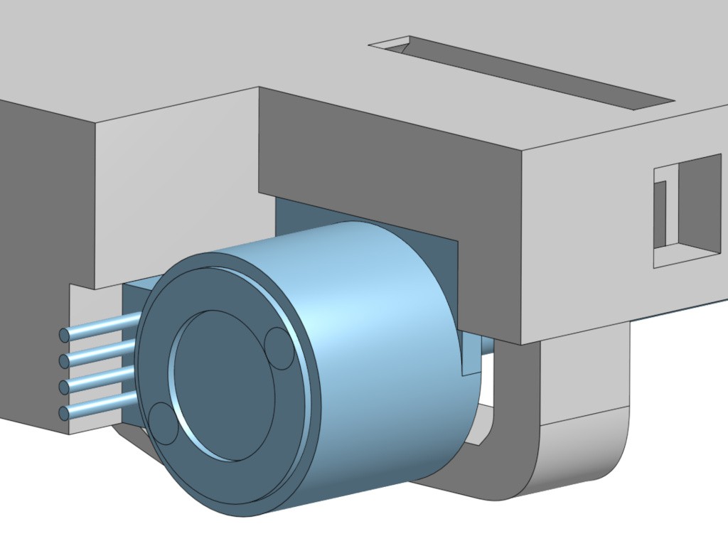

The printed parts of this X+Y stack are all PLA -- the printable plastic that's stiffer than most (all?) alternatives that aren't exotic. When it's not too hot. And too hot isn't very hot. The X & Y steppers run hot enough to make compatibility with PLA a question from the start. That's why the motor+screw units live at the outboard edges of each layer and with open-ish ventilation around the motors. Empirical results so far indicate that the thicker middle part carries the Y motor without trouble, but the thinner top part softens enough to let the X motor droop.
The greater vulnerability of the top part/X motor is no surprise.

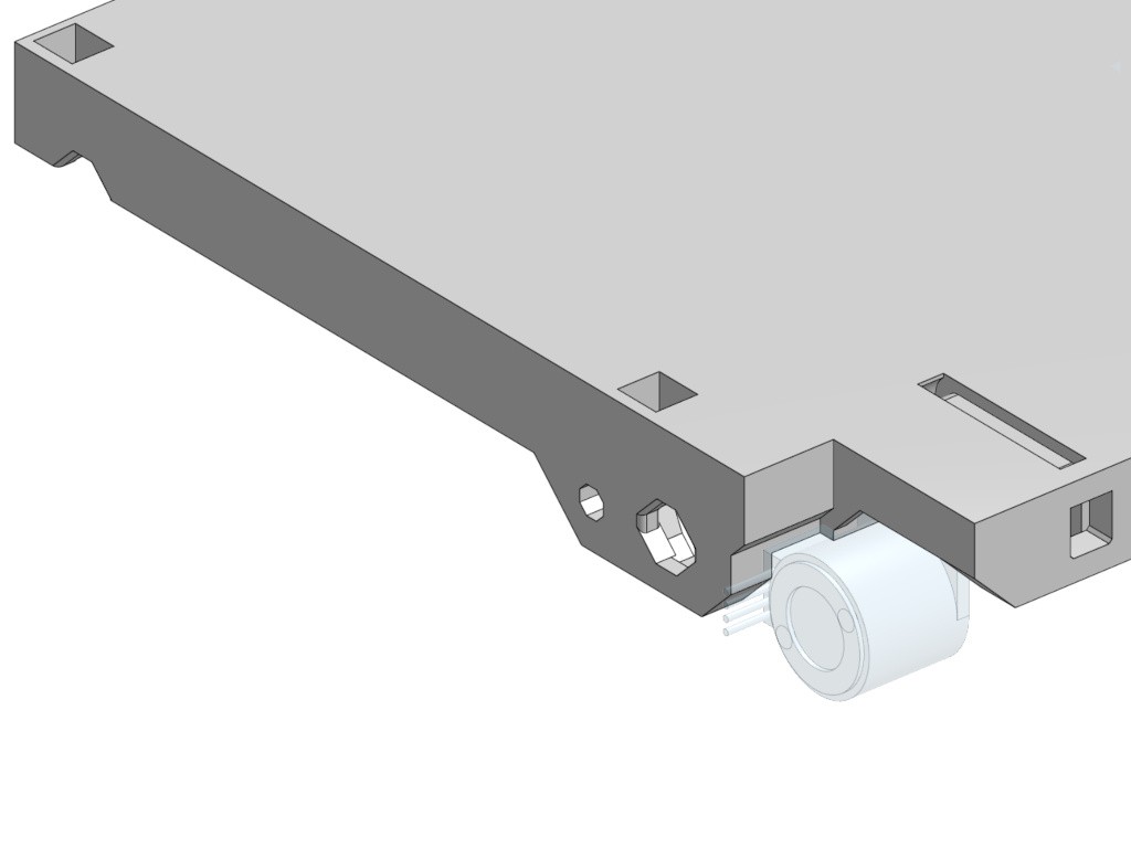

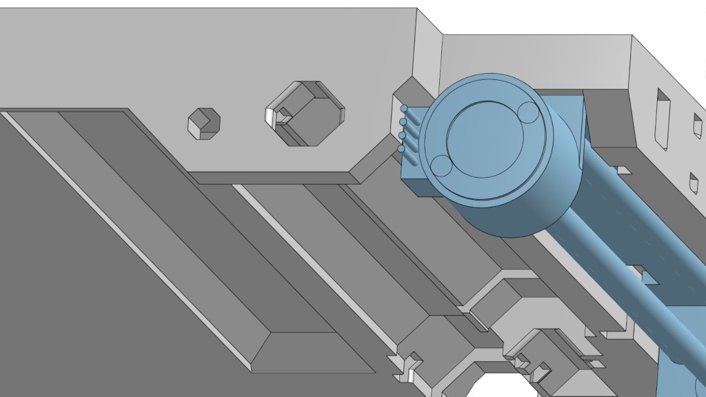

Working clearances reduce direct support for the motor to a long thin cantilever:

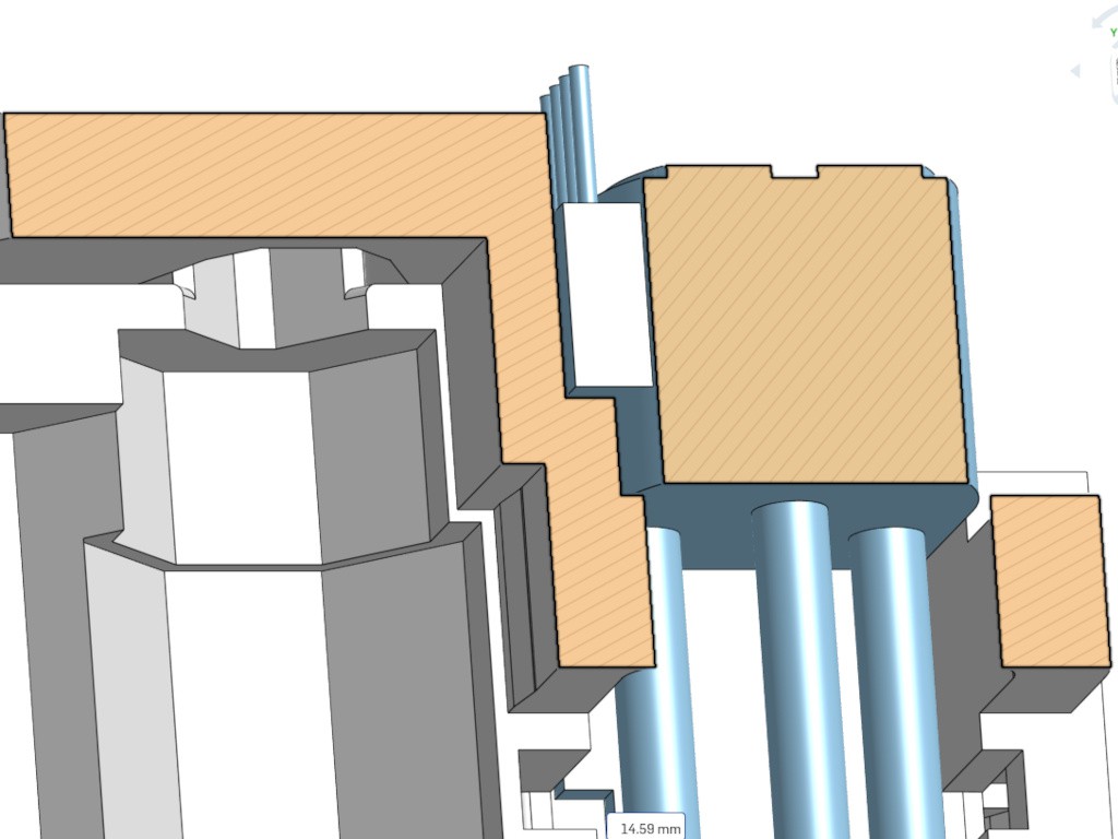

With the interior of the part body thinned out so much, support for the motor leans more on the stiffness of the perimeter. The motor+screw unit fits right along the front edge, which runs between the front corners which are supported by the left & right edges, which have greater section depth through their cantilever projections beyond the supporting rod ends:
The front face supports the front edge of the otherwise floppy font third of the top surface -- from which the motor hangs. It also has a big hole in it for airflow to cool the motor. Continuity of edges above & below the big hole help the face resisted bending, but the resulting parallelogram is weak in shear, which pops the 'stiffness of the perimeter' baloon. Reducing the vent area seems like the wrong answer to a heat problem.
So the X motor is held up by some long, thin, warm cantilevers. Clipping a couple of corners of the big hole might have helped. A little. Maybe.

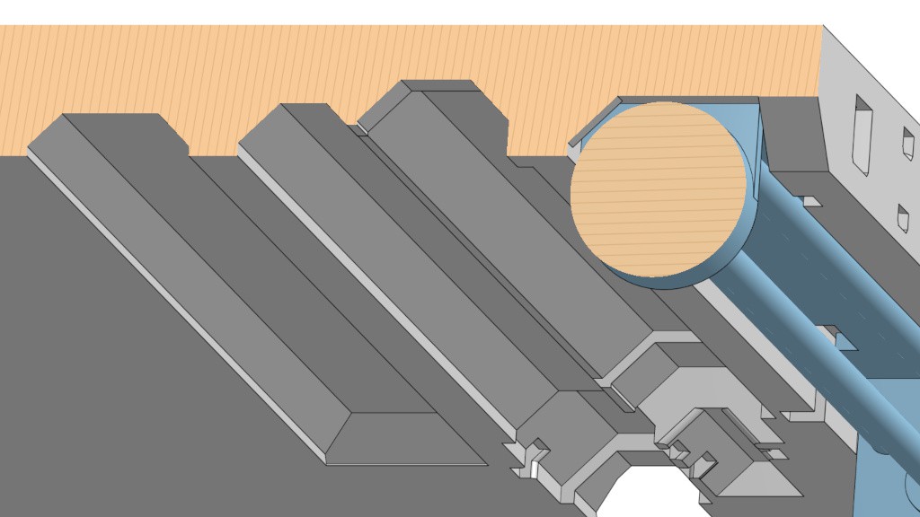

...And that all turns into a sliding interface with the part below, as highlighted in the first image above. Which works. For inaesthetic reasons.

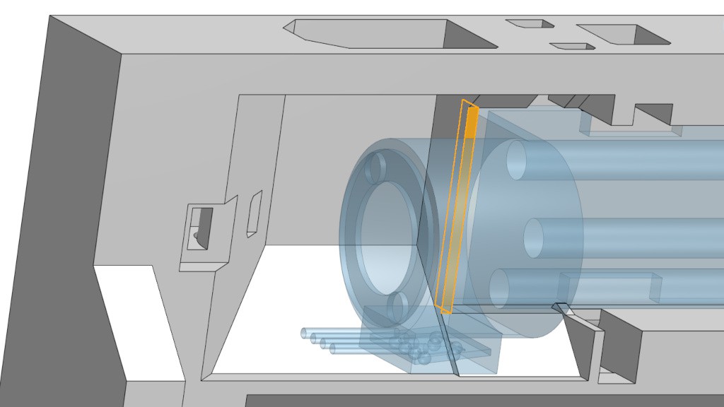

How about shifting the motor+screw to the other end of the front edge?
aside:I was already considering that shift as part of a deferred cable routing aspiration which I had "...convinced myself to stop thinking about ... But d[id]n't not consider it anymore." But the current round of failure to change one thing at a time has finally killed it off. By replacing it with a different cable routing aspiration which benefits from the same shift for a different reason.
I think the original and simplest idea that might have been most quickly implemented to solve the motivating problem was that moving the motor to the corner would permit (i.e. reduce inhibition inhibiting) restoring the integrity of the perimeter by moving the big hole from the front face to the top surface directly above the  ̶h̶e̶a̶t̶e̶r̶  motor.
I think that would have improved both mechanical support and also ventilation. Better ventilation would reduce heating and softening of the material.  All good. Except for the risk that wrapping a relatively thin wall close around the motor might introduce enough new bad to bury the good. Based on nothing, I think it would probably have worked.
I think but don't know because I didn't actually get a part printed before the next idea.

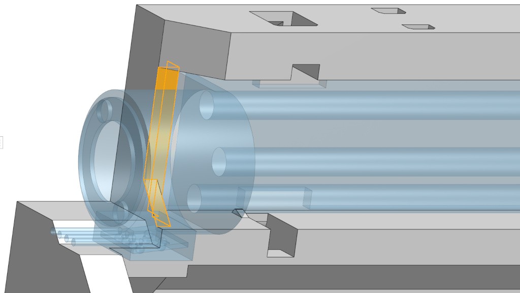

Being closer to the corner, a brace under the motor (i.e. under the screw next to the motor) could tie into the extra-deep section of the left edge a little back from the corner. Then the dubiously thin & heated corner of the perimeter could go away and open up the corner completely around the motor.
The brace would tie into the left edge with a relatively short joggle. That still depends on the stiffness of the perpendicular segment, but it's a relatively short segment with at least a little more than minimum thickness in it. The part that needs to be stiff is still pretty close to the hot, but the hot is even more better ventilated.
I think there's fair odds it would have worked.
Consider:

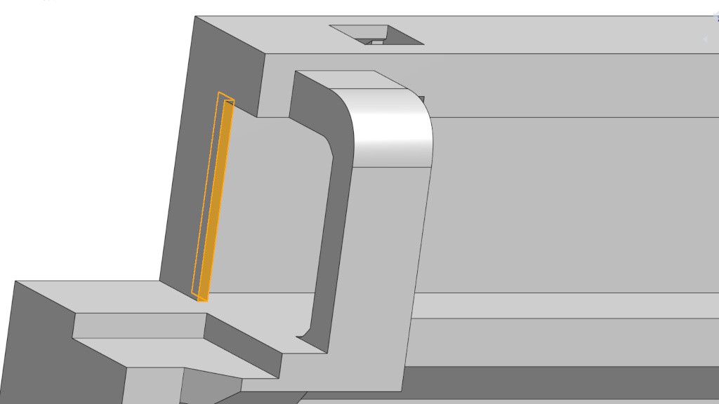

In the status quo, the wall at the motor end of the pocket that locates the motor+screw unit is thin. It was kept thin to maximize the free air volume around the motor.
(How much did a thinner vs. thicker wall really improve ventilation & cooling? I don't know. Categorically, there are lots of guesstimated details where I haven't done any A/B testing or otherwise tried to determine which details really matter, which don't matter, or which really matter and are wrong. STEM projects, anyone?)
For a first try at relocating the motor, I just shifted the same pocket and thin wall over toward the corner.
For all the same rationalization as tying the under-brace to the left edge, that end wall now looks like it could serve as a cantilever of deeper section. But it's thin. But now the reason it was thin (if it ever mattered) is ventilated away.
So it could be thicker. And internally detailed to print solid. That, plausibly coupled to the left edge, would make a much more stout cantilever. Maybe stout enough to do the job without any janky under-brace.
Being shifted left, that thickened part of deeper cantilever section also aligns with less clearance cutaway (where bearing clearance doesn't have to also clear the bearing tie).  So reinforcement of the more substantial cantilever can more substantially extend back into the top surface and over to the left edge.

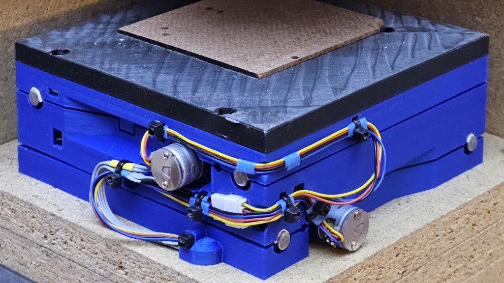

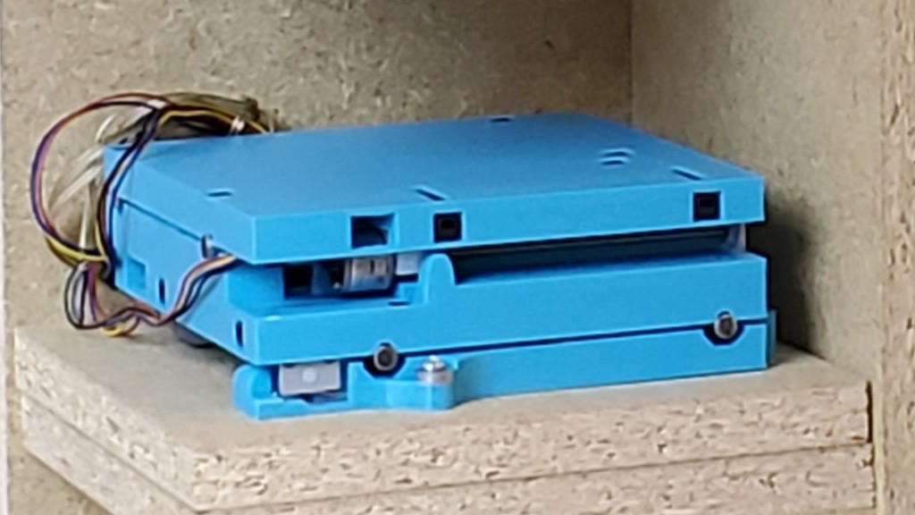

In scope of this project, the 3d printed XY table had developed to it's latest form...
...as a recognizable evolution of the first idea that looked like it might work:
Now, not so much:
That's a lot of change. Hopefully it's as good as "sideways" and not backwards. At least it hasn't sagged yet.
I'm not pushing to publish the new thing yet because the pictured example still required some handcrufting to make it work. (Those aren't the shims you're looking for.)
