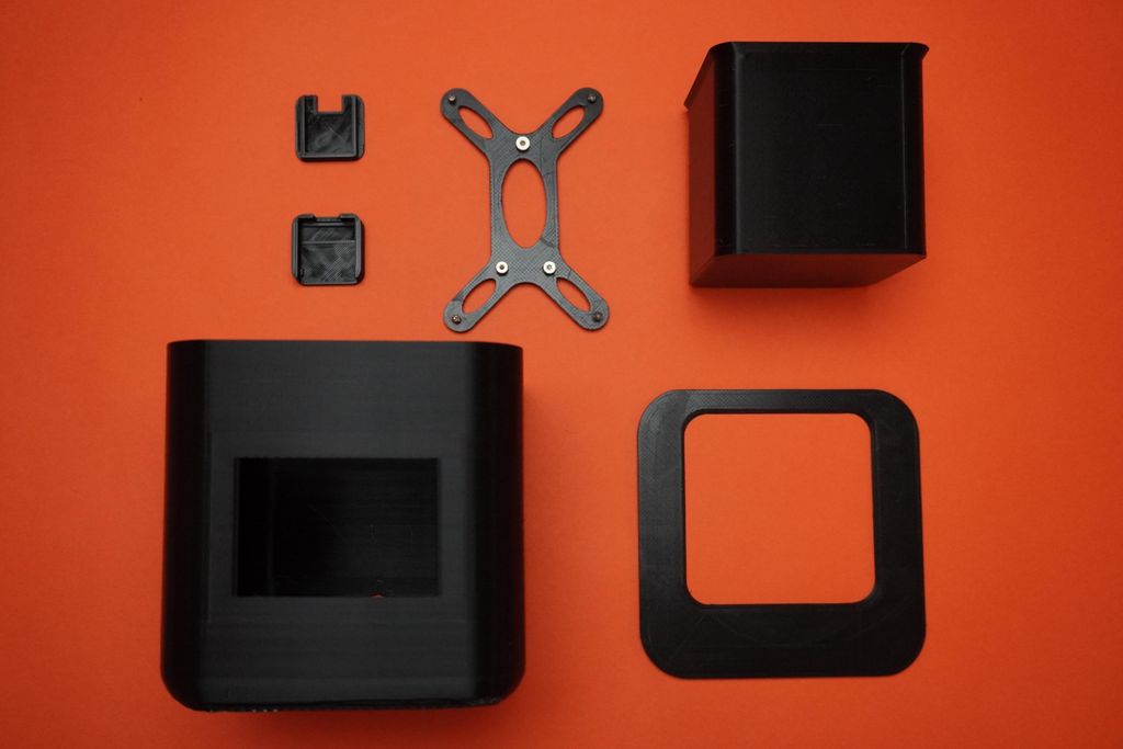

3CAD Designing & 3D Printing
- First, I used a program called Fusion 360 to create the design for Pet Pot. I made sure to carefully look at all the official data sheets and documents for the electronic components I was going to use. After that, I 3D printed all the parts needed for Pet Pot.
- You can take a look at the design in your web browser or on your mobile app, and if you want to make any changes to it, you can do that using the Fusion 360 software. You can also find the STL files, which are the 3D printing files, right here for easy access : Pet Pot STL, Codes, and Other Files

Now that we have our 3D printed parts ready , the next step is to join them together.
- Take the 3D printed mounting bracket and align it with the Unihiker board in the desired position.
- Use the three screws to attach the bracket securely to the board. Insert each screw through the bracket's holes and into the corresponding holes on the board.
- Tighten the screws carefully to ensure a firm connection, but be cautious not to overtighten and damage the components.

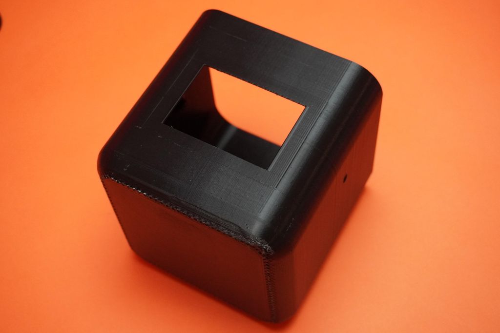

5Adding a Transparent Display Cover
In this step, we'll give Pet Pot a sleek look by adding a black see-through glass as a protective visor for the display on the main body. We'll use glue to secure it in place.
Take the black see-through glass and ensure it's clean and free from any smudges or debris.
Apply a thin, even layer of adhesive glue to the edges of the display area on the main body of Pet Pot. Be careful not to use too much glue to avoid excess spillage.
Gently place the black see-through glass over the glued area, ensuring it aligns perfectly with the display.
- Press down lightly on the glass to secure it in place. Make sure it sticks evenly to the main body.
- Allow the glue to dry as per the manufacturer's instructions. This may take some time, so be patient.
Once the glue has completely dried, you'll have a stylish and protective visor for the display on your Pet Pot. It not only adds a sleek appearance but also safeguards the display from dirt and damage.
