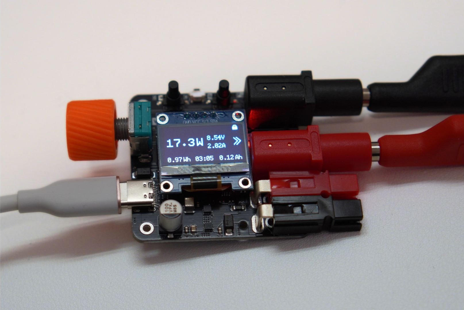

Hardware specification:
  • Input/Output voltage: 3.3V - 20.5V
  • Max output current: 3A for BETAUSER, 5A for RELEASED PROTOTYPE
  • Input protection: ESD protection
  • Output protection: ESD protection, flyback diode protection, reverse current protection

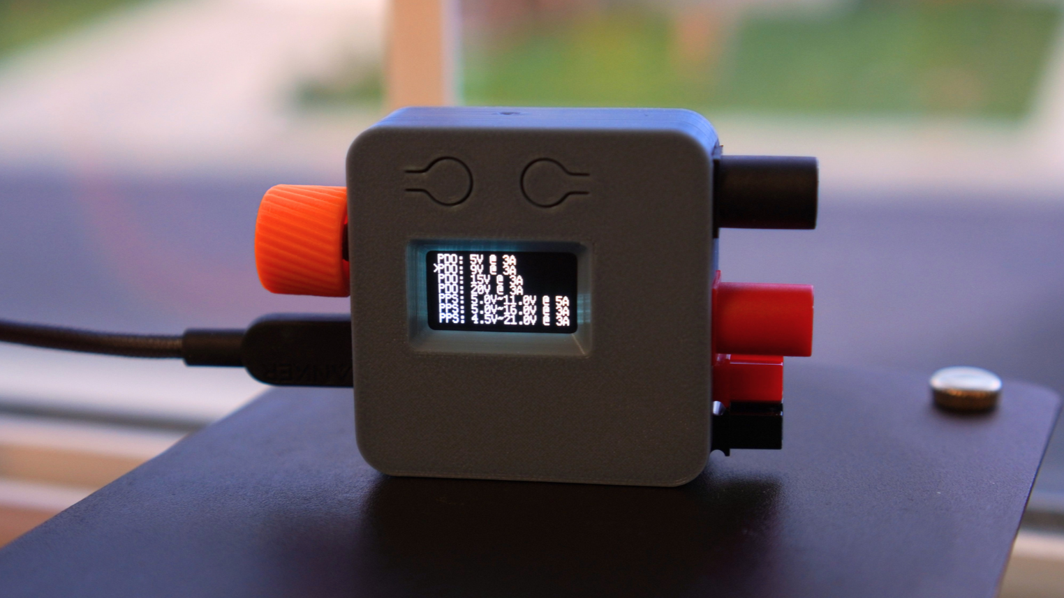

Design iteration:
Final design
First nicely designed prototype
Photo from our Beta testers
Credit: Drew from TechGuyDrew
