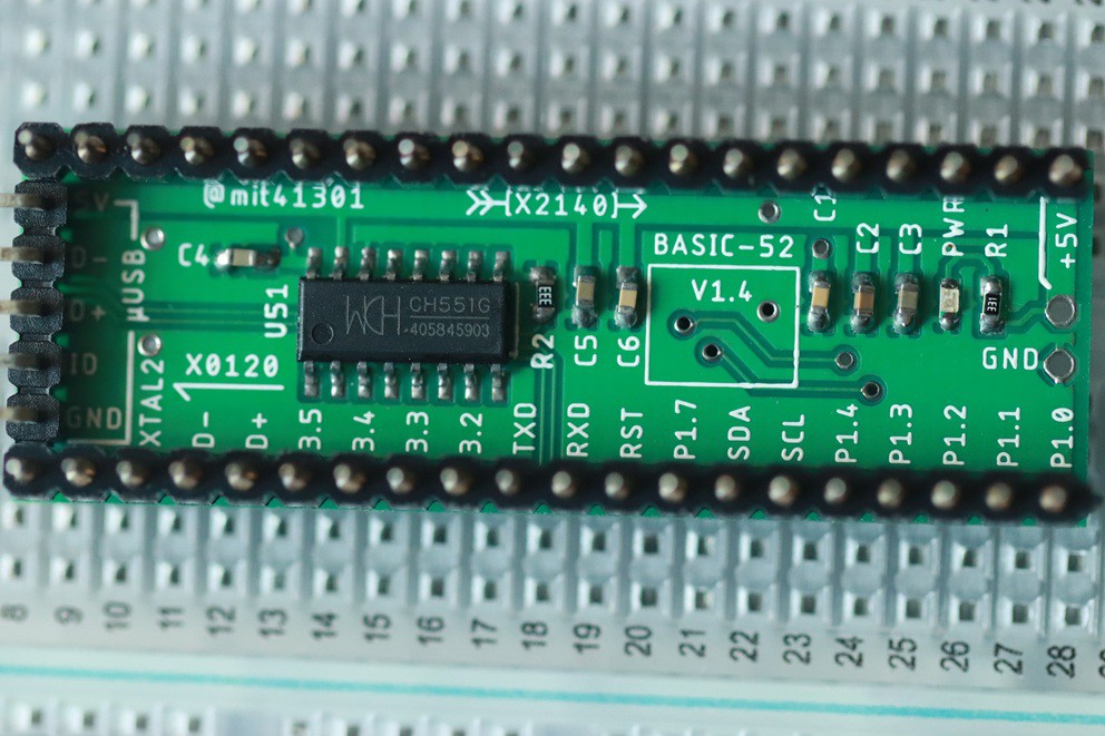

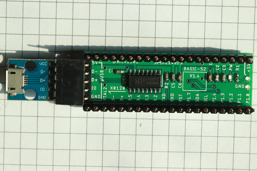

Single Chip Computer
Simple Single Chip Computer running MCS BASIC-52 with wireless connectivity between PC or Phone. No external crystal, latch or RAM required!
Intel 8052AH-BASIC microcontroller requires additional external LATCH and atleast 1KB external RAM along with external crystal or oscillator to function as a stand alone computer running BASIC-52. But after few decades now we can run true Single Chip Computer using just a 8051 core controller with internal RAM and internal oscillator with extended FLASH memory. No external device programmers required to program the FLASH memory. Running BASIC-52 V1.31 along with I2C functions and SFR Read/Write functions included. Enhanced 8051 core performs 8~15 times faster than conventional core. We can fit everything into a small DIP-40 form factor board which enables plug and play replacement for the conventional microcontroller board.
OBJECTIVE:
The objective of the project is very simple. Make a Single Chip Computer running BASIC-52 using enhanced 8051 core. The board form factor should be equal and compatible with existing DIP-40 600 mils package. The available pins should be mapped to the original DIP-40 package pinout.
The circuit should be very minimal. If possible run with only a single chip.
PROs:
  • Single chip solution without any external components.
  • No external address latch
  • No external RAM required. Uses internal RAM for BASIC and program
  • No external Crystal or Oscillator required. Running at 24MHz internal oscillator
  • No external programmer required. Programming via USB or UART
  • PORT1, Tx, Rx, Timer, Interrupt, pins available for user interface!
  • Runs 8~15 times faster than conventional controller
CONs:
  • Limited Memory
  • No external memory
We can easily overcome the limitations using CH558 or CH559 controllers. Using CH558/CH559 controllers gives the speed advantage of 2x since running at 48MHz. CH559 comes with 6kB RAM which is good enough for most of the programming needs.
The following description shows how we can implement a BASIC-52 single chip computer using CH552  IC. CH552E comes with MSOP-10 package. It is just 3x3mm size. But the number of useful I/O pins are just 4.  CH552G comes in SOP16 package. It has more I/O pins compared to CH552E. Same thing applicable to CH552P IC.  CH552T comes in TSSOP-20 package. It is having 20 pins and having highest pin counts in the CH552 family. CH552 family comes with 16kB FLASH and 1288 bytes Data Flash or RAM.
CH552E does not have UART0 pins mapped to physical IC. So we need to reassign the UART0 traffic to UART1 in the source code.
The souce code was modified by Twitter(X) user @hiyodori5
You can also find CH552E, CH559 code in his Twitter feeds.  CH559 code also supports SPI bus apart from I2C bus.
CH552 Block Diagram
Block Diagram
CONSTRUCTION:
If you just want to run the BASIC-52 on single chip, you can use any of the commerical available boards which using CH552E, CH552G, CH552P or CH552T.  We can also run the CH559 code on CH559 eval or dev boards.
The above image shows the board form factor and pin assignment.  Since the board was made in DIP-40 size and pins compatible with the original pinout of the 8052 IC. The board is very simple and can be fabricated on two layers. The fabricated board looks like below.
Power supply pins are VCC at pin 40 and GND at pin 20. PORT1 pins 0~7 available which is very useful for interface. Port 1 pin 2 also serves as PWM output which is useful to make any PWM based control or just create some noise or sound using buzzer/speaker.  Hardware Reset pin is available. RxD and TxD pins available for primary communication. INT0, INT1 pins are available. T0, T1 pins are available. P3.6 and P3.7 pins are available.  P3.6 and P3.7 are useful for programming the device Flash memory.
We need VUSB capacitor and proper supply decoupling for reliable flash programming through USB port.  After programming BASIC-52 code, since we are not going to use the USB port anymore, we don't require the VUSB capacitor. By this way we can achive the real 100% Single Chip Computer using BASIC-52.  The Flash programming cycle endures for around 200 times.  Since we are going to flash only once, we need not to bother about flash programming anymore.
Since there is lot of space and no other components required, I don't want to go for fabrication with no other features. So I have decided to add onboard USB-TTL converter.  We can directly connect the Single Chip Computer to PC using 4 connections VCC, GND, D- & D+ pins.
The assembled and firmware loaded board looks like below.
Both top and bottom side view. In the top side only one chip needs to be assembled. Bottom side there is no components needed for wired and wireless operation. There is a optional...
CH559_DS.pdf
CH559 datasheet. Dual low/full-speed USB host/device +ADC 8-bit E8051 MCU. 64KB Flash-ROM, 6KB on-chip xRAM. Supports USB host and USB device modes. Provides dual port Root-HUB, ADC, 4 timers/PWM, 2 UARTs, 2 SPIs, etc.
Adobe Portable Document Format - 887.51 kB - 02/22/2026 at 09:28
Preview
CH558_DS.PDF
CH558 datasheet, low/full-speed USB device + ADC 8-bit E8051 MCU, 40K program ROM, 4K+256 memory RAM, supports full-speed or low-speed USB devices, provides ADC, 4 groups of timers and PWM, dual serial ports, SPI, etc.
Adobe Portable Document Format - 762.22 kB - 02/22/2026 at 09:28
Preview
CH552_DS.pdf
CH551/CH552 datasheet. CH551/CH552 is a low-speed/full-speed USB device and low-cost 8-bit E8051 MCU, with 16K flash+1K RAM 6-channel touch-key detection, ADC, two UARTs, unique ID, etc. CH551/CH552 supports ISP library.
Adobe Portable Document Format - 769.17 kB - 02/22/2026 at 09:24
Preview
CH554_DS.PDF
CH554 datasheet. CH554 is an 8-bit E8051 MCU and supports low-speed USB host/slave and full-speed USB host/slave, with feature of low cost. It provides 16K program ROM and 1K+256 RAM, supports USB host and USB device, ADC, Touch-key, 3 sets of timers, PWM, 2 UARTs and SPI, etc.
Adobe Portable Document Format - 827.56 kB - 02/22/2026 at 09:24
Preview
ideabook.zip
BASIC-52 program listing The Microcontroller Idea Book Circuits, Programs, & Applications featuring the 8052-BASIC Microcontroller by Jan Axelson
Zip Archive - 21.52 kB - 03/26/2024 at 15:45
Download
View all 10 files
  • USB-TTL using CH551G
    mit4130102/24/2026 at 05:55 0 comments
    Since there is only one Chip used in the DIP40 board, there are lots of empty space. So there is a USB-TTL circuit added using CH551G.
    With the integrated USB-TTL, we can connect the Single Chip Computer to a PC using VCC, GND, D+ and D- of the USB port. We do not need a external USB-TTL circuit.
    Integrated USB-TTL circuit using CH551G - SOP16
    Integrated USB-TTL circuit with microUSB connector
    Just using VCC, GND, D+ and D- we can connect the Single Chip Computer to a PC serial terminal via USB port.  The power for Single Chip Computer and USB-TTL circuit drawn from USB port.  No external power supply required.
View project log
  • 1
    SOURCE CODE
    First we need to download the source code from HERE
    You can find assembly language files along with hex and lst files.
    If you want to modify anyting then you need to use the assembler .
  • 2
    ASSEMBLER
    I have used the C51ASM assembler for Windows from Microchip from HERE
    C51ASM is also available for Linux and MAC OS from Microchip
    C51ASM is a 2 pass assembler same as metalink and produces same checksum without any errors or warning.
  • 3
    WCHISPTool
    To program the hex file into the FLASH of the target microcontroller, we need the WCHISPTool which is available from the WCH website.
    We can easily program using USB port which supplies VCC, GND and D+ and D-
View all 6 instructions
WestfW wrote 08/26/2024 at 06:17 point
Do you know if anyone is working on adding USB (CDC) support to Basic52 instead of (or in addition to) UART?  There ought to be enough space...
mit41301 wrote 01/18/2026 at 13:09 point
There are working code available for CH551 working as USB to UART bridge. The code size also small and we can fit into a CH552 along with BASIC-52 interpreter. But I am not sure if there is any hardware resource usage conflict like TIMER, registers etc.,
Stewart Russell wrote 08/10/2024 at 19:43 point
Thanks: I get the "*MCS-BASIC-52 V1.31*" prompt on reset, but keyboard input still isn't happening with the Weact Studios board. I've tried various power options, and I get the same every time.
I have a couple of home-made CH552G 'ch55sxduino' boards  I can try.
Do you plan to make your PCB design available? It might be nice to try it with a CH559
mit41301 wrote 08/11/2024 at 05:24 point
I have tested CH552E, CH552G & CH552T  single chip computer using different types of USB-TTL  based on CH340, CP2102, FTDI 232 using WINDOWS 10 with Tera Term program.
All the combinations worked fine.
CH558 or CH559 boards easily available online.
Stewart Russell wrote 08/06/2024 at 14:12 point
Thanks for writing up this project!
I tried this (basic52s) with the WeAct Studios CH552 breakout. It has 20 pins that mirror the CH552T pinout. I get the BASIC-52 prompt over serial but no keyboard input appears. I tried two different usb serial adapters and the txd line from the computer has continuity with the rxd pin on the ch552.
Am I missing something? Power is 5 V from the usb board
mit41301 wrote 08/07/2024 at 06:13 point
Make sure your baudrate is 19200. Other baud rates are not supported.
After connecting with single chip computer,  hit the space bar followed by ENTER key few times.
It should work without any issues.
Type ?mtop or?xtal to get the response.
If you are using serial terminal utility for downloading files into single chip computer,  provide 5ms delay between characters and 50ms between the lines for proper download.
mit41301 wrote 08/07/2024 at 06:18 point
After establish the connection at 19200 baud, if you activate the hardware reset, you will see the BASIC-52 message with version number.
mit41301 wrote 08/11/2024 at 12:11 point
Make sure the board operating at 5 Volts and USB-TTL also operates at 5 volts and NOT at 3.3 Volts.
I have checked the WeAct CH552T circuit and found that the board operating at 5V and there is a default external clock oscillator running at 24MHz.
There are jumpers to disconnect the oscillator.
There is a LED connected with a series resistance sharing the same Rx pin of CH552T.
Stewart Russell wrote 11/11/2024 at 00:57 point
I finally got a working board! I found I had some "CH55XG v1.1 - designed by cqmcu" boards I bought some years ago. These have a USB mini-B connector, but no external xtal or LED on any serial line. They program and run quite well. So thank you so much for your project writeup!
