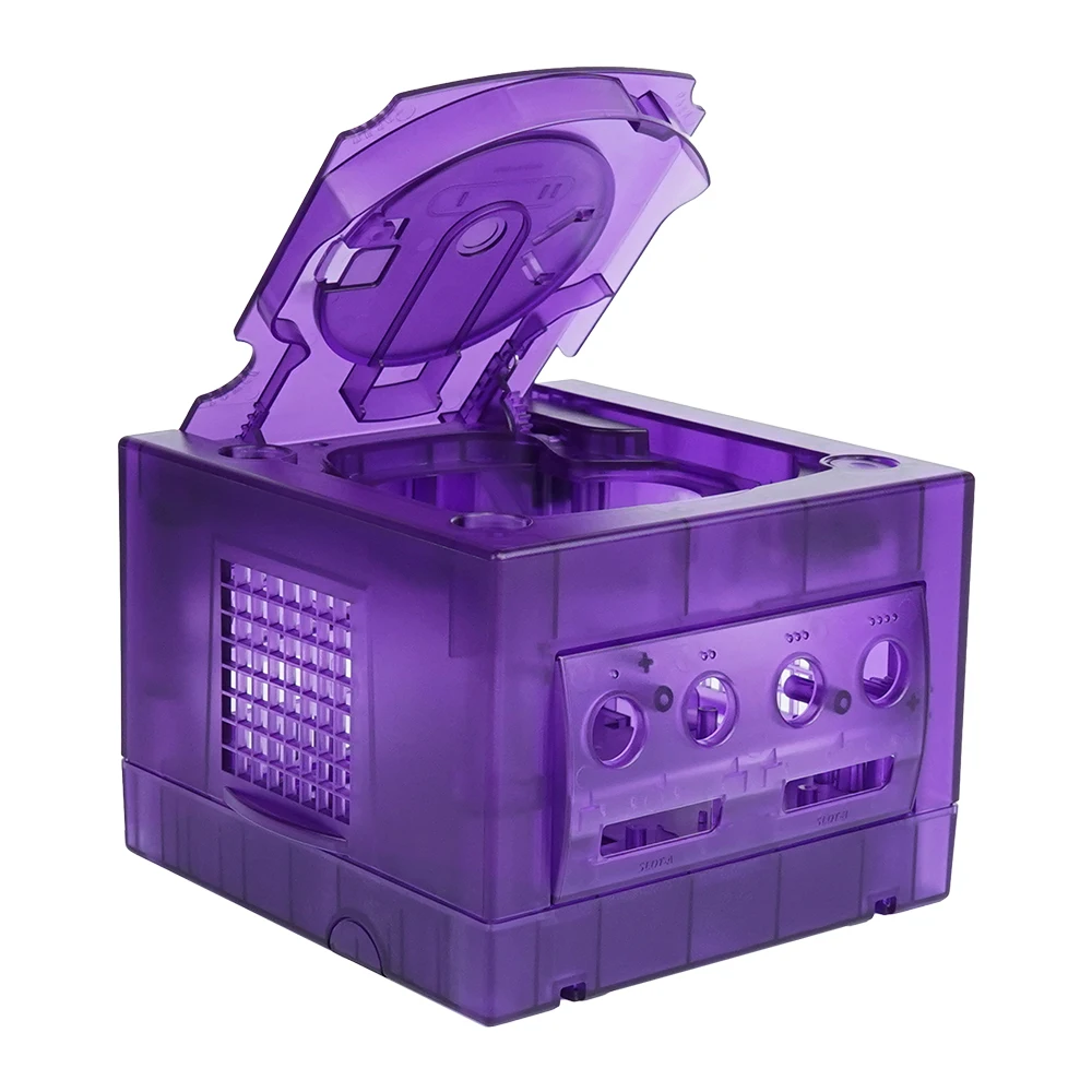

I started off by buying the Bitfunx transparent purple GameCube replacement shell from AliExpress, which can be found here.
The main reason I did this definitely wasn't in case I wanted to add any fancy RGB lighting inside, but to avoid having to chop up a perfectly good authentic GameCube case. Plus, I think it's a great way to show off all the hard work I have done internally once the PC and electronics are neatly assembled within.
