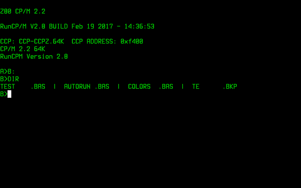

    It then occurred to me that BASIC was LOADing and SAVEing to the root of the SD card, so I adjusted those routines to prefix filenames with "/B/0/", this makes BASIC files available to CP/M's drive B, user 0. The 'TE' editor is much nicer for writing code.

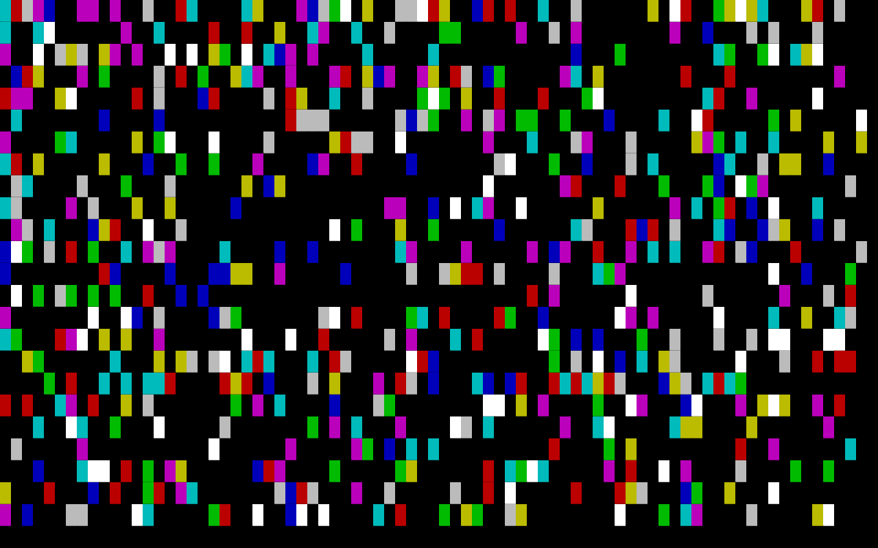

    Finally, I decided to add some ANSI spice!
    • CLS - Clears the screen
    • COLOR - Changes the text color, 9 resets to default
    • PLOT - Plots and lovely BLOCK graphic at co-ordinates X, Y

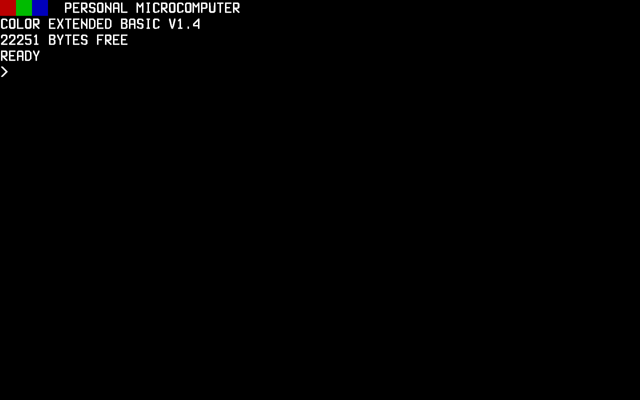

    Power on display:

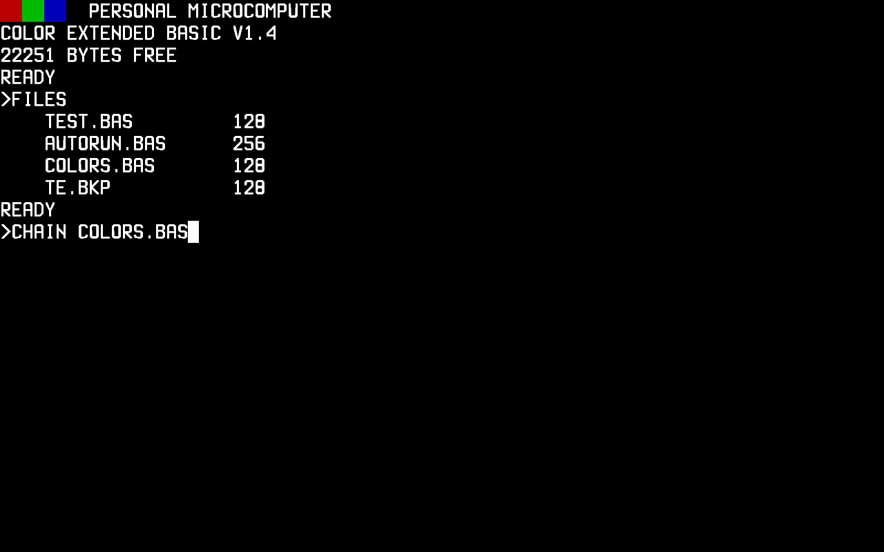

    FILES defaults to CP/M drive B:, user 0. Chaining a color graphics demo:
    Spectacular ANSI graphics:
    From BASIC, type 'CPM' to boot the OS:

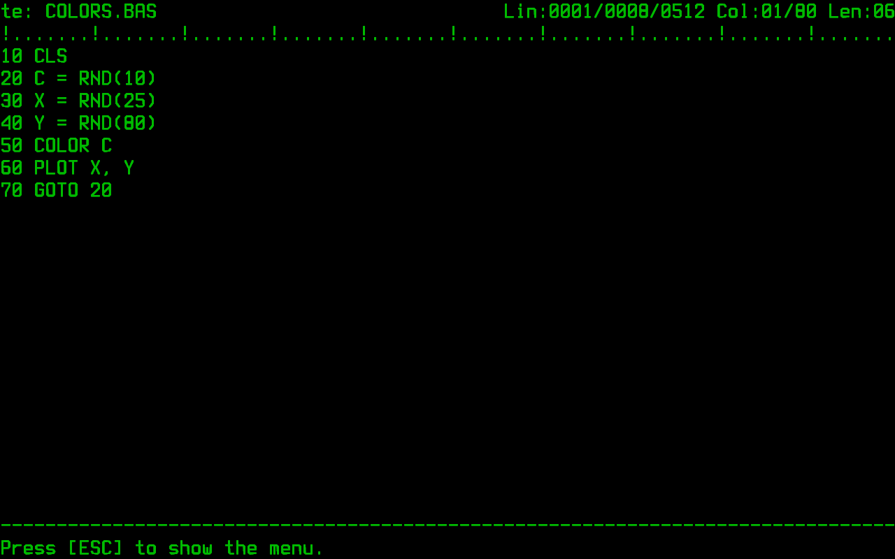

    The BASIC graphics demo, now loaded into 'TE' in CP/M:

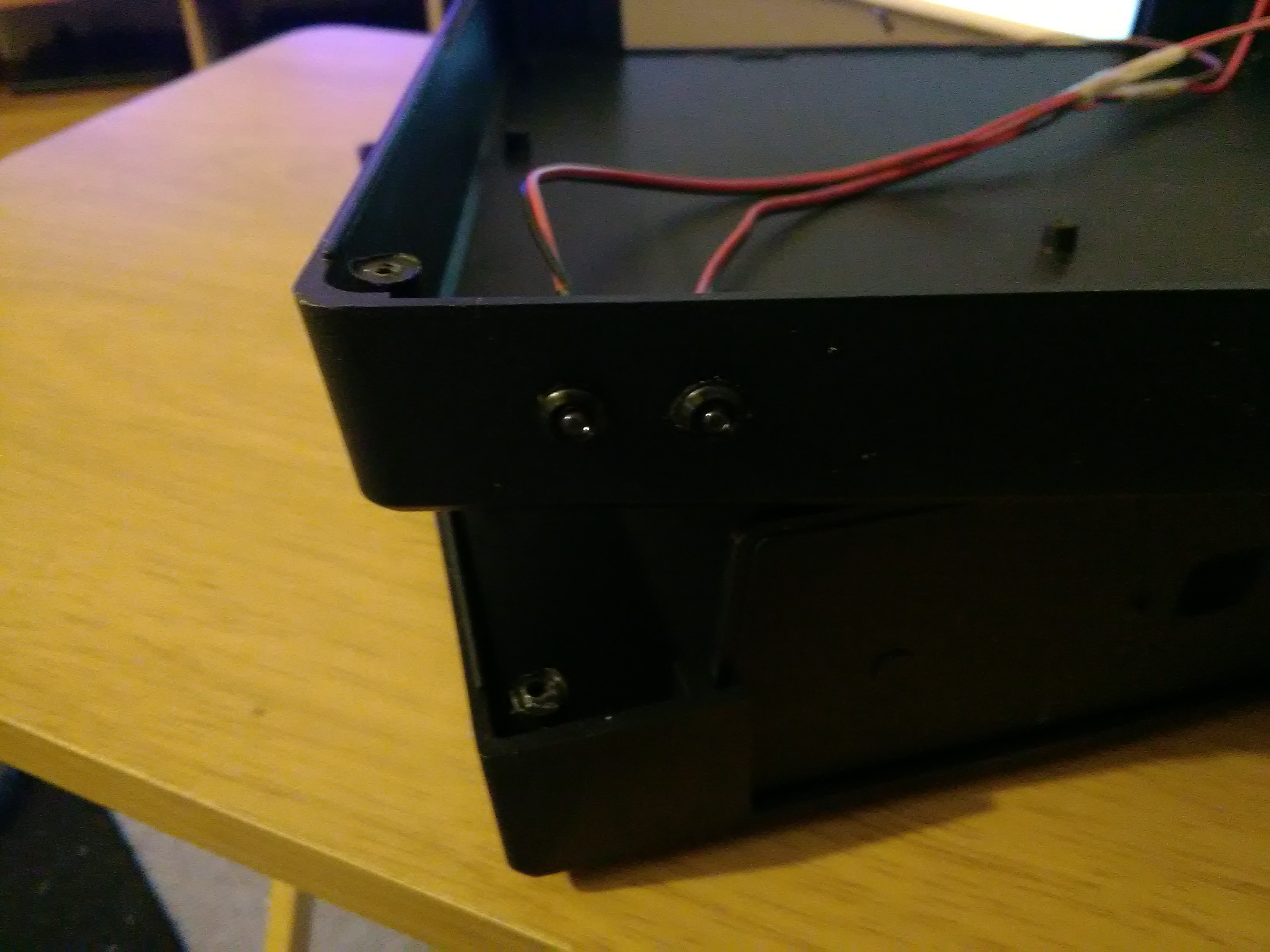

    I bought a nice project case off eBay. I put some spacers in to mount a 3mm piece of plasticard that I would attach the Arduino and MicroSD adapter.I then drilled the appropriate holes.
  • 3
    Step 3
