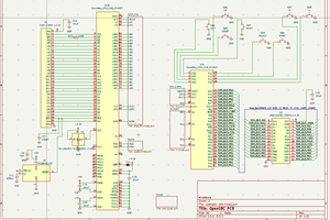

The schematic resembles an electret microphone adapter, which explains why using a pass-through adapter was a bad idea. The guys from TIE forgot to mention that the microphone is an electret condenser microphone and not a plain condenser microphone. In order to find out values for the capacitors, I had to take them out. I did not realize the orange caps were tantalum and not ceramic ones until I re-installed one of them reversed. I could hear the noise created by the capacitor.

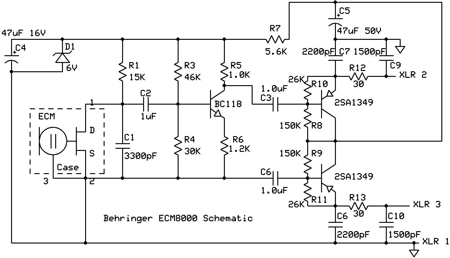

But, but, but, I was having trouble understanding how exactly does it works. At this point, I went on the internet and found the original schematic.
Things suddenly started to make sense. The documentation mentioned the output voltage of the microphone, which is, of course, the bias voltage for the condenser capsule. The adapter works but only by accident. As far as I can tell, the adapter electronics contain multiple mistakes on the XLR side. The 30k and 27k resistors got swapped, and the base and emitter of the transistor in the negative signal path are swapped. I also suspect that the same creative ghost swapped the 1uF and 47uF capacitors. The 47uF fits better on the power rail and not in the signal path.
What I ended up with was adjusting the adapter to resemble jet another variation of the behringer schematic. This was a bit of a hybrid between the board layout, schematics from the internet and parts available.
