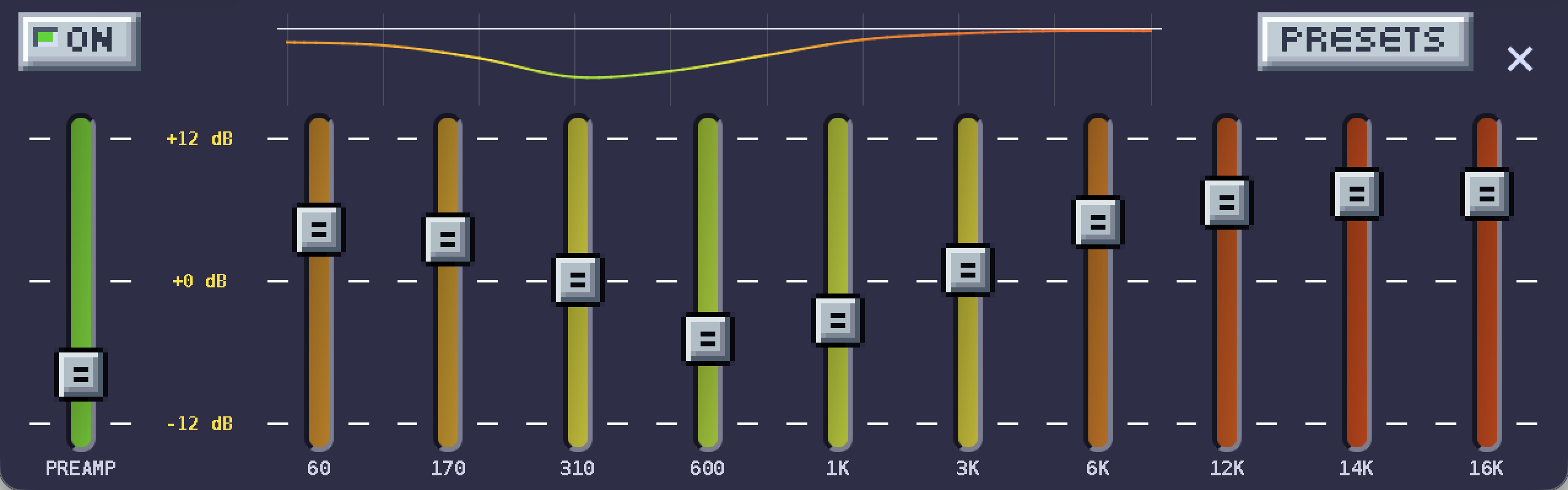

    • 10-Band Graphic Equalizer: Tune your sound with a multi-band EQ, implemented as a system-wide PipeWire filter-chain.
    • Equalizer Presets: Use built-in presets or save, update, and delete your own custom curves.
    • Equalizer UI: New equalizer screen with a live response graph, preamp and per-band faders, and an ON toggle so you can bypass EQ without losing your settings.

Alexander Williams wrote 06/07/2024 at 05:55 • point
This is absolutely amazing! Great job! Do you plan to make the Winamp Equalizer for stacking below the player?
Rodmg wrote 06/07/2024 at 17:13 • point
I'm undecided on that, for looks that would be cool, but implementing as just another screen in software would probably be more practical and economical
