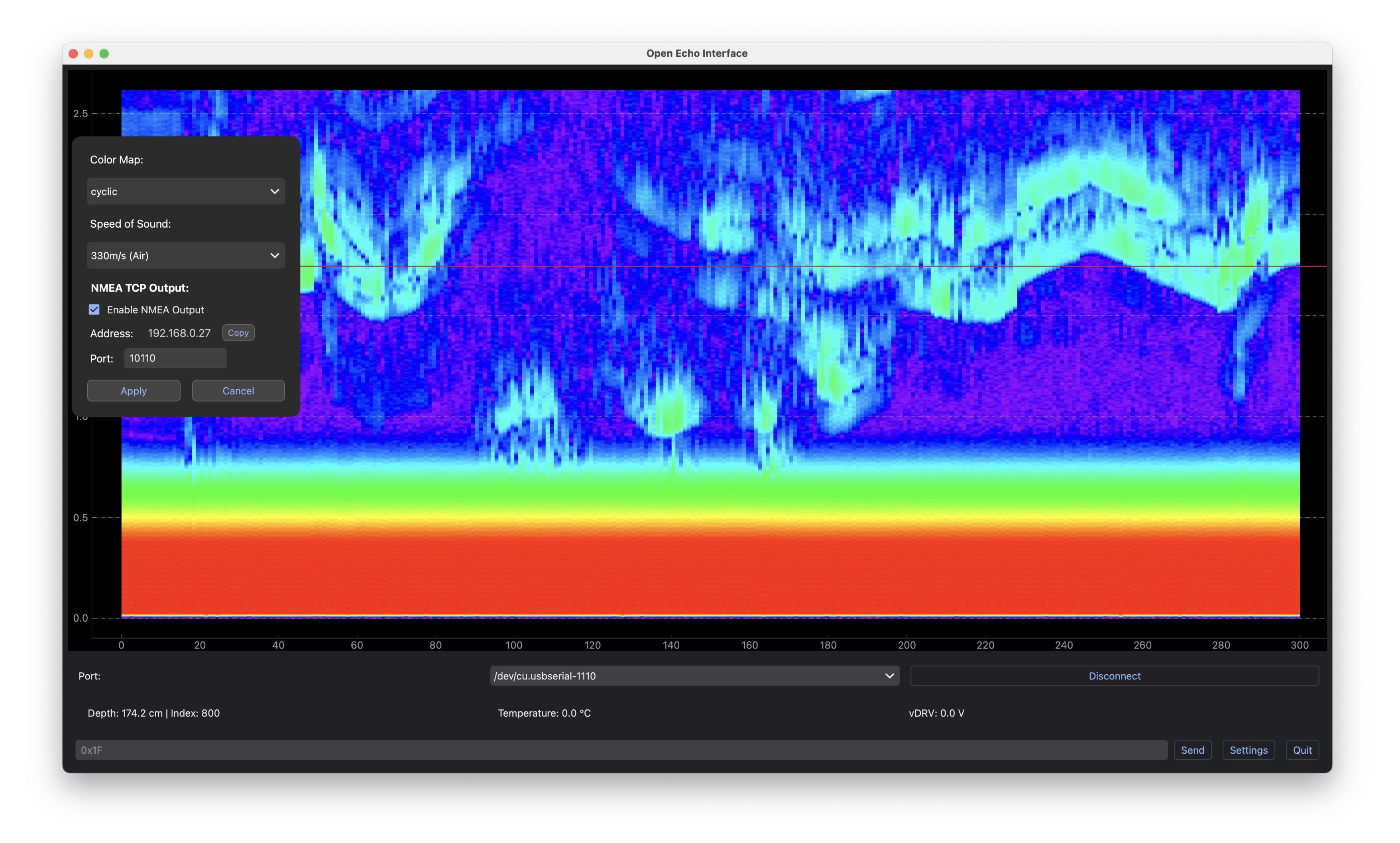

The custom Arduino shield uses a TUSS4470 ultrasonics driver from TI. It can be used to drive different transducer frequencies and is software-configurable. The Arduino ADC is used to sample the echo signal. The Python backend (Open Echo Interface) visualizes the return signal, lets you change settings and stream NMEA compatible data to other devices:

The waterfall chart gives you a better image of the past and allows better differentiation between a real echo and noise. Piezo transducers oscillate pretty long after the sound pulse has been sent. This is the lower yellow part in...
