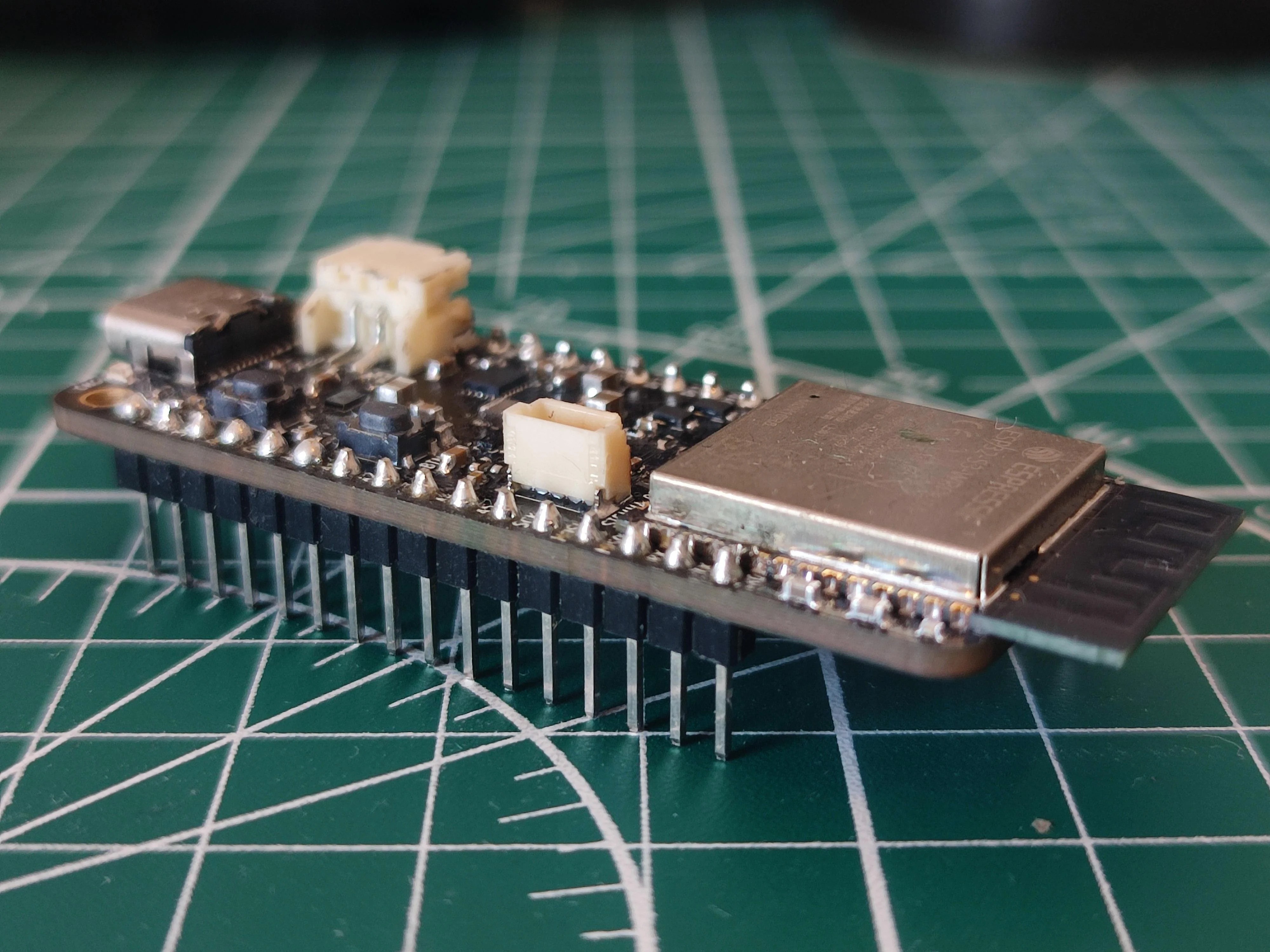

Hardware
I designed the ESP32-S3 PowerFeather to be suitable for LiPo/Li-Ion and solar powered projects. It fulfilled the main requirements I had:
  1. Low deep sleep current (less than 20 uA as well)
  2. Max charging current up to 2 A
  3. Input voltage up to 18 V
  4. Not exactly MPPT, but a set maintained voltage can be set to prevent solar panel voltage from collapsing beyond the panel’s rated MPP voltage at near-MPPT performance
Plus, it had my ‘nice-to-have’ features and more:

The monitoring features are especially useful in remotely deployed nodes to keep track if something is wrong and if an action needs to be done. To see how the power features of the ESP32-S3 PowerFeather  compare to the FireBeetle 2 I mentioned above (and some additional hardware), take a look at this spreadsheet.
The extensive power management and monitoring features of the PowerFeather is mainly thanks to the on-board Texas Instruments BQ25628E battery charger IC and Onsemi LC709204F battery fuel gauge. Here is an overview of the important power-related parts of the board:
