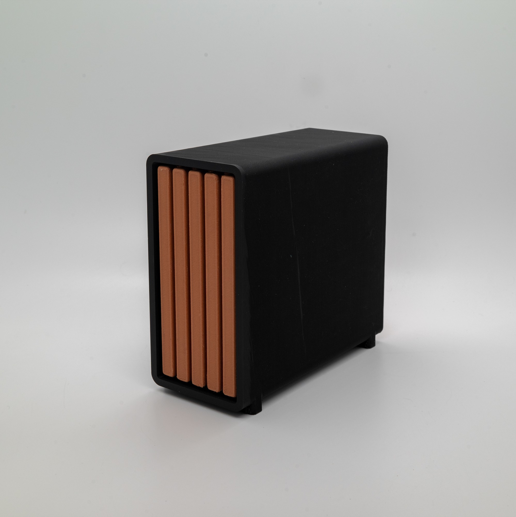

The design style of this case is inspired by Fractal Design's North Pi, but the structure is completely different.
But Swap Pi features a pull-out design overall, making it easy for quick disassembly and assembly.

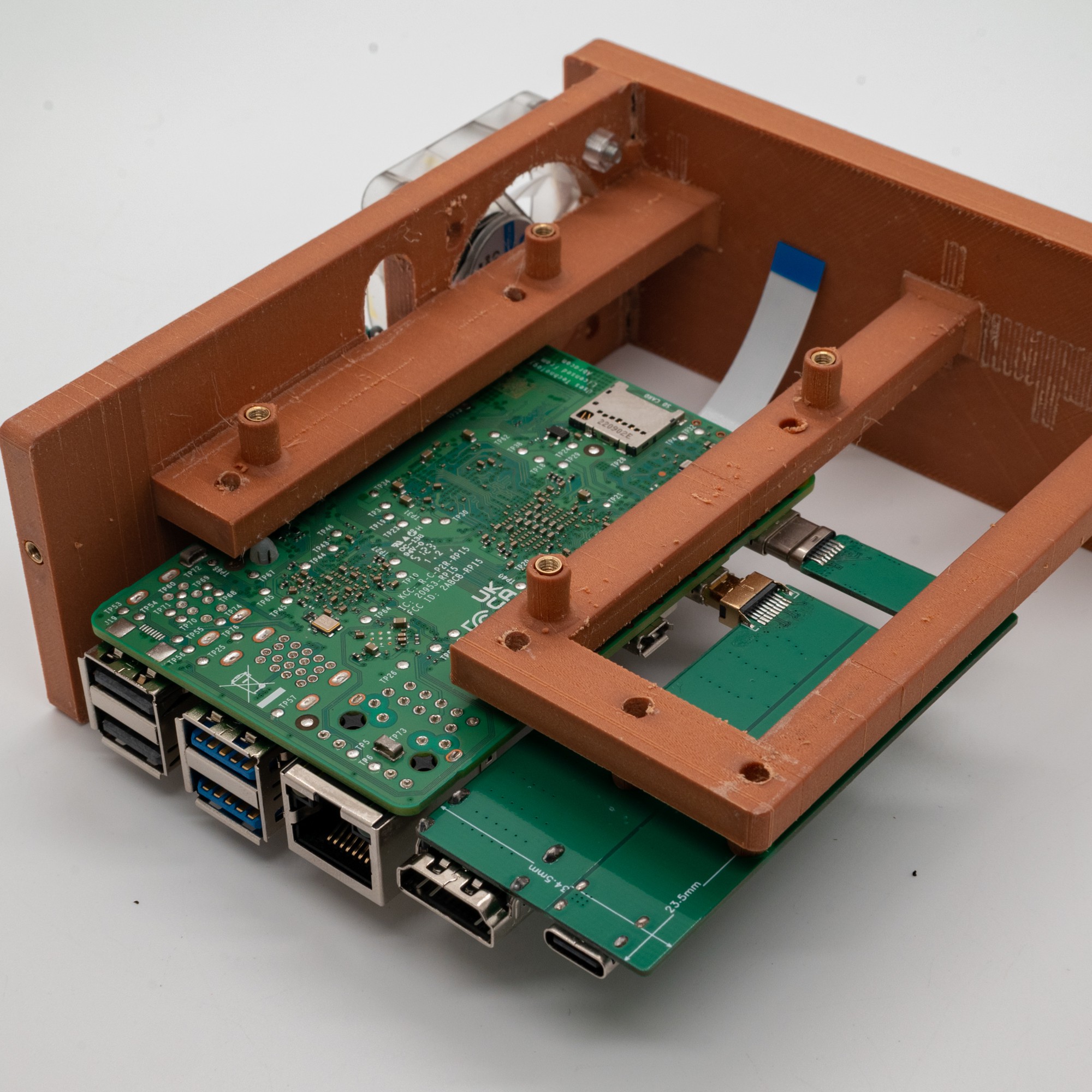

Rear IO
Use the DeskPi KL-P24 Micro HDMI to HDMI expansion boardto route the USB and micro HDMI ports of the Pi 5 to the back.

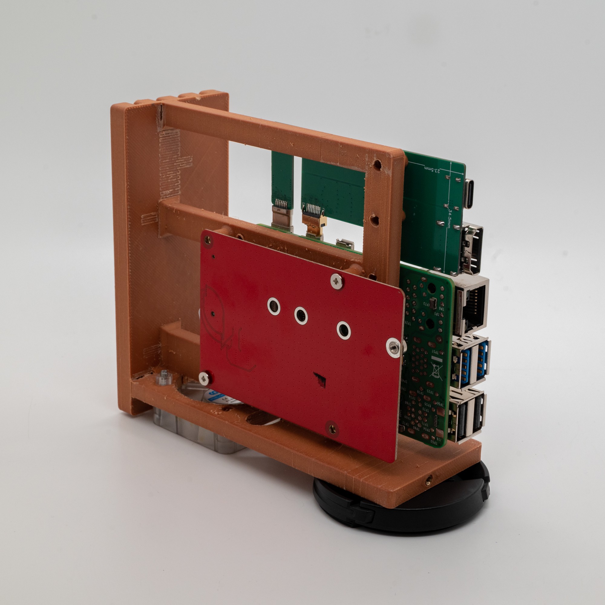

NVMe expansion
On the other side, you can install an NVMe expansion board.
This red NVMe expansion board NVPI5-2280B from PCBWay comes with cables that can be used directly. It seems to be the only 2280 expansion board with just enough cable lengths
It also supports some other NVMe expansion boards, but some longer cables separately or you need modify fan power supply.

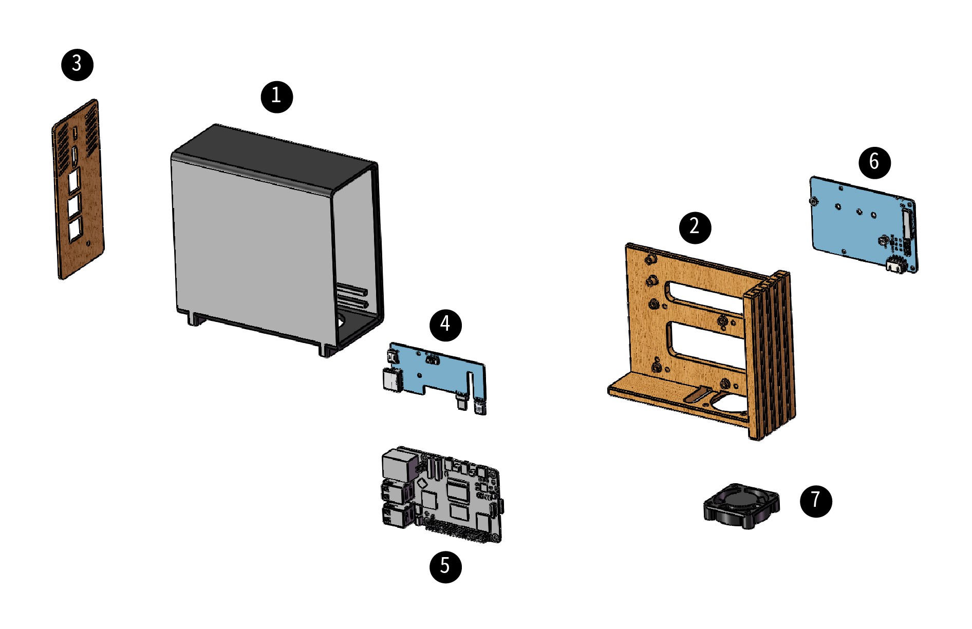

Assemble
Swap Pi has 7 parts:
- Swap Pi Case main part ( 3D print )
- Swap Pi Case front part ( 3D print )
- Swap Pi Case back part ( 3D print )
- DeskPi KL-P24 Micro HDMI to HDMI Adapter Board ( from DeskPi.com )
- Raspberry Pi 5 ( from Raspberry Pi )
- NVMe base board NVPI5-2280B (from PCBWay)
- 4010 FAN (from amazon.com )
Assembled Accessories
- M2.5 screw x 11
- M2.554 heat-set nuts x 11
