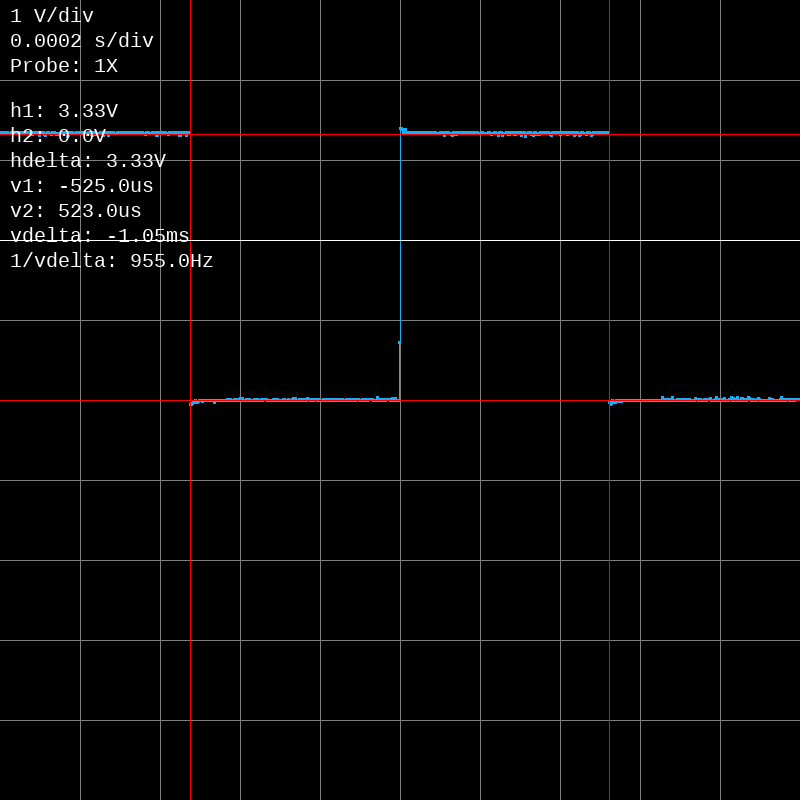

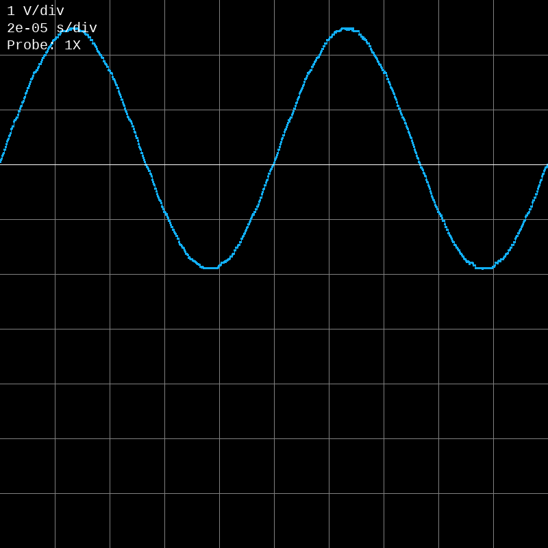

Example Waveforms:
Here are some example waveforms captured with the NS1:
