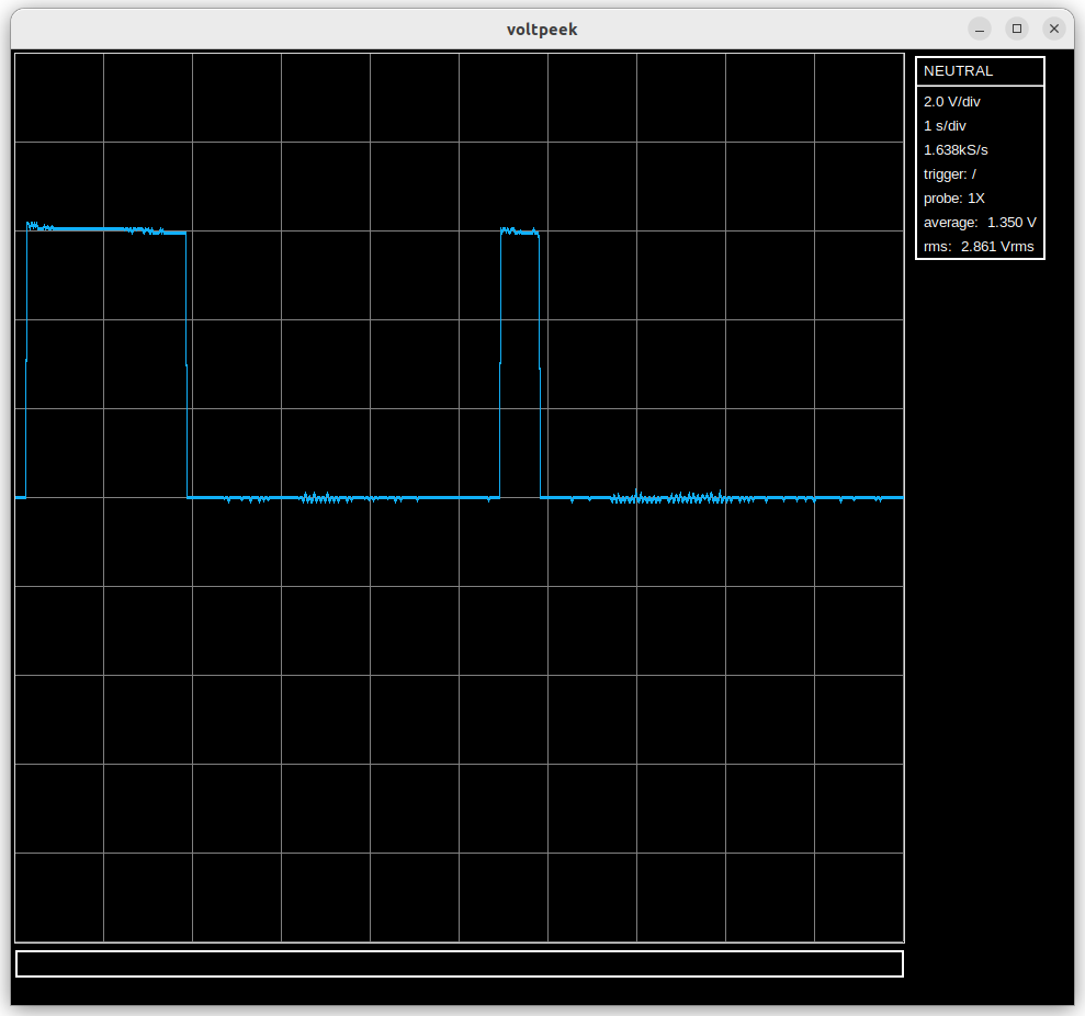

    Recently I have been doing a more serious attempt at implementing roll mode. This is a particularly import feature, as oscilloscopes of this caliber are often times used more like a data logger than an oscilloscope. Given this, it is important that the NS1 actually has data log capabilities (roll mode).
    On the firmware side, I'm just using a simple hardware timer. This may not be the best way to do it, but it is the easiest way to get the feature off the ground. It is the software where things get somewhat difficult. Definitely more difficult than the standard capture implementation.
    Currently the software periodically grabs roll mode data if roll mode is running, pipes the data through all its layers, and puts it on the display. The only difference from the standard capture mode is that the data does not have a fixed length, so it must be displayed accordingly. The display interpolation code is as follows:
    f = interp1d(np.arange(len(roll_buffer)) / roll_sample_rate, roll_buffer, kind='linear', fill_value=-100, bounds_error=False)
    resampled = f(np.arange(self._size) * time_per_pixel)
    self._roll_vectors[scope_index] = self._quantize_vertical(resampled, vert_setting)
    This nearly works, but there is a subtle problem with it; we are interpolating samples that are not new. That is, we are re-interpolating old samples that are not new on the particular display update. This leads to an interesting visual effect which is changing noise on the already captured signal. There is obviously no physical reason for this. It is an artifact of re-interpolating the old signal!
    The solution to this is a piecewise interpolation of the new data for the display. I'm working on this, but it is easier said than done.
    (Image of roll mode data. Ignore sample rate and NEUTRAL state. That is not showing correctly for roll mode.)

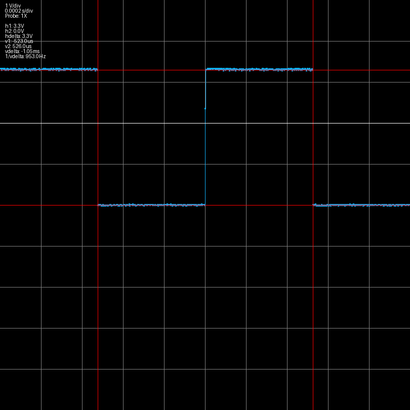

    Recently I have been working on a way that Voltpeek software can be used even if you don't have the NS1 hardware. I have written some new firmware which uses the internal ADC on the RPi Pico instead of the external ADC and front end utilized by the NS1. This creates a rudimentary oscilloscope with just a Pico required on the hardware side. However, this obviously comes with some extreme limitations. First, the internal ADC can only sample at 500kS/s - a very low sample rate for an oscilloscope. Second, there is no front end, so the input signal is limited to 0V-3.3V with no ranges. Also, 0V is not present when the input is floating as it should be. I have only implemented auto trigger at this point, but normal trigger may be coming in the future as well as some front end options.
    Below you can see a 100kHz square wave captured with this system:

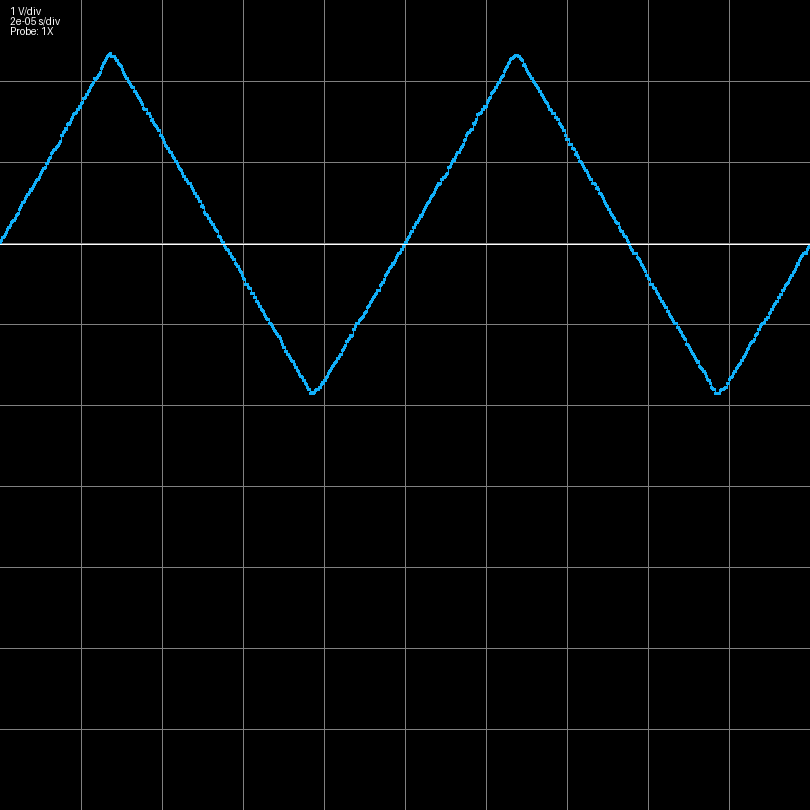

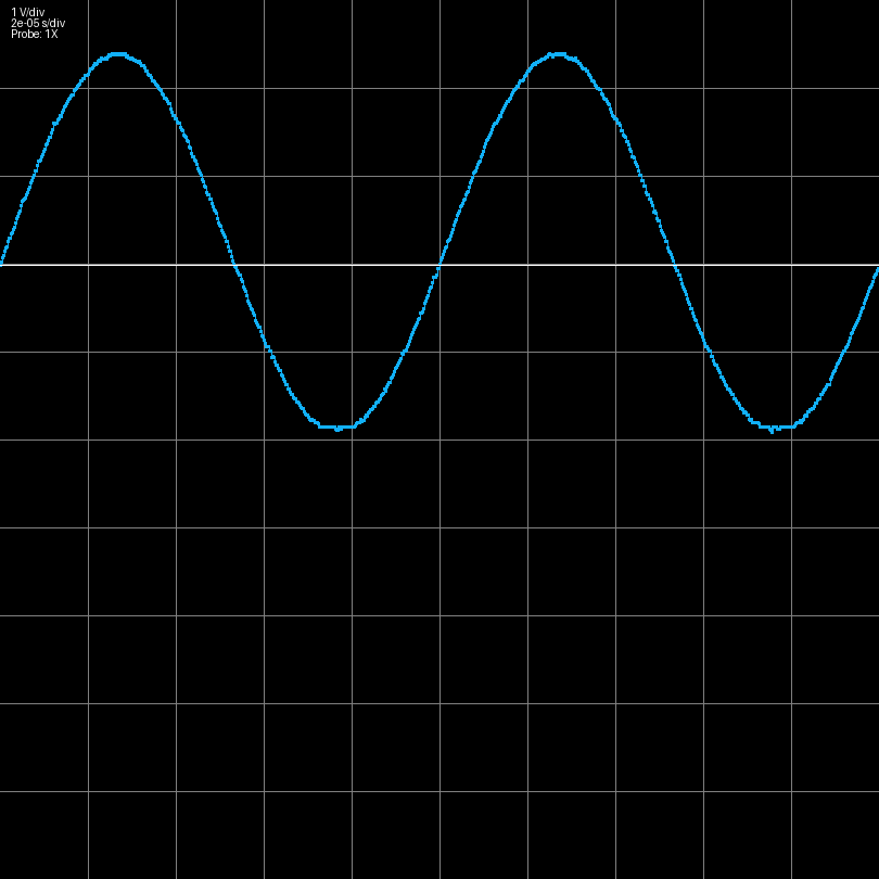

  • Distortion Improvement
    schuyler406/03/2025 at 21:32 0 comments
    I have discovered that adding a low pass filter in between the last op amp stage and the ADC like shown below improves the distortion performance of the scope.
    This has -3dB frequency of ~170MHz, so it does not lower the bandwidth of the scope. Rather, as mentioned in the datasheet of the ADC08100, the circuit absorbs energy coming out of the ADC input.
    Below are triangle waves measured using scopes without and with this modification.
    Without low pass filter:
    With low pass filter:
