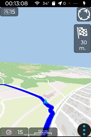

    Adding Pseudo3D to the navigation.
    It's incredible what you can do with an ESP32S3; I can't even imagine what it will be like with an ESP32P4

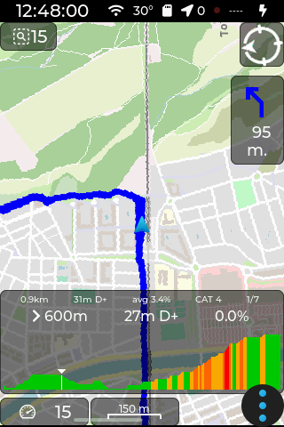

    New features are coming in the next release of IceNav.
    Find a route to a waypoint, climb analysis, and much more are on the way.
    Stay tunned

    On the other hand, I'm working on a turn-by-turn navigation system (still quite basic and rough). The idea is to use it for outdoor sports and similar activities. There's still a lot to fine-tune and countless tests to run, but it's starting to look promising.
