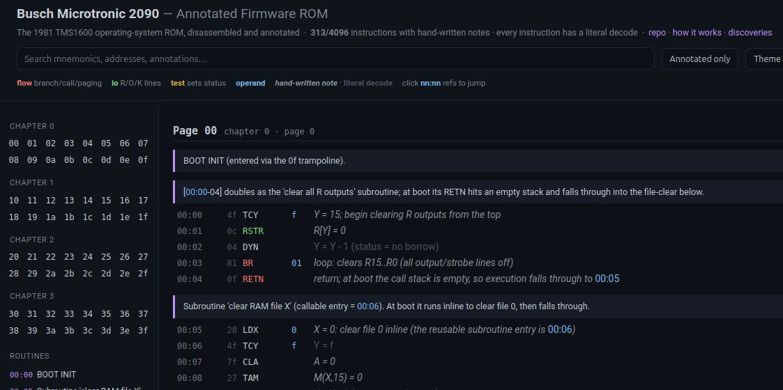

The Busch Microtronic Computer System is a West German 4bit educational computer system from 1981, programmable in an educational higher level machine language. Hex keypad and 7segment LED display. Its brain is a mask-programmed TMS1600 microcontroller, running the monitor programm and the interpreter for the virtual machine language. So far, the firmware and its sources have been lost to history. In this project, we are retrieving and reconstructing the Microtronic firmware from the TMS1600 using the little known "test mode", disassemble it, and create a commented ROM / firmware listing. It'll be awesome if, after 43 years, we could finally understand what makes a Microtronic "tick", and how!

Why do we care for the original Microtronic firmware? Two things: first, it will enable the fully authentic re-creation of the original, i.e., by using a TMS1600 software emulator running the original firmware ROM. So far, Microtronic emulators had to be implemented without the original firmware (see here, here and here for @Michael Wessel's various Arduino-based re-implementations in C). Secondly, the Microtronic firmware is an important historical artifact, and is the key to really understanding the system. Without it, the system and its inner workings remain shrouded in mystery - an unacceptable situation for every Microtronic enthusiast. So it would be absolutely awesome if, after being buried deeply and thoroughly in the bits of its mask-programmed TMS1600 for more than 43 years, we could finally excavate it to lift the veil of obfuscation - we would finally be able to understand what makes the Microtronic tick, and how!
Now, what's so difficult about retrieving the firmware from a TMS1600? Simply put, nobody knew how to do this - until recently! After all, a mask-programmed TMS1600 isn't something that you can simply put in an EPROM programmer to read out the firmware. @Michael Wessel knew about Sean Riddle's TMS1000-family chip decapping projects where he managed to retrieve the firmwares of certain TMS1000-family powered devices (such as Simon, TI calculators including the Little Professor and DataMan, and many more!) by reading the bit patterns directly from the die shots of the decapped chips! He even has a bit pattern to TMS HEX file converter program. Amazing! However, @Michael Wessel was hesitant to send one of his rare Microtronic TMS1600 chips to Sean, as decapping is obviously a destructive process, and few Microtronics are left these days.

really-final-microtronic-firmware-disassembled.txt
Really final Microtronic firmware disassembly extracted by Jason.
plain - 186.04 kB - 09/01/2024 at 18:47
Download
microtronic-81-47.bin.bin
Really final Microtronic firmware image extracted by Jason. BIN file.
octet-stream - 4.00 kB - 09/01/2024 at 18:41
Download
microtronic-81-47.hex
Really final Microtronic firmware image extracted by Jason. HEX file.
hex - 12.25 kB - 09/01/2024 at 18:38
Download
microtronic-81-47.txt
Really final Microtronic firmware image extracted by Jason. Arduino console file.
plain - 13.03 kB - 09/01/2024 at 18:36
Download
tms1100Dump-Microtronic.ino
Finaly Arduino dumping program.
ino - 8.10 kB - 08/21/2024 at 15:08
Download
