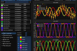

Hackaday.io Hackaday.io
Sign up Log in
Pico Pal GBC
Microcontroller based PCB fitted into a gameboy color shell to run a gameboy emulator
peter-khoulyPeter Khouly
Following Follow project
Liked Like project
Become a Hackaday.io member
Sign up with Github
Sign up with Twitter
OR
Forgot your password?
Just one more thing
Pick an awesome username
hackaday.io/
Pick a few interests
Choose more interests.
OK, I'm done! Skip
Join this project
4k views
0 comments
31 followers
27 likes
  • Description
  • Details
  • Files 0
  • Components 0
  • Logs 10
    • View all
  • Instructions 0
  • Discussion 0
View Gallery
4k
0
31
27
Team (1)
  • peter-khoulyPeter Khouly
Join this project's team
  • Homepage
hardware
ongoing project
emulation raspberry pi ESP32
Related lists
Video Games
Both retro and novelty. Games, consoles, controllers, gadgets.
General
Projects to come back to
Hackaday's Social Media Featured Projects
An easy-to-find list of the featured projects from Hackaday's Instagram.
This project is submitted for
  • Hackaday.com Tip Line
This project was created on 08/23/2024 and last updated 9 months ago.
Description
Initially I started with the RP2040 and that was a success, then in v3 I used an ESP32-S3 and a new display and additional circuits but that didn't go so well. Now after my summer internship, I've got a second wind with this project now that the RP2350 has been released. Crowd Supply Page here: https://www.crowdsupply.com/khouly-computers/pico-pal Homepage here: https://picopalgbc.wordpress.com Sign up for the mailing list to express your interest in buying a kit once I complete the project! https://picopalgbc.wordpress.com/interest/ You can find more posts on my reddit and YouTube: https://www.reddit.com/user/petek268/ https://www.youtube.com/@peterkhouly8033 Some software credits for the base software include: https://github.com/deltabeard/RP2040-GB https://github.com/YouMakeTech/Pico-GB
Project Logs
Collapse
  • Crowd Supply pre-launch page is up!
    Peter Khouly • 09/05/2025 at 15:56 • 0 comments
    Lots of progress since the last update that would make this log entry way too long.
    I think the best thing would be to check out the Crowd Supply Pre-Launch Page and my most recent Youtube Video
    As always, my blog stays updated with posts in case you would like to dig deeper
    https://picopalgbc.wordpress.com/
    Hope you guys like what you see!
  • Started Routing Rev E.
    Peter Khouly • 05/02/2025 at 15:29 • 0 comments
    Made some recent schematic updates to the new revision. Highlights include cleaner audio output, improved power efficiency, and support for an IMU to enable tap and double-tap gesture control. I'm also planning to implement automatic sleep and wake just like a phone.
    Started routing again yesterday and aiming to finish up this revision soon.
    Check out the blog for more.
    https://picopalgbc.wordpress.com/
  • New blog posts
    Peter Khouly • 01/05/2025 at 21:52 • 0 comments
    4 new blog posts relating to Link port/IR, cart reading (which I couldn't add), the esp32 implementation for bluetooth audio and controller support, and a software update improving the colors and adding the rtc functionality.
    https://picopalgbc.wordpress.com/
  • Winter Update
    Peter Khouly • 12/29/2024 at 01:42 • 0 comments
    After getting the new boards in 2 weeks ago and working on some of the software I have an update for everyone with lots of posts and documentation on the blog along with some posts on reddit.
    Let me know what you think!
    https://picopalgbc.wordpress.com/2024/12/28/50-winter-update/
  • PCBs Ordered!
    Peter Khouly • 12/04/2024 at 01:51 • 0 comments
    Finished designing the PCB and got 5 ordered which I am hoping to get in the next 2 weeks. As for now until next wednesday I will be focusing on my school and then after start writing code.
    https://picopalgbc.wordpress.com/2024/12/02/36-routing-day-11-pcb-done/
  • Schematics Done! Onto Routing the PCB
    Peter Khouly • 11/11/2024 at 19:38 • 0 comments
    Check out the blog post here
    https://picopalgbc.wordpress.com/2024/11/11/30-schematic-done/
  • New blogs with Stereo & BT Audio, and RTC
    Peter Khouly • 09/29/2024 at 18:55 • 0 comments
    New blog posts on the site along with some cool features added in such as Stereo Audio, support for a bluetooth audio module, support for dual speakers, and a real time clock.
    Hoping for this to be my last GPIO pin revision and wrap up the schematic!
    https://picopalgbc.wordpress.com/2024/09/28/20-gpio-rev-c/
  • 2 new blogs up
    Peter Khouly • 09/12/2024 at 23:18 • 0 comments
    Replaced the Audio Pot with a navigation switch/rocker and updated the GPIO pin out.
    Let me know what you think!
    https://picopalgbc.wordpress.com/
  • 3 new blogs up
    Peter Khouly • 09/10/2024 at 14:44 • 0 comments
    Clarifying some timing with the IO expander along with 2 relating to the DVI over HDMI implementation.
    More coming soon such as the revised GPIO pin out and part sourcing.
  • Blog site up with 6 new posts
    Peter Khouly • 08/29/2024 at 19:51 • 0 comments
    https://picopalgbc.wordpress.com/
    I think documenting this project is pretty fun and keeps everything organized and I wanted to share this publicly in the case it helps anyone or you're just curious of whats going on.
View all 10 project logs
Log In/Sign up to comment
Become a Hackaday.io Member
Sign up with Github
Sign up with X
OR
Universal logging platform for many infrafaces with WiFi and Bluetooth
Project Owner Contributor
uLogger UART/SPI/CAN/I2C multivoltage converter
rafal-woloszynRafal Woloszyn
The 2017 Hackaday Prize
FREE and Open Source, Arduino Due based Telescope Control GOTO
Project Owner Contributor
rDUINOScope Boiana
dessislav-gouzgounovDessislav Gouzgounov
Microcontroller non-intrusive realtime data visualizer
Project Owner Contributor
MCUViewer
piotr-wasilewskiPiotr Wasilewski
The 2016 Hackaday Prize
Neuromechanical Holoportation Drones
Project Owner Contributor
Astral AR
leah-lasallaLeah LaSalla
Going up?
© 2026 Hackaday
Yes, delete it Cancel
You are about to report the project "Pico Pal GBC", please tell us the reason.
Send message
Remove Member
